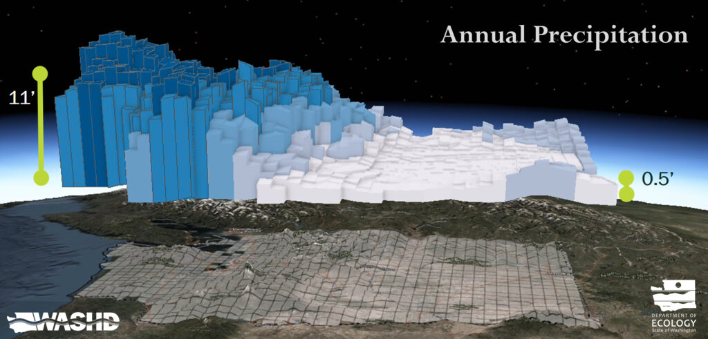

Washington State has a long history of mapping water bodies, possibly because of high annual precipitation. Portions of the Olympic Peninsula receive up to 13 feet of rain annually. This graphic is a 3D representation of annual precipitation over Washington State. As you can see, eastern Washington receives much less rainfall than the western part of the state.

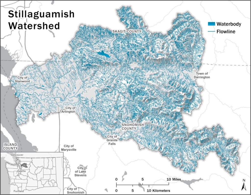

The Stillaguamish watershed in the Puget Sound basin was selected for the pilot based on available lidar data, variety of topography, land cover, varying jurisdictions, and willing local participation. Newly created steering and technical committees, made up of representatives from stakeholder organizations, provided oversight for the project. These committees met monthly throughout the project. Quarterly meetings included the full statewide stakeholder community (anyone interested in hydrography). Keeping the stakeholder community informed on the progress of the project was necessary to provide updates and solicit feedback.
Location of the Stillaguamish Watershed Used for the Pilot Project. Click on the image to explore a story map about the project.

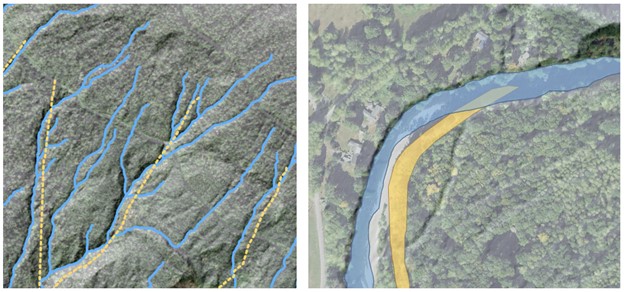

The WASHD team compared the results from NV5 with any data that seemed relevant. This included working closely with local jurisdictions, using aerial imagery, hillshading images, and creating EDH data using traditional flow accumulation techniques. In total, over 7,000 miles of EDH lines were evaluated and classified for accuracy. Through analysis comparing the new EDH with available data, less than 2 percent of the EDH segments were determined to have location errors. Another 2 percent were questionable and could not be resolved without a field visit. Overall, the accuracy of the new EDH was impressive and showed promise as a method to update the NHD.
When comparing the length of EDH flowlines to the original NHD flowlines, the total number of miles of flowlines was almost double. This increase is explained by the increase in new lines as well as added mapping detail provided by the new process. When comparing streams mapped in the NHD and then EDH, the length of the same streams increased by 2–18 percent. These differences can be seen in our story map created for the pilot project.
Above are examples of EDH data, including more detailed headwaters (left) and farther extension of stream/river polygon length in comparison to the NHD (right). Yellow represents the NHD and blue represents EDH.

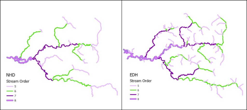

The increased number of flowlines impacted stream order across the basin. Reach order increased 25–120 percent overall. If applications are set up to use stream order, the output of those applications will be impacted by 3DHP and need to be reevaluated.

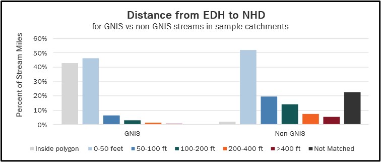

Results of an Analysis of GNIS and Non-GNIS EDH Stream Distances from the Original NHD
The GNIS streams tended to be relatively accurate in the NHD, and therefore were close in distance to the new EDH. Over 40 percent of the stream length was within 50 feet, and 85 percent of the total stream length was within 100 feet. While the accuracy of stream length was improved, having 15 percent more than 100 feet away is still important; however, it’s not as significant as the smaller unnamed streams. The streams without a GNIS name had 50 percent of their length within 50 feet, but 30 percent was greater than 100 feet from the EDH. The GNIS streams are likely more accurate in the NHD because larger streams are readily viewable in aerial images. They are also more typically used in planning, research, management, and so forth and are therefore of more interest to have correct. Many of the non-GNIS streams are in forested areas with canopy cover, making them difficult to view in aerial images. These seem to be the scenarios that really benefit from a lidar model approach to mapping hydrography.

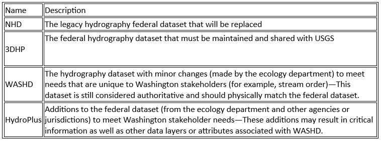

For the purposes of this project, distinct datasets for which the WASHD program is responsible have been defined and are detailed below. This section will introduce and explain the concept of an integrated set of data and information for hydrography.

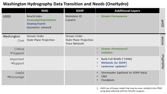

Together, these datasets create what the program will refer to as OneHydro, the data ecosystem for hydrography analysis and mapping. The final report provides more details and examples of the data gaps identified in the table below.
The table above depicts the OneHydro concept as it relates to changes and needs created by the transition from the NHD to the 3DHP, as well as data gaps identified by stakeholder needs.
Changes from the NHD result in the loss of the following data features:
Geometric networks are considered a change only because they are not supported in Esri’s ArcGIS Pro software. Washington State has historically added stream order to each reach and reprojected the state dataset to State Plane South coordinates. After processing, the dataset has been made available to stakeholders and referred to as the WASHD version of the NHD.
The 3DHP data schema will be replacing reach codes with a main stem ID, which will be a unique identifier for the entire stream length. A new feature code to identify terrain breaches over roads can be used to locate culverts and is a new addition to the dataset. Washington State will be able to calculate stream order for reaches and reproject the dataset to State Plane South coordinates as was done for the NHD. In place of a geometric network, a trace network can be created to provide similar functionality of locating upstream and downstream reaches.
HydroPlus Data Layers
Stakeholders identified several important data attributes and layers. These layers, shown in the table above, are important and useful, but they are difficult to create and are outside the scope of the WASHD program. While the WASHD program recognizes the significance of these layers as part of a complete hydrography data ecosystem, the program can only support or encourage their creation. The long-term goal is the creation and integration of these data layers into the 3DHP and WASHD for a more complete dataset with improved analysis capabilities. The WASHD program intends to support the integration of the HydroPlus data layers to maximize the usefulness of the data for stakeholders.
