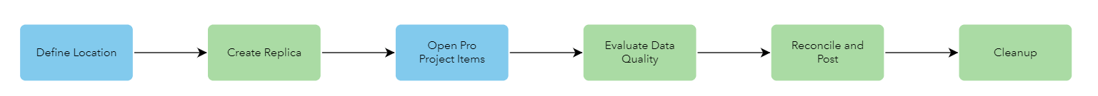

Create a replica to edit layers offline
We are excited to introduce new, out-of-the-box features to edit layers in disconnected and limited-connectivity environments. In this latest version, we’ve added two new step templates and enhanced capabilities with the Open Pro Project Items and Cleanup steps to allow you to work seamlessly offline.
Start your offline editing workflow by creating a replica from a specified data source with the Create Replica step. With this new step, you can choose which layers to include in the replica, define the extent of the location where data will be edited using the location defined in the job or an ArcGIS Arcade expression, and configure additional parameters from the Feature Service’s Create Replica operation. The step automatically creates a branch version of the data source and stores it in a shared file location that can be accessed locally by members in your organization.
The replica can then be opened in an ArcGIS Pro project using the Open Pro Project Items step. The Open Pro Project Items step has been enhanced to repoint layers to the replica and can be configured to send and receive replica changes to the shared file location when the step is started, paused, or completed.
Once edits have been made, changes can be applied from the branch version to the default version using the Reconcile and Post step. The Reconcile and Post step can evaluate all or specified data sources configured with the workflow diagram, detect conflicts by object or by attribute between the branch version and the default version, and reconcile and post based on set conditions to ensure quality control before merging changes. While this example of the Reconcile and Post step is used in an offline editing workflow, this step can be used to retrieve and post edits in any version management workflow.
Finally, the Cleanup step features two new options to unregister replicas with the job and remove all replica files from the shared file location.
![A sample offline editing workflow diagram configured with the define location, create replica, open pro project items, evaluate data quality, reconcile and post, and cleanup steps. A sample offline editing workflow diagram configured with the define location, create replica, open pro project items, evaluate data quality, reconcile and post, and cleanup steps.](https://www.esri.com/arcgis-blog/wp-content/uploads/2023/11/OfflineEditingWorkflow.png)

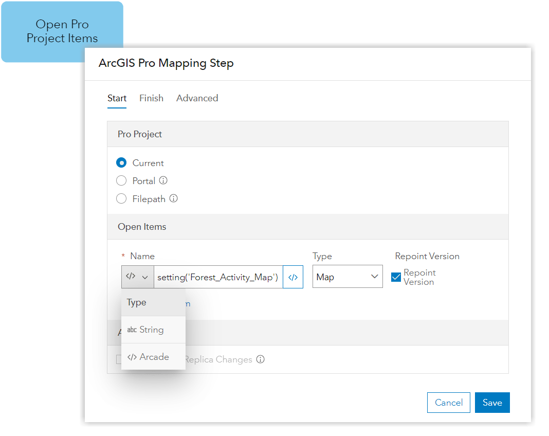

Open ArcGIS Pro projects using an ArcGIS Arcade expression
In addition to synchronizing replica changes with the Open Pro Project Items step, you now have the option to use a string value or an ArcGIS Arcade expression to reference the name of the project item. With Arcade expressions, you can use a dynamic value, allowing you to reference items from an extended property or a user-defined setting.

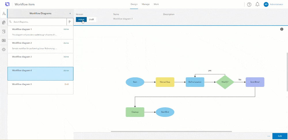

Draft workflow diagrams
The Diagrams tab now offers drafting capabilities for your workflow diagrams. When changes are made, you can save edits in a draft, compare changes between the active and draft versions, or discard the draft. Draft workflow diagrams allow you to edit, update, and re-configure a diagram without affecting existing jobs.

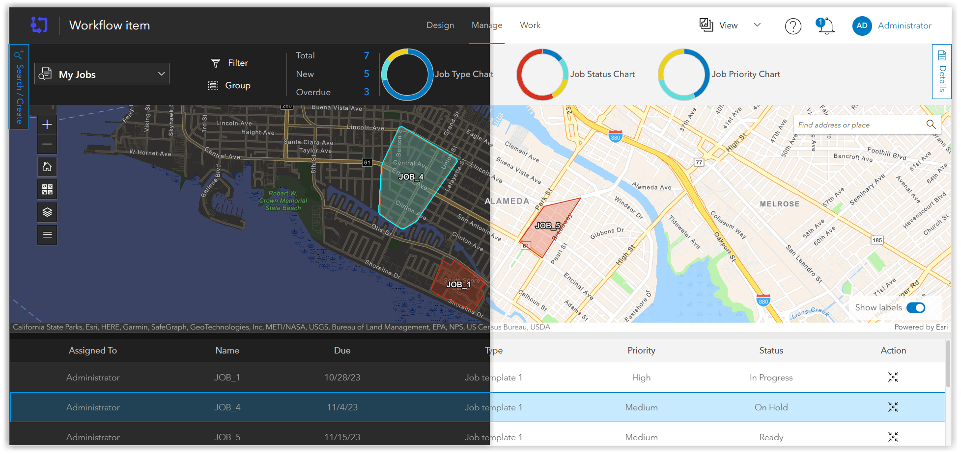

View the web app in dark mode
Ready to come to the dark side? You can now use your browser’s theme settings to view the Workflow Manager web app in dark mode.

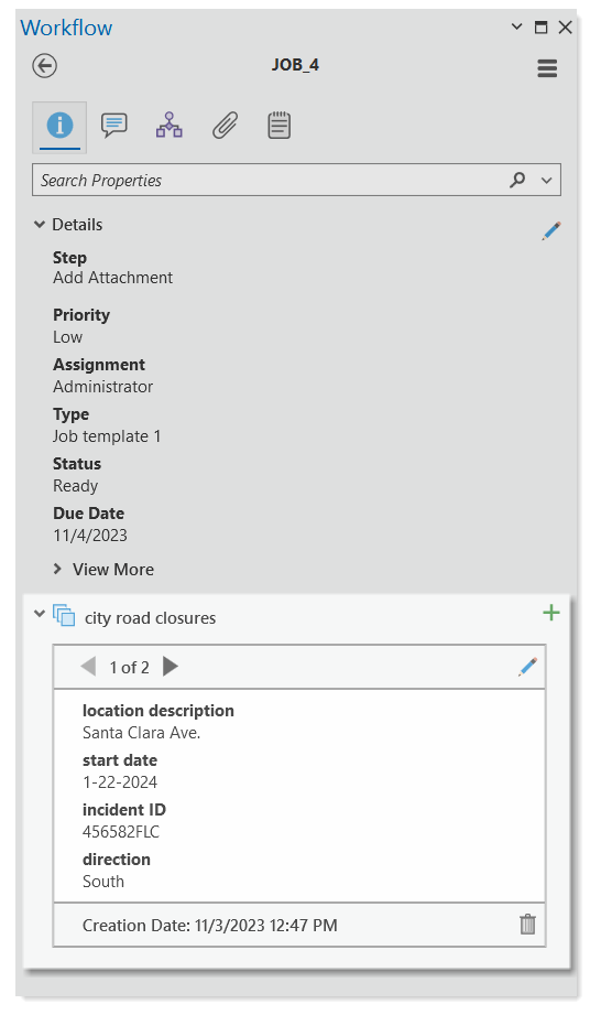

View and manage 1-M job properties
If you have a job configured with one-to-many job properties, the properties tab now provides an expandable drop-down to view, edit, and delete your one-to-many job properties through the workflow pane.

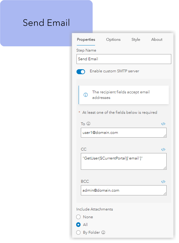

Configure custom SMTP server settings
If you feel limited by the ArcGIS Online email notification service, you now have the option to configure custom SMTP server settings for your organization. Custom SMTP server settings enable new capabilities with the Send Email step, allowing you to include attachments, use email addresses instead of a username or group ID, enables the CC and BCC textboxes, and allows you to send emails through your organization’s domain.
