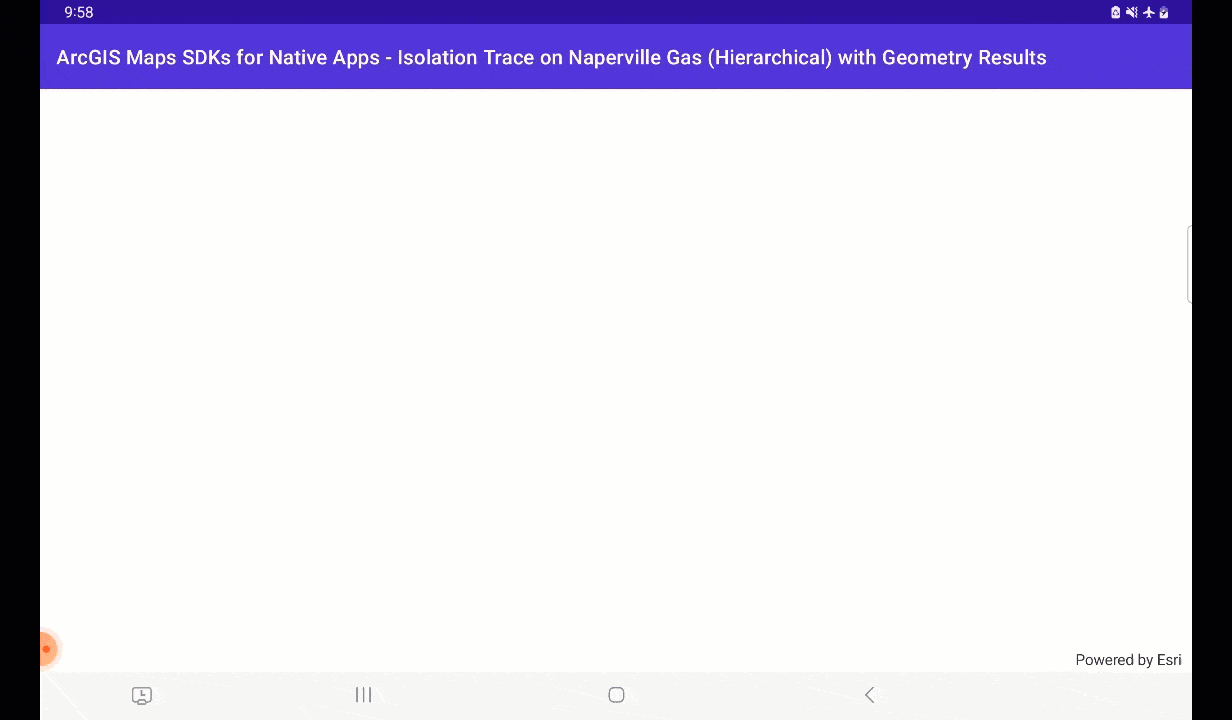

Isolation traces allow you to identify and respond to the impact of an equipment failure in a network area. For gas and water utilities, this may be finding the minimum set of operable features required to isolate a leak. For electric utilities, this may be identifying the residential customers impacted by an electrical fault. Download the perform valve isolation trace sample to see how trace locations, trace filters, and the isolation trace type are used to accomplish these workflows.
![](https://www.esri.com/arcgis-blog/wp-content/uploads/2023/07/IsolationTraceWithGeometry.gif)

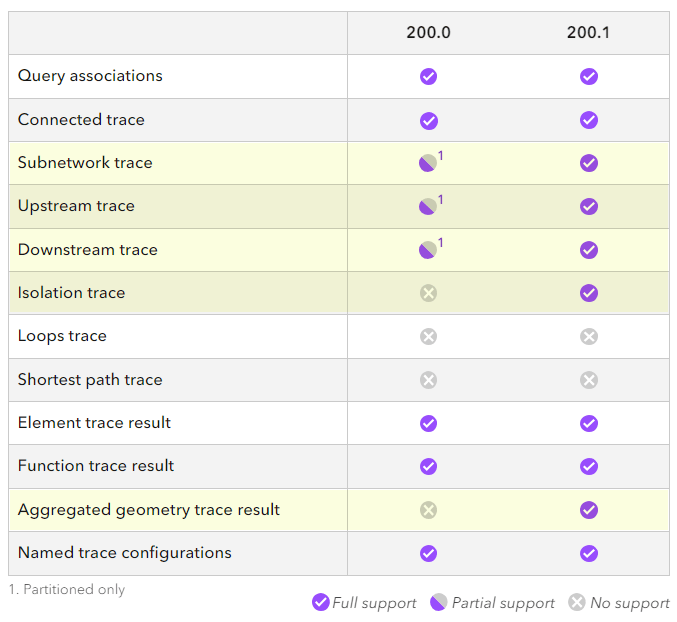

The following table summarizes the supported functionalities for recent releases of the Native SDKs. Note that in 200.0, this support was limited to stand-alone mobile geodatabases. And in 200.1, this support includes sync-enabled mobile geodatabases generated with topology tables. Read part 2 of the series to learn how you can download and replace a mobile geodatabase with a traceable utility network.
![A table that highlights additional tracing capabilities for utility networks with topology in a stand-alone or sync-enabled mobile geodatabase. A table that highlights additional tracing capabilities for utility networks with topology in a stand-alone or sync-enabled mobile geodatabase.](https://www.esri.com/arcgis-blog/wp-content/uploads/2023/07/200_1_Enhancements.png)
As you can see, in this release of the ArcGIS Maps SDKs for Native Apps, we are closer to supporting the same tracing and analysis capabilities between ArcGIS Pro and mobile applications for the ArcGIS Utility Network. With every release, we continue to grow the list of supported features, allowing the applications you develop to support even more interesting workflows.
