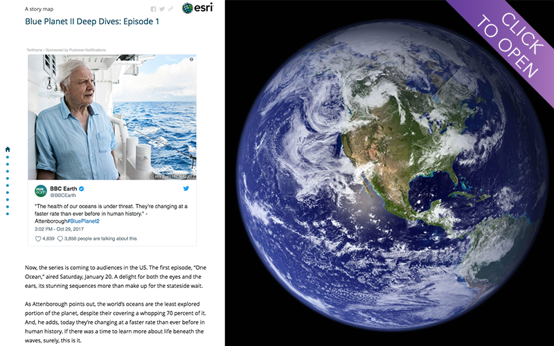

Want to see what this looks like before you try it? Check out these Blue Planet II episode guides from the Story Maps team for lots of embedded Twitter content.

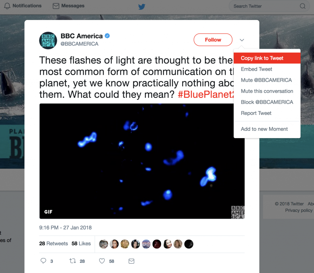

Once you’ve added in the generic iframe code, be sure to update the URL so that it points to the tweet you want to highlight. Simply grab the link for the tweet from the top of your browser or Twitter’s additional options menu.
Then go ahead and paste this at the end of the Twitframe snippet, replacing the link that follows /show?url= (Be careful not to paste over the closing set of quotes that comes right before </iframe>.)
