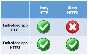

Another possible reason for content not appearing is that your story is trying to access mixed content. This happens when you connect to your story over an encrypted connection (https) but some of its components, like images or other web files, are being accessed over an unencrypted connection (http). Browsers restrict this for security reasons (read more here).
The simplest way to fix this is usually to make sure that all URLs you use to embed web pages, apps, story maps, images, or videos in your story use https. If you do this your story will work whether it is accessed over http or https. ArcGIS Online supports https and http, so it’s good practice to always use an https URL when embedding an ArcGIS configurable app or story map.
In fact, if your ArcGIS Online administrator has enabled https-only on your organization, or if you are creating stories on an instance of Portal for ArcGIS (which requires https), then all URLs for apps, web pages, images, videos, etc. that you add to your story must use and support https.
Some websites, however, may not support https, so this may affect their visibility in your story. If you find a site like this it will only appear if your story is accessed over http. This may limit your options so often it’s best to just link to a site like this so readers can open it in another browser tab.
