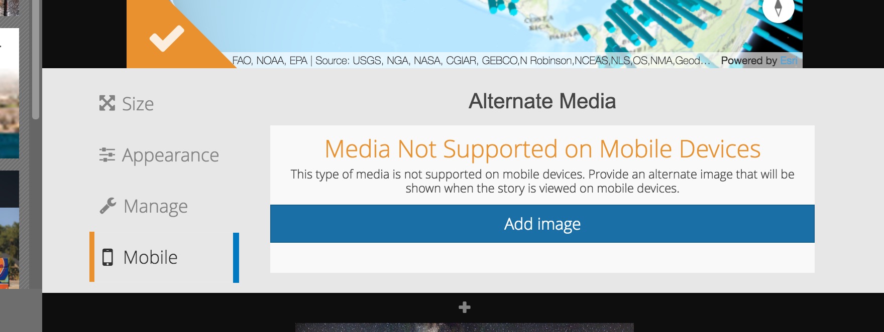

When you add media to a Cascade story you may see an orange warning indicator that lets you know you should strongly consider adding an alternate image for that piece of media.
An orange stripe appears on the left edge of the media itself as well as sections in the story over. If you don’t have any errors in your story, you will also see an orange warning reported by the health check in the builder toolbar.
Background videos (that is, a video on the cover or in an immersive section) and web scenes aren’t currently supported on mobile devices. It’s recommended that you always provide an alternate image for these types of media.

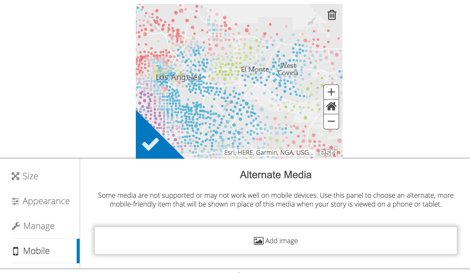

Adding a map anywhere in the story will not trigger a warning; however, you still can provide alternate images for maps, if needed. For example, some complex maps may not perform well on slow data connections. Also, maps with lots of vector tile layers don’t perform well on mobile devices. In these cases, you may want to consider setting an alternate image on the Mobile tab, even though there is no warning. Test your story on mobile devices to see whether you should provide alternate images for your maps.
Pro Tip! If you have interaction disabled on a map, there’s no reason not to add an alternate image for that map since readers can’t interact with it anyway. In these situations you can optimize the mobile story so that it only needs to load images instead of an interactive map.
