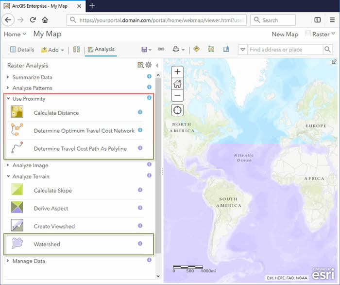

5. Raster Analysis in the Map Viewer
Some new tools are available for performing raster analysis in the Map Viewer when you are connected to an updated version of the Portal for ArcGIS in ArcGIS Enterprise.
There is a new toolset for proximity (distance) analysis, with the following three tools:
- Calculate Distance
- Determine Optimum Travel Cost Network
- Determine Travel Cost Path As Polyline
In the Analyze Terrain toolset, there is a new Watershed tool.
