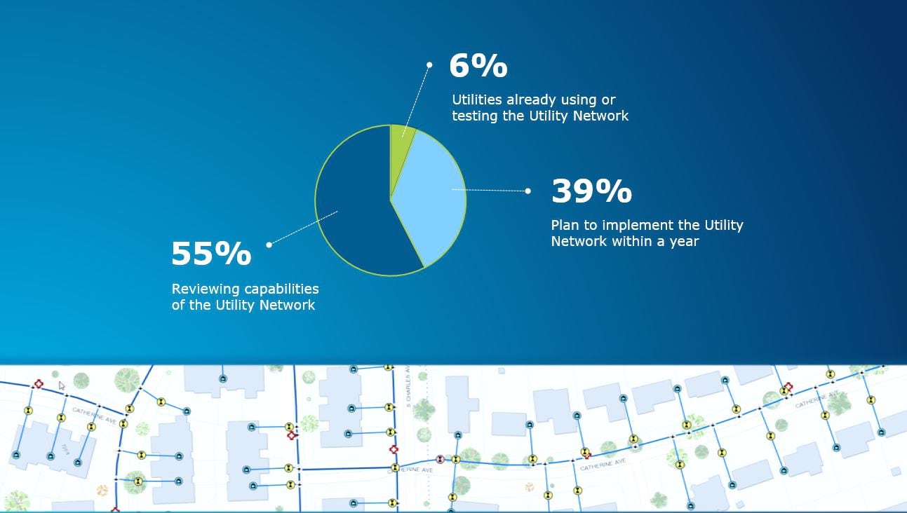

The utility network implemented with the ArcGIS Utility Network Management extension creates a new data type in ArcGIS. This data type provides a robust foundation for scalable modeling of all utility assets. It has been designed to handle a large volume of data. However, careful consideration should be done to appropriately scale resources.
The utility network is services based, but data still resides in a relational database. Databases that support the utility network include SQL Server, Oracle, PostgreSQL, and SAP HANA. For more information, please reference the system requirements.
![](https://www.esri.com/arcgis-blog/wp-content/uploads/2019/11/Chart.jpg)
