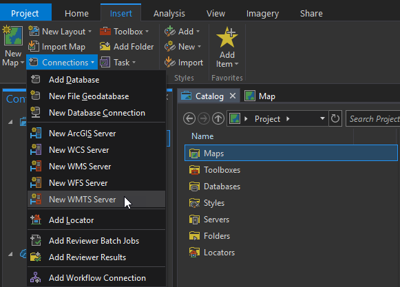

- From the main tab options, go to ‘Insert’ -> ‘Connections’ and then select ‘New WMTS Server’

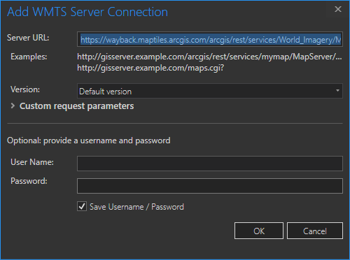

- In the ‘Add WMTS Server Connection’ dialog, enter the following server URL and click OK.
- https://wayback.maptiles.arcgis.com/arcgis/rest/services/World_Imagery/MapServer/WMTS/1.0.0/WMTSCapabilities.xml

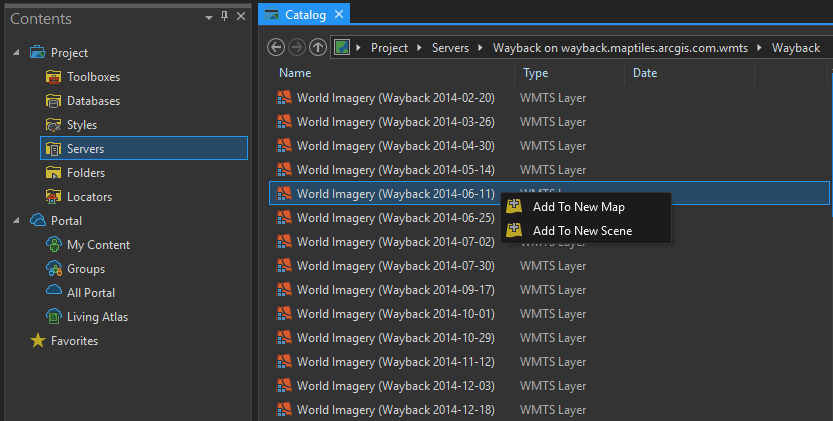

- In your Catalog view, click on ‘Servers’ and you should see the Wayback server listed.
- Double click on the Wayback server twice to open and view the full list of available layers.
- Right click on a layer and choose whether you would like to add that layer to a new or existing map.

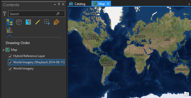

- The selected version of World Imagery is now loaded and ready for use. Additional layers can be added to the same map as needed.
