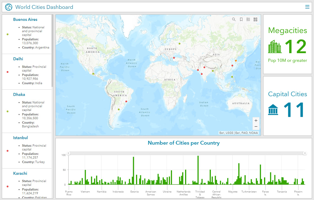

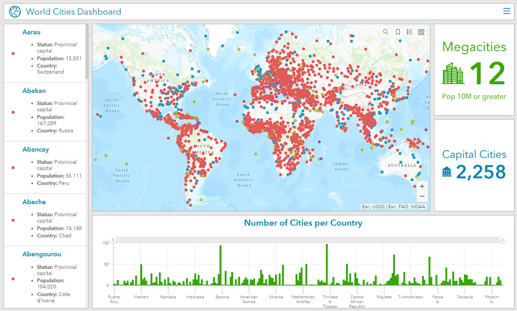

Let’s explore some examples that illustrate the power of URL parameters in dashboards. Below is a dashboard that shows world cities, their country location, population, and capital city status. When the map extent changes, the two indicators and the list elements are filtered based on the updated spatial extent. The following image shows the default dashboard display:
The dashboard’s default URL is:
https://www.arcgis.com/apps/opsdashboard/index.html#/558f846d67f749afa7f9f9080e31786e
This dashboard has been configured with additional properties (that is, URL parameters), so when it opens, its display will change based on the information passed in. For example, to make the dashboard only display megacities (e.g., cities with a population of 10 million or greater) a parameter can be added to the URL as follows:
https://www.arcgis.com/apps/opsdashboard/index.html#/558f846d67f749afa7f9f9080e31786e?pop=10000000
Here’s what the dashboard looks like with this URL parameter:
Note the syntax “?pop=10000000” means the following:

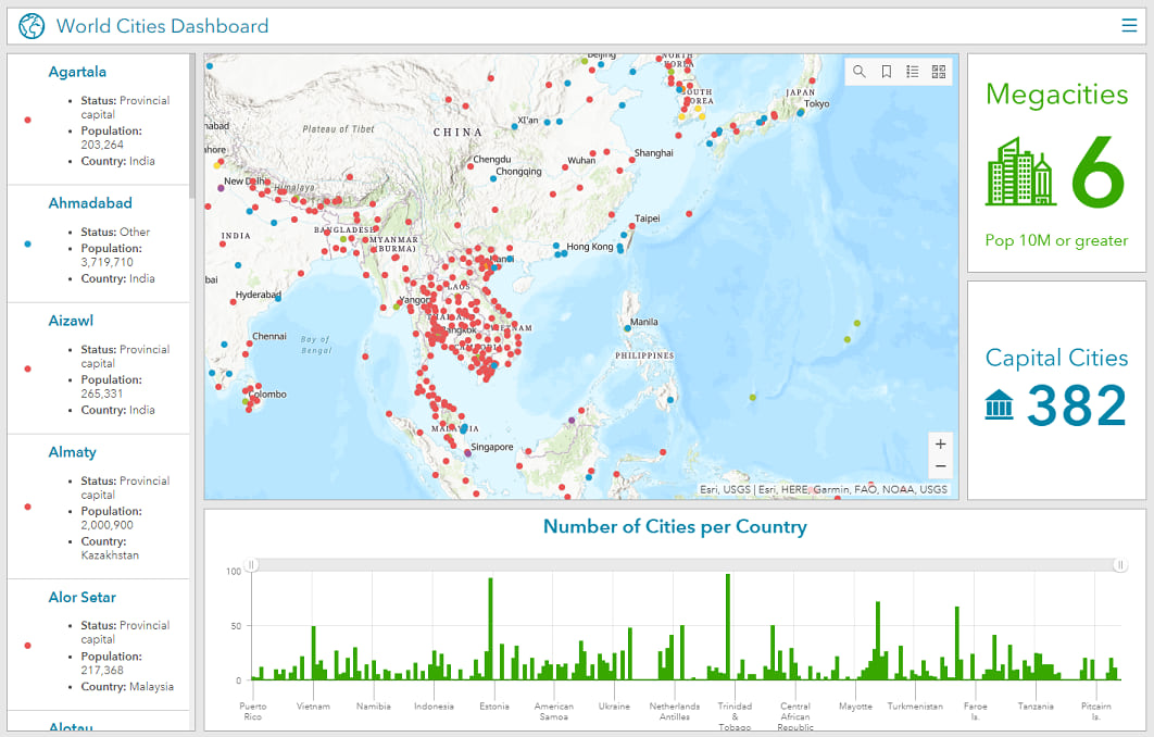

Let’s look at how a geometry URL parameter can be used. Geometry parameters can be configured in two ways: as a point location or as a spatial extent. Below, a spatial extent that defines the southeast Asia region is added to the URL:
In this case, the URL syntax “?extent=68.1,-11.8,164.1,46.5” means the following:
- ? → Append parameter to the URL
- extent → The name given to the parameter
- 68.1 → Left x value
- -11.8 → Left y value
- 164.1 → Right x value
- 46.5 → Right y value
Since the URL parameter defined a new spatial extent for the map element, filters are also applied to the two indicator and list elements.

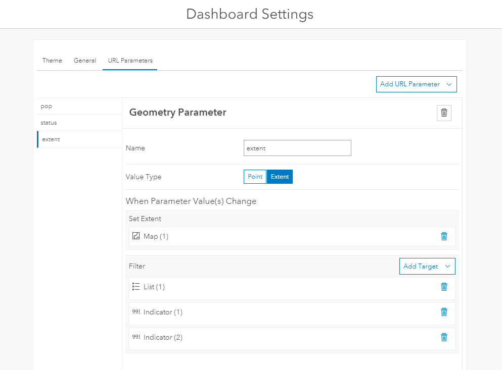

How to configure URL parameters
URL parameters are added to a dashboard when it’s being authored. A new URL Parameters tab has been added to the Dashboard Settings dialog. On this tab, you select the type of parameter you want to add and then you configure its properties. This process is similar to the way you configure other dashboard actions. The image below shows the URL parameter configuration settings used in the geometry example above.
