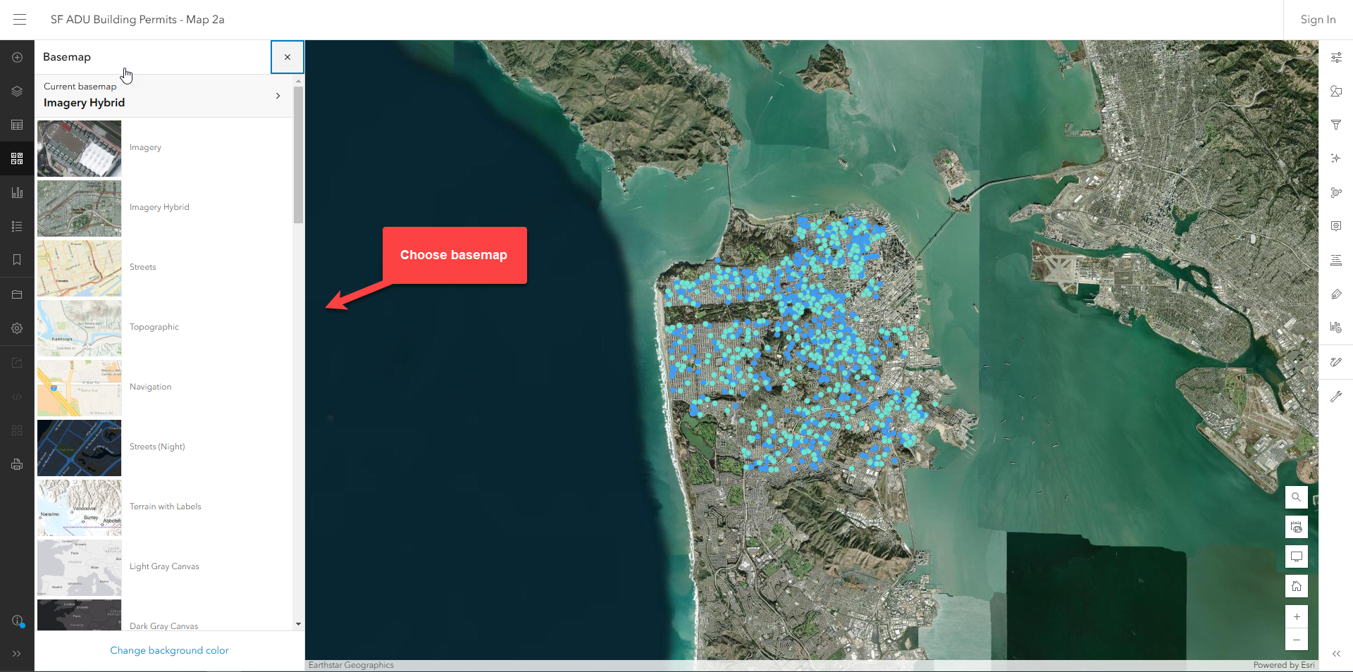

1. Choose Your Basemap: Open the web map in Map Viewer and start by selecting a basemap that provides the necessary geographic context for your data. In this case, World Imagery provides context to proposed building locations.
choose basemap

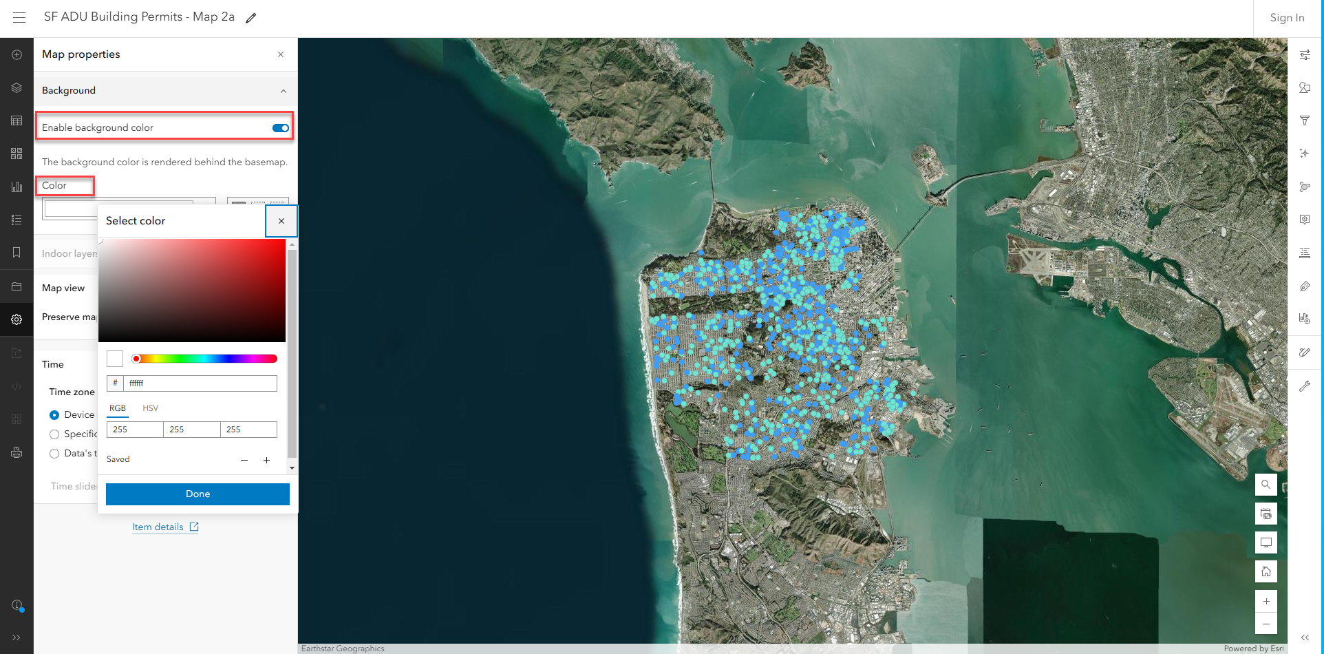

2. Apply a Background Color: To match the overall look and feel of your dashboard, apply a background color. From the map properties option in the Contents toolbar, click on Enable background color to select a color that complements the theme. For this map, set the background color to #9e9d9d.
Note: You will not notice any changes until the next step.
add background color to basemaps

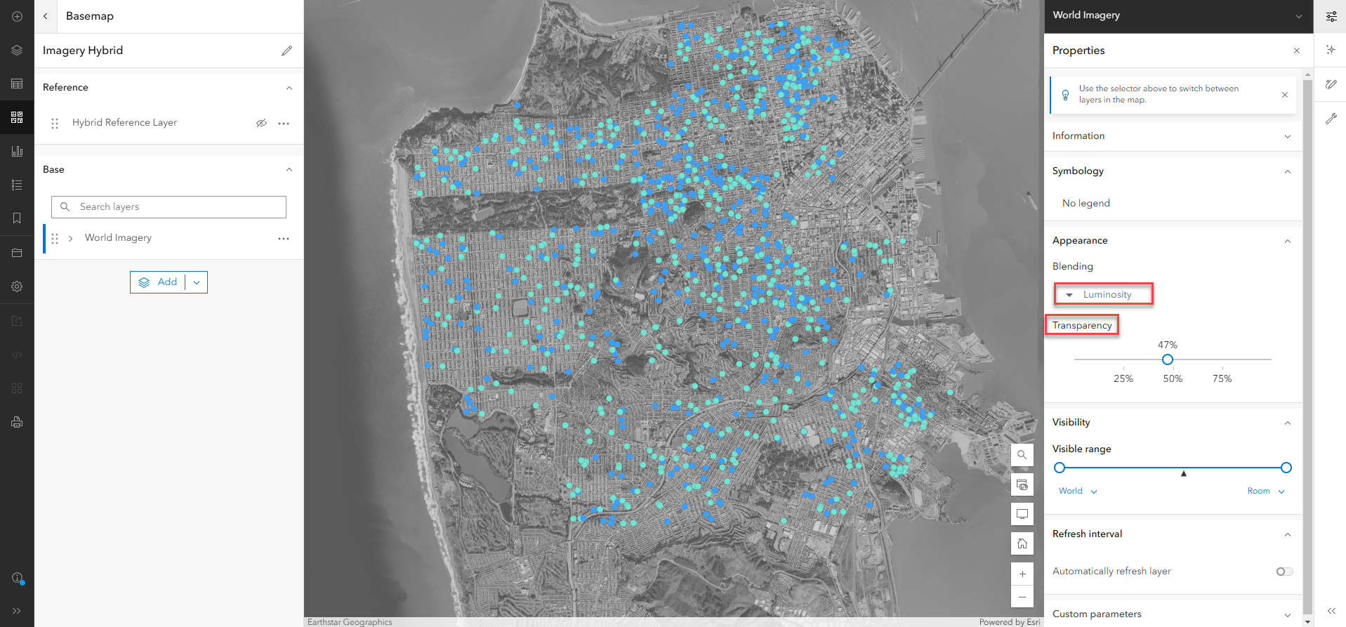

3. Use blending and effects: Combine blend modes with effects to fine-tune the appearance of your map. Adjusting the transparency can help you control the visibility of underlying layers, while blend modes give you additional control over how the layers’ colors and textures are displayed. For example, in this permits web map, applying luminosity blending helps the data to stand out by “muting” the colors in the basemap.

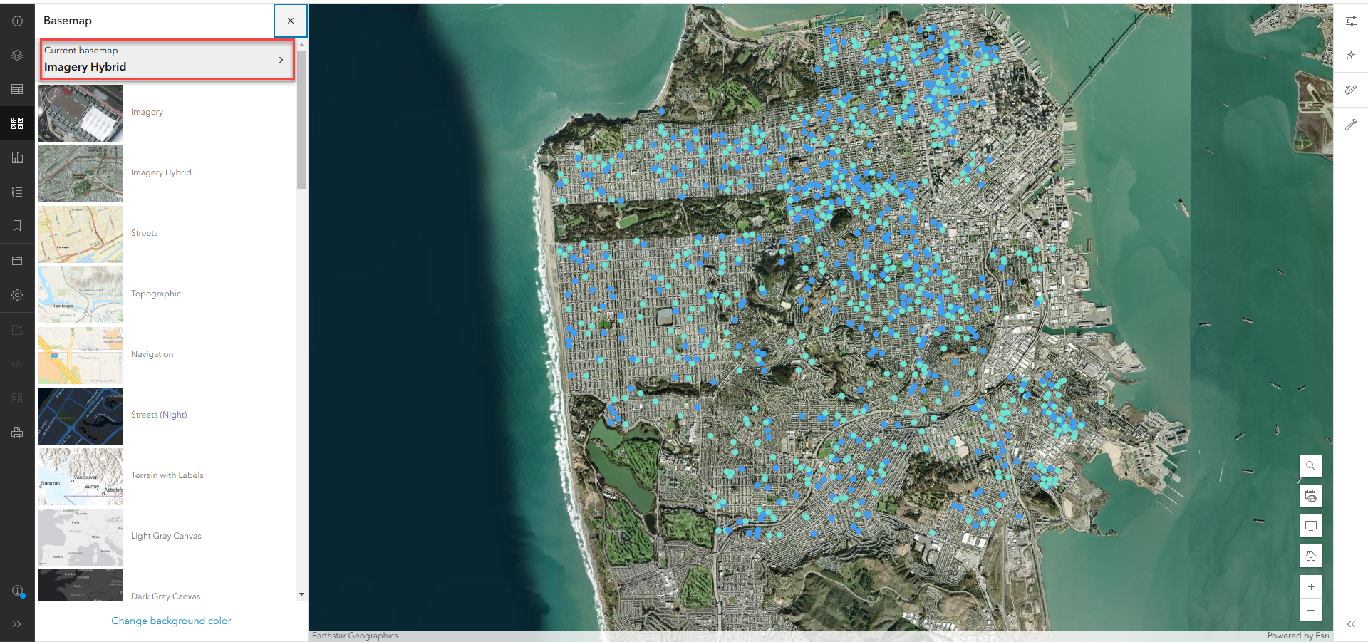

  • To apply this effect, click on Current basemap in the Basemap pane in the Contents toolbar.
use blending and effects

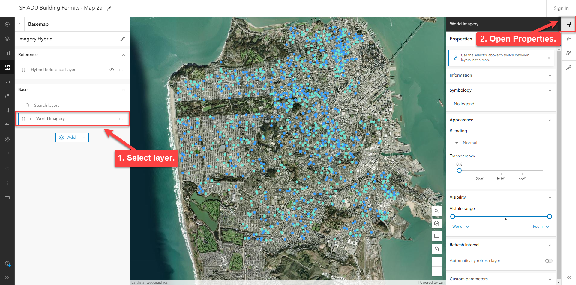

  • Select the layer and click on properties.
select the layer and open properties
  • Under Appearance, in the Blending drop-down, select Luminosity.
  • Adjust Transparency as needed to improve the overall aesthetic.
add effects

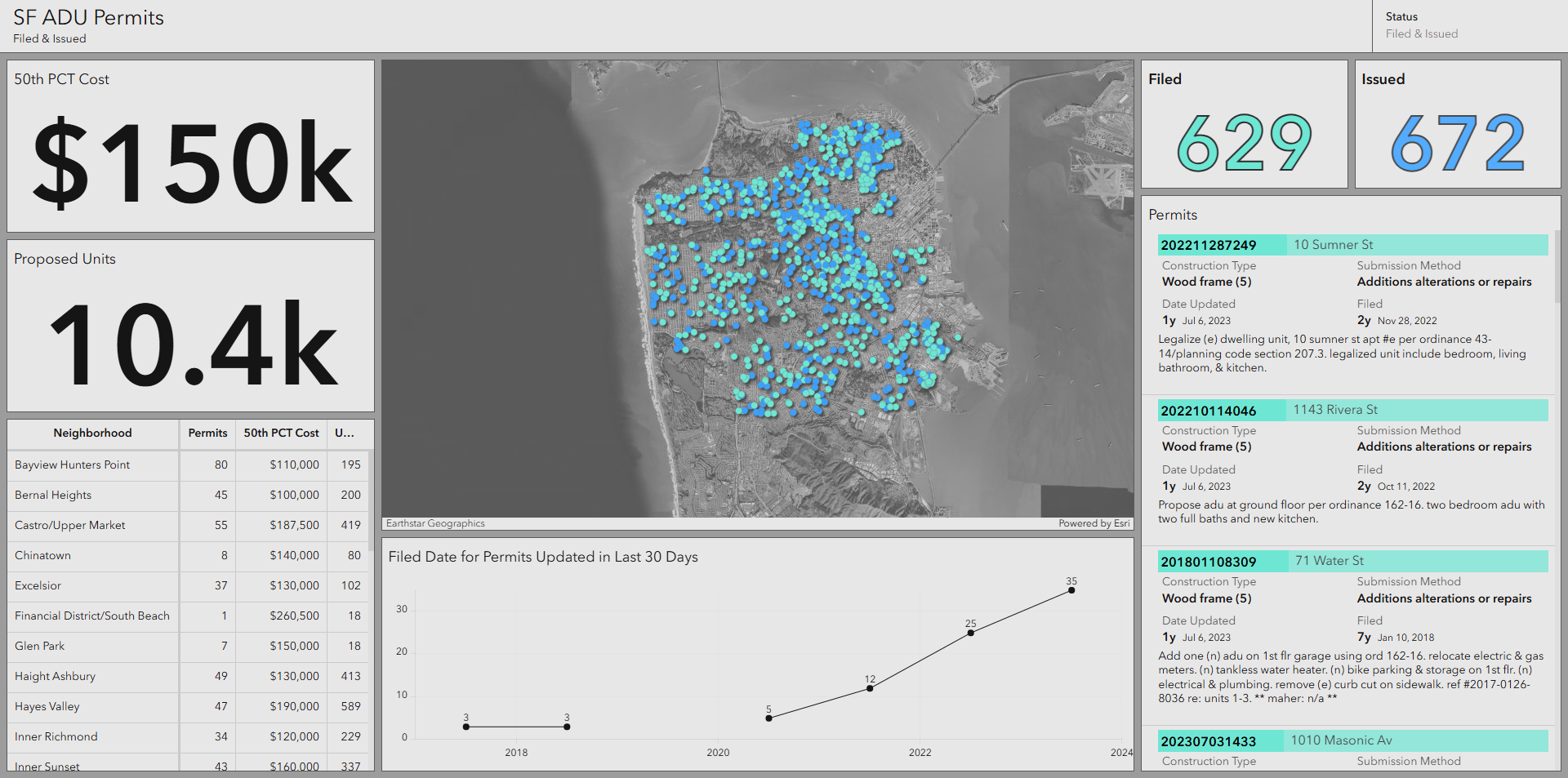

The result is a map that aligns with theme of the dashboard and accentuates the data points, all while providing important satellite imagery context for reviewing the ADU construction sites.
the resulting map in the dashboard

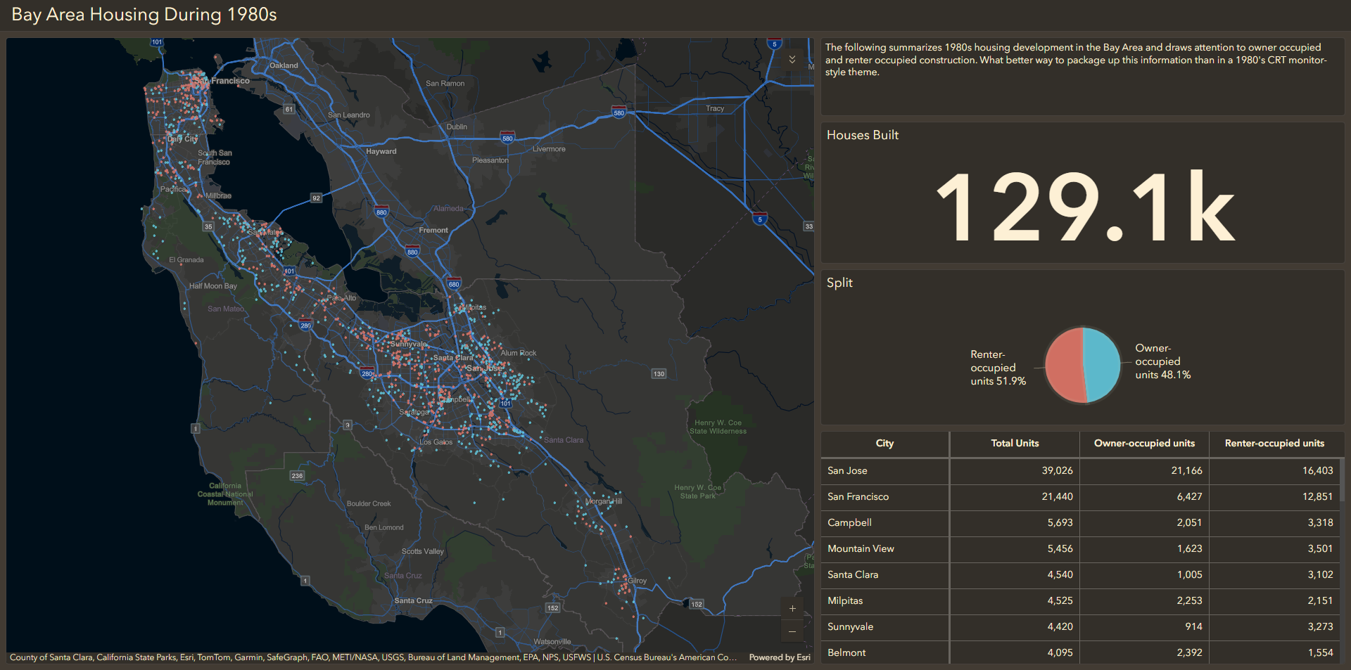

Let’s consider this example dashboard that summarizes housing development in the Bay Area during the 1980s, focusing on owner-occupied and renter-occupied construction.
example dashboard
For a 1980s-inspired theme, you could use a color palette that includes neon hues. The goal is to create a basemap and custom theme that evokes the CRT monitor-style look from the 1980s.

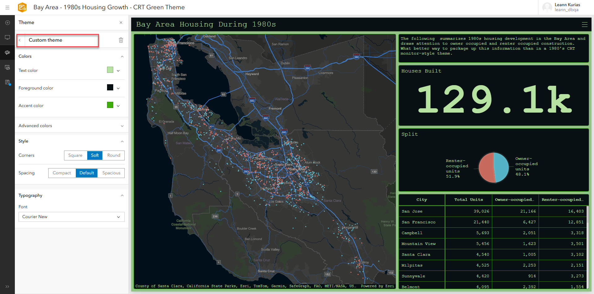

To begin, adjust the dashboard theme to incorporate colors, styles, and font choices that reflect the desired aesthetic. This could include accents of neon green, soft corners on dashboard elements, and a mono-spaced font that evokes a retro-tech feel.
update the theme of the dashboard
The color codes used in the custom theme: #b6e3a1 (text), #091013 (background) and #3eae0a (accent)

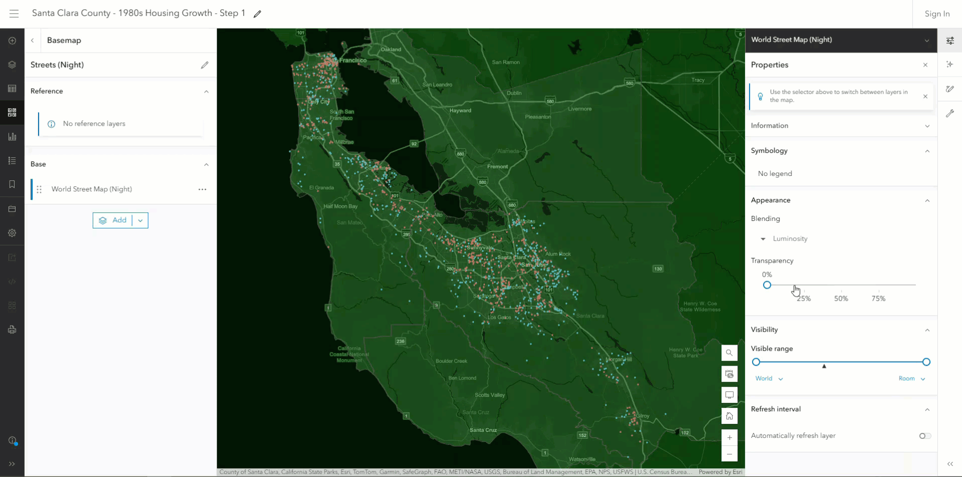

For this custom theme, the Streets (Night) basemap provides important transportation networks but doesn’t match the 1980s aesthetic we want. Let’s apply the techniques above to adjust the color scheme, apply neon-style accents, and experiment with transparency to make the map complement the dashboard.

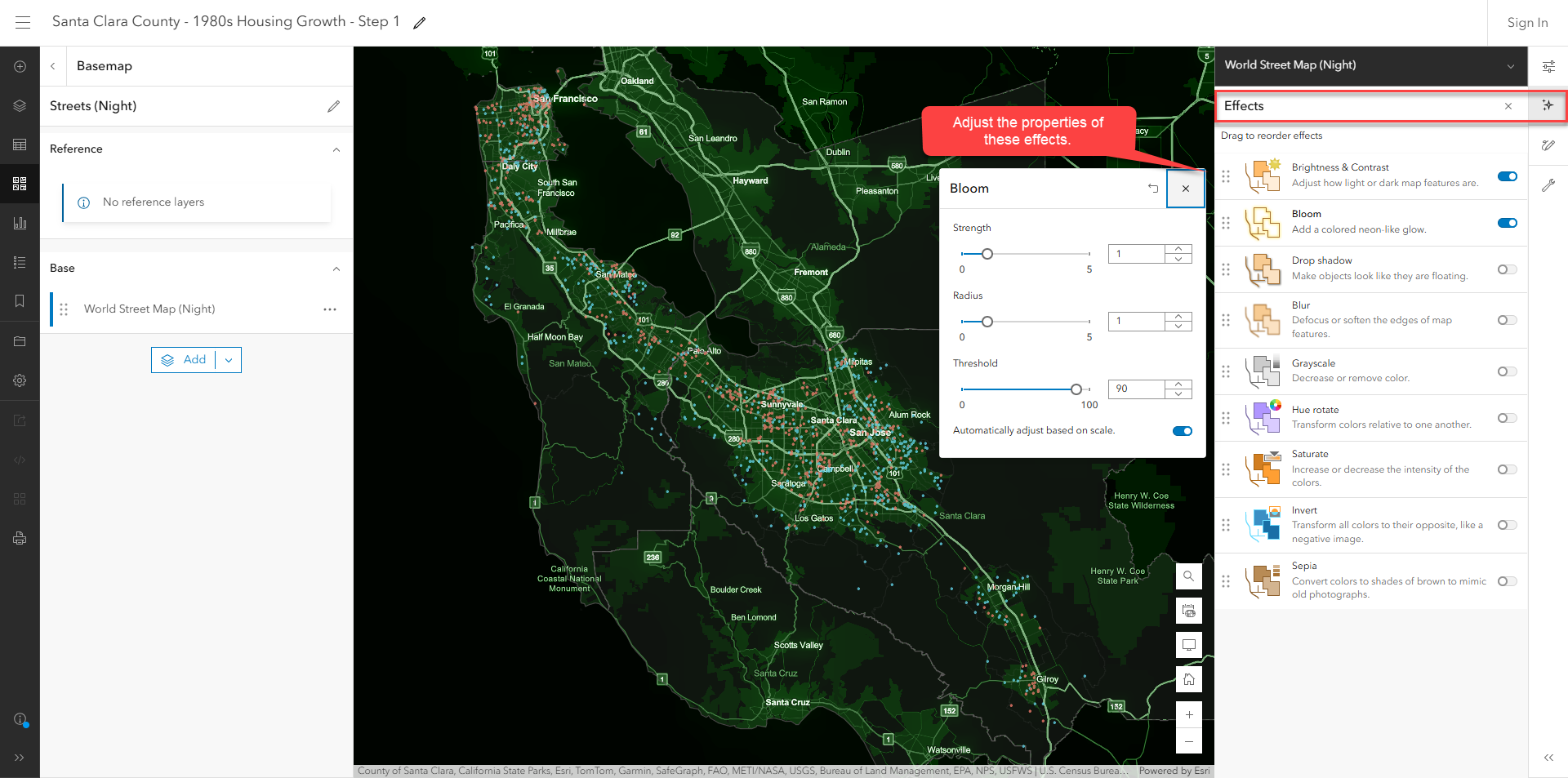

Open the map in Map Viewer. Start by adding a green background color (#023702) to the map using the map options. In the Properties of the basemap layer, we will select Luminosity blending again, and for an added 1980s look, use Bloom and Brightness & Contrast effects to elevate the aesthetic.
add blending and adjust effects of the basemap and layer
Additionally, adjusting these effects can enhance specific map features, such as roads, with a soft neon glow. Subtle adjustments to these effects can help the map align with the dashboard’s design.
adjust the effects

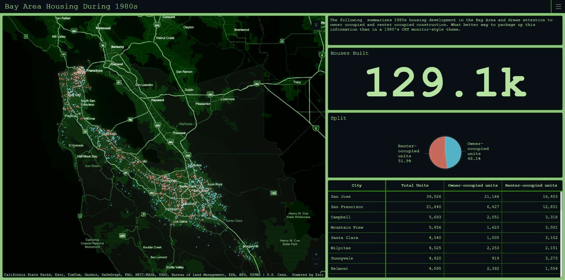

Here is the resulting dashboard with the enhanced map.
final result map on the dashboard
