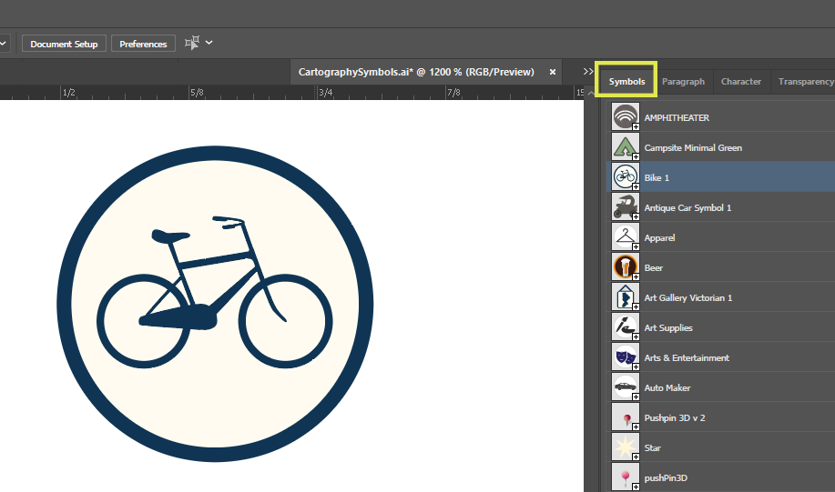

Adobe Illustrator symbols are stored in the Symbols panel (Window > Symbols), and can be saved as libraries as an .AI file. They work very well as cartographic points. Examine the CartographySymbols.ai file below as an example. The Symbols panel shows several icons, each with their own unique name. I dragged an instance of the Bike 1 symbol onto the Illustrator artboard (note: zoomed in 1600%). Users can place as many instances of a symbol to their artboard as they want.

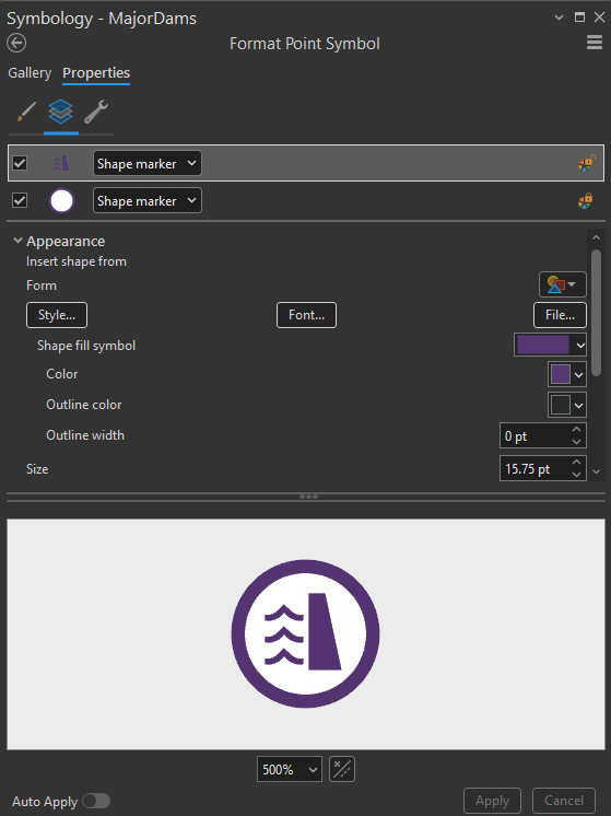

Many of you are GIS folks who use ArcGIS Pro to create custom point symbols for your organization or brand. If so, you probably also save those point symbols in a .STYLX file to reuse them in the future. With ArcGIS Maps for Adobe Creative Cloud 3.8, you can convert these point symbols into Adobe Illustrator symbols automatically. Here are some benefits of this workflow, followed by the two easy steps to convert your symbols.

- Multi-layered point symbols from ArcGIS Pro are grouped together in one singular “instance” instead of being split into ungrouped Illustrator artwork. This allows for an increased ease of cartographic editing.

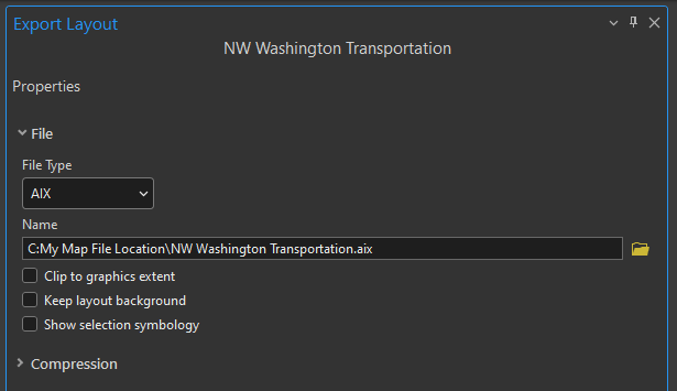

To export an .AIX file from ArcGIS Pro, go to the Share tab and select Export Map or Export Layout. Then select AIX as the file type. Find more information about exporting .AIX files here.

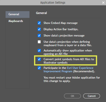

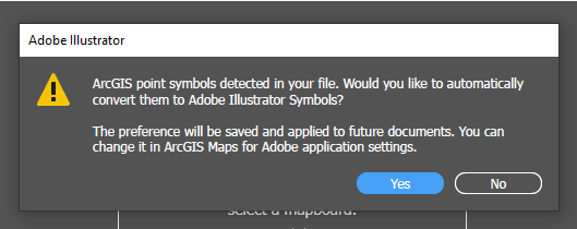

After installing ArcGIS Maps for Adobe 3.8, the first time you open an ArcGIS Pro-exported AIX file that contains points, you will see an alert asking if you would like to convert your points to Adobe Illustrator symbols. Choosing Yes will complete the conversion. Your selection will be saved in the application settings, and you can update them at any time.
That’s it! In fact, it’s really only one step – a new setting in ArcGIS Maps for Adobe. Continue reading to learn about the results of converting points to Adobe Illustrator symbols.

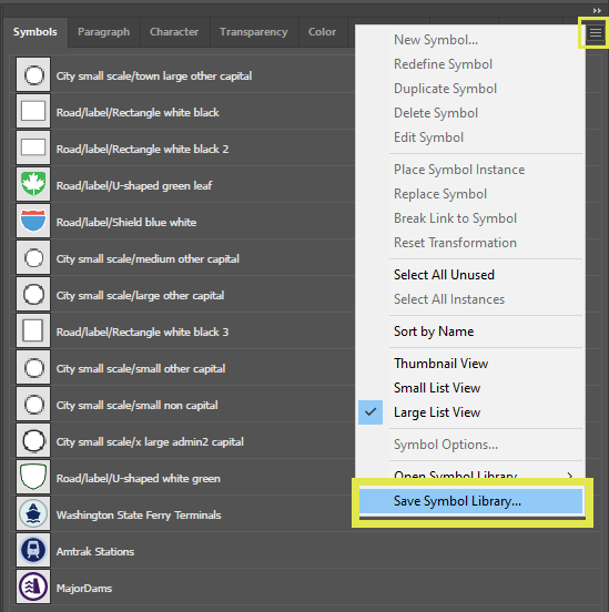

Because I opted to convert my points to Adobe Illustrator symbols, my Symbols pane is loaded with symbols representing each point layer on my map – including the vector tile basemap points. Below shows my Symbols pane containing the MajorDams, Amtrak Stations, and Washington State Ferry Terminals symbols along with the road shields and city points from the World Navigation vector tile basemap. Don’t forget to check out this new blog article describing how you can replace the road shield vector tile raster points with vector symbols. Additionally, if you wanted save these symbols as reusable graphics, click the Symbol pane’s hamburger menu > Save Symbol Library, and then save it as an .AI file.
