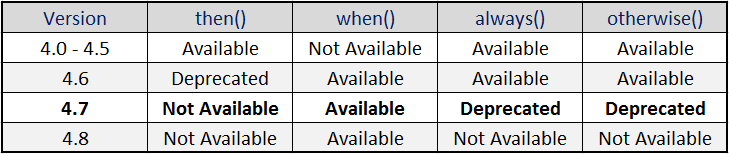

At 4.7, we removed then()
as a method in our API, and similarly deprecated always()
and otherwise()
as API methods (both of which will be removed from the API at the next release). This functionality can still be achieved using when().

The then() method will still work at 4.6, but will throw warnings in the browser console. To prevent these warning messages from appearing, please insert the below has flag into your code. Because this is an important breaking change, we are not removing then() at 4.6, and will instead remove then() at a later version.
