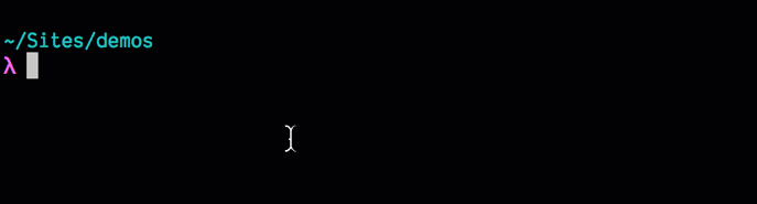

You can install it via npm with following command.
npm install -g @arcgis/cli
Once installed you can now use the @arcgis/cli to scaffold a new application, using the create
command and passing an application name.
arcgis create awesome

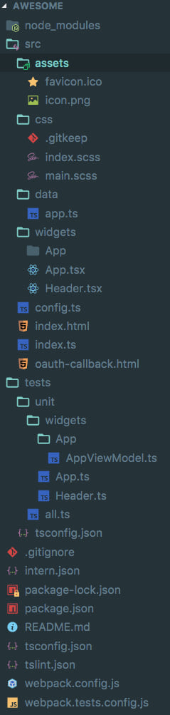

The @arcgis/cli will install a template application for you that is written in TypeScript, uses the @arcgis/webpack-plugin, includes a custom widget, and uses Intern for unit testing. See our recent blog about using the @arcgis/webpack-plugin, and our Using webpack for Custom Builds guide, for more information. The template application includes everything you need to quickly start building production ready applications. Here’s what the file structure of a newly created application will look like:
