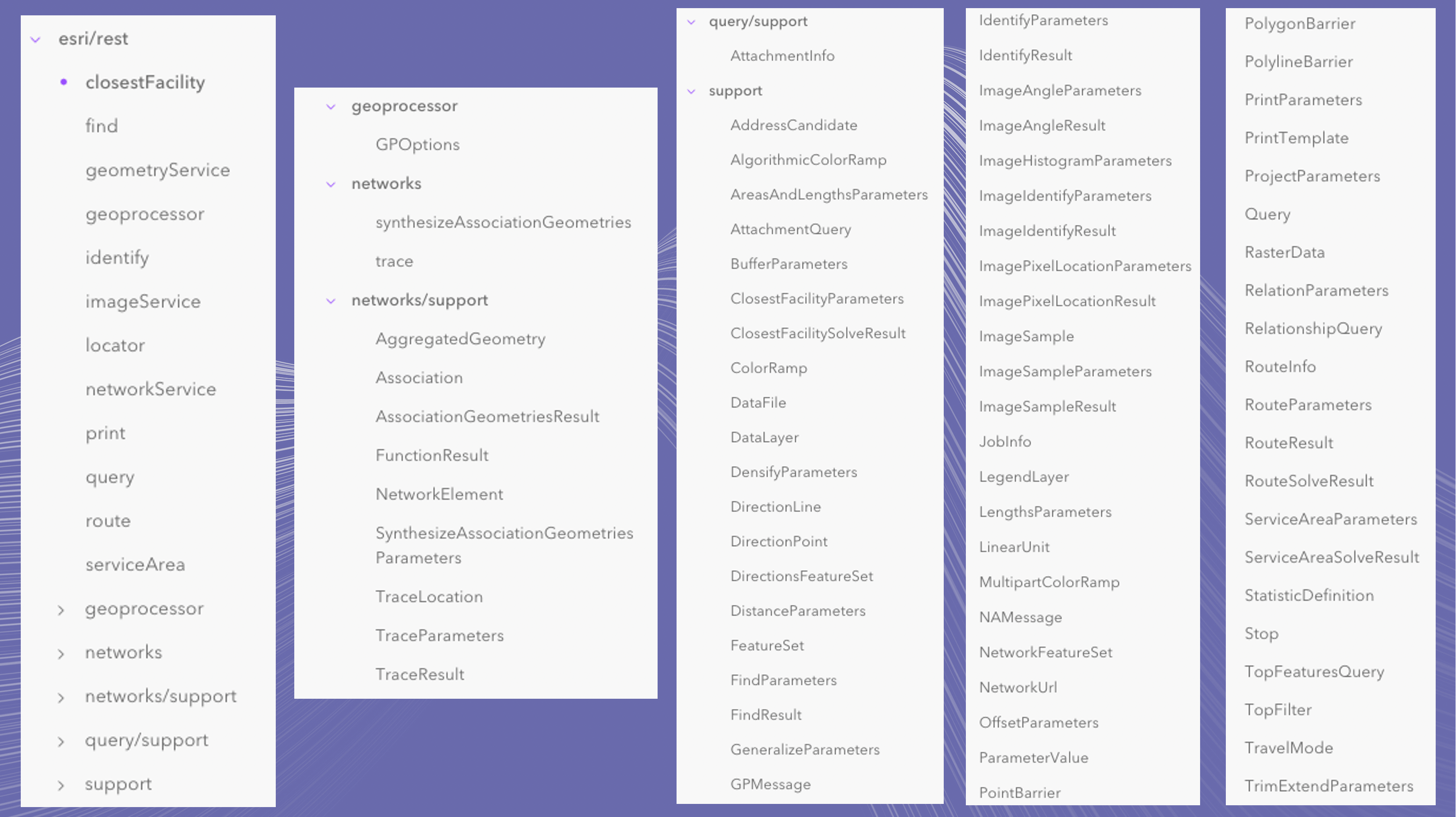

At version 4.20 of the ArcGIS API for JavaScript, we deprecated Tasks in favor of using more modular classes and objects found inside the esri/rest
folder. At version 4.24 (summer release) of the ArcGIS API for JavaScript, we will be removing support for Tasks.
!["esri/rest" folder "esri/rest" folder](https://www.esri.com/arcgis-blog/wp-content/uploads/2022/04/all-REST-toc.png)
These changes are already available for our users to test using next
via CDN and NPM: https://github.com/Esri/feedback-js-api-next
Why did we do this? This will make it easier to incorporate your code into a more modular app design, and also reduce unnecessary dependencies (you only import what you want). The new rest modules are functions, which do not require constructors, so you can use their methods immediately.
Also, because of the more modular design, you can import just one or more methods of a rest module, instead of having to import the whole module. There is one caveat to that statement though, and we’ll discuss that after we see some code examples.
