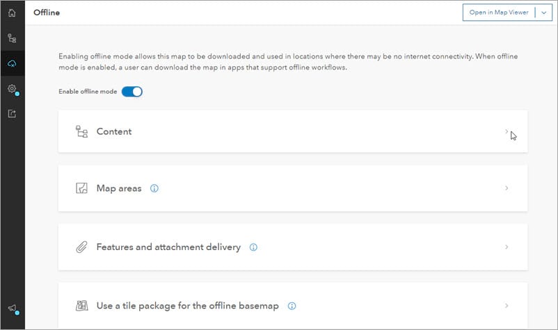

The Offline page of the Field Maps web app allows you to configure additional offline settings and check the offline status of your map and layers.
![Offline page Offline page](https://www.esri.com/arcgis-blog/wp-content/uploads/2021/06/offline-page.jpg)
From this page, you can enable offline mode, enable layers for sync, create map areas (as mentioned earlier), adjust feature and attachment delivery settings, and set an on-device tile package to use as the offline basemap. To learn more about the offline settings in the Field Maps web app, see Configure the map to work offline.
