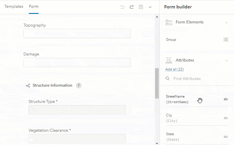

1. When creating a smart form using the Field Maps web app, how is this form stored?
Forms are built upon existing, published web feature layers and related tables. The forms you create in the Field Map web application are stored in your map meaning you can use the same form across the ArcGIS system. In fact, the forms are included as part of the web map standard.
2. Can you make a field conditionally required?
Currently in the Field Maps web app, you can conditionally show or hide a field. It is not currently possible to conditionally require a field. We continuously offer new capabilities in each release and you can add this as an idea to Field Maps ideas on Esri Community.
3. Can you save forms as templates so a new blank form can be applied to a new project?
Not today, but we are considering this as a future enhancement. If you would like to show further support for this you can log this on Field Maps ideas on Esri Community or show kudos for this similar existing idea. Next year we will be supporting writing the forms to the layer so the same form would be available even if the layer was in a different web map.
4. Can fields be prepopulated, such as the person conducting field work and the date it was completed?
Yes, this is possible using calculated expressions in the Field Maps web app. To get the name of the user who is editing you can use GetUser($layer).fullName and to get the time and date use Now(). For more examples, see Common calculated expressions for ArcGIS Field Maps.

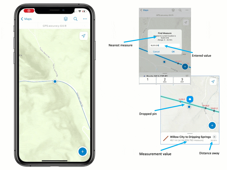

2. Does Field Maps support linear referencing?
Field Maps supports linear referencing. In Field Maps you can find a measure, store M-Values of new point features if the layer is aware, and even label values using Arcade.

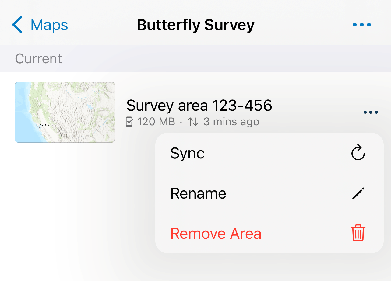

1. Can users access offline map areas after the data has been synced?
Offline map areas are still available after data has been synched. Users would have to purposefully remove offline map areas – either from the app or removed as an offline area from the portal to prevent future access.
