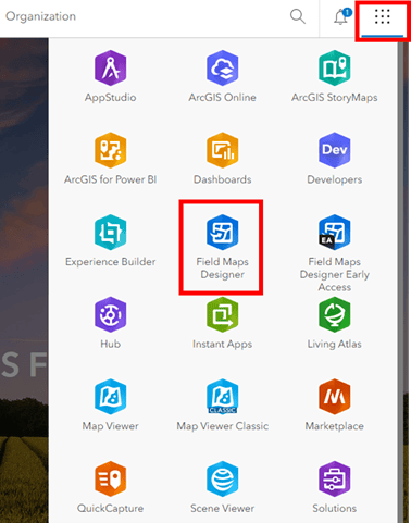

Question: How do I get access to Field Maps Designer?
Answer: You can access Field Maps Designer from the app launcher in ArcGIS Online or ArcGIS Enterprise portal.

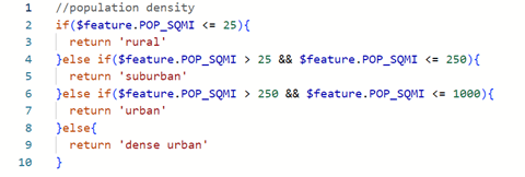

Question: What’s the difference between the Arcade function if() and the function IIF() ?
Answer: The IIF() function is usually used for a single true/false case. IIF() returns a given value if a condition is true, otherwise it will return an alternative value if false. An if() function can have multiple else if() statements as well as an else() statement as your default/false value when all other conditions are false. Its always worth trying to keep your expressions short for performance.

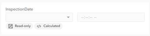

Question: If you use an Arcade calculation on one of the fields in your form, can the field then be edited manually?
Answer: No – a field cannot be manually edited if you run an Arcade calculation on that field. When setting up a calculation with Arcade in the Field Maps Designer, you will see the read-only and calculated labels appear on that field. If you manually change the field to allow for editing, the calculation will no longer run. If you have a specific use case where you would want to allow for manual editing, we would love to hear it, you can add this idea to Esri Community by sharing your use case.

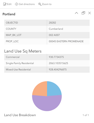

Question: Using Arcade can you summarize polygon areas within another polygon, such as land cover inside a tax parcel, and show the results in a pop-up?
Answer: Yes – it’s possible to summarize the data of polygons intersecting polygons. First, your layers will both need to be vector polygons, you will need to use the Intersects() function to find the intersecting geometries and a dictionary to check the selected feature with the other intersecting features. Using the dictionary will make sure that if you have multiple areas of the same type in your polygon, that you can add those together, instead of writing over it. You can see an example expression here.
