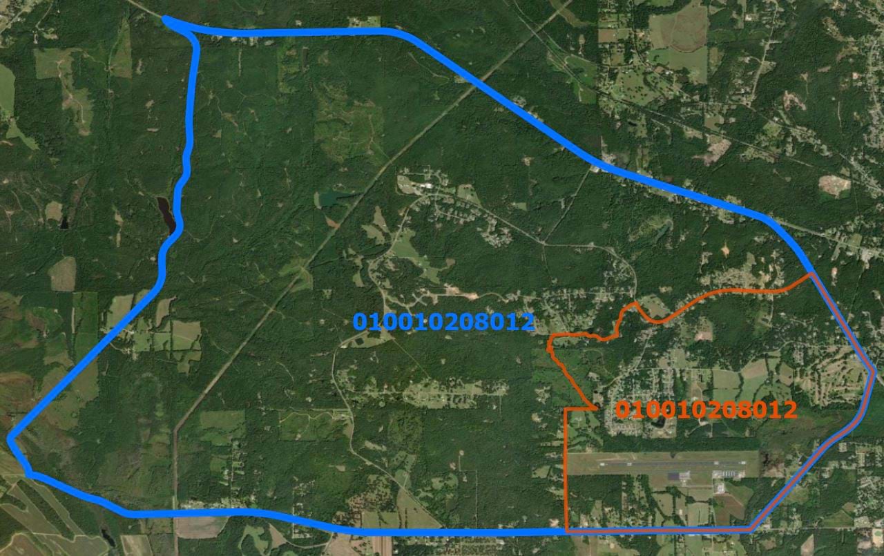

A final issue to consider when comparing 2010 and 2020 Census data is the change in boundaries that occurs between decennial censuses. Esri converted select SF1 variables from the 2000 and 2010 decennial censuses to reflect the same geographic boundary layers used in the 2020 Census data products, enabling temporal comparison. However, direct comparisons of 2010 and 2020 data as originally published is not advisable. For example, as the image below illustrates, the 2010 boundary (in blue) for block group 010010208012 has markedly changed in 2020 (in red). Esri developed a methodology to allocate data published in the original 2000 and 2010 geographic areas to the current 2020 Census geographic boundaries.

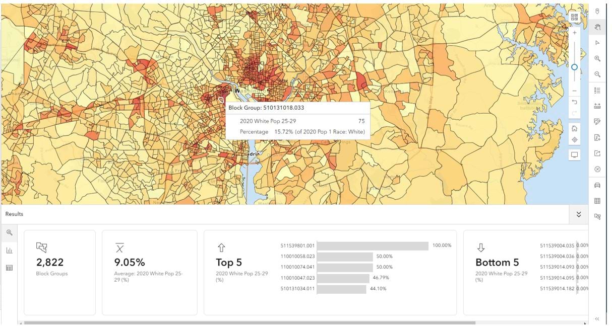

Users can access 2020 DHC data in BA by selecting “U.S. Census” as the source in the Data Browser to view the 2020 variables. Additionally, maps can be created based on these variables such as the percentage of the white population that is between the ages of 25-29:

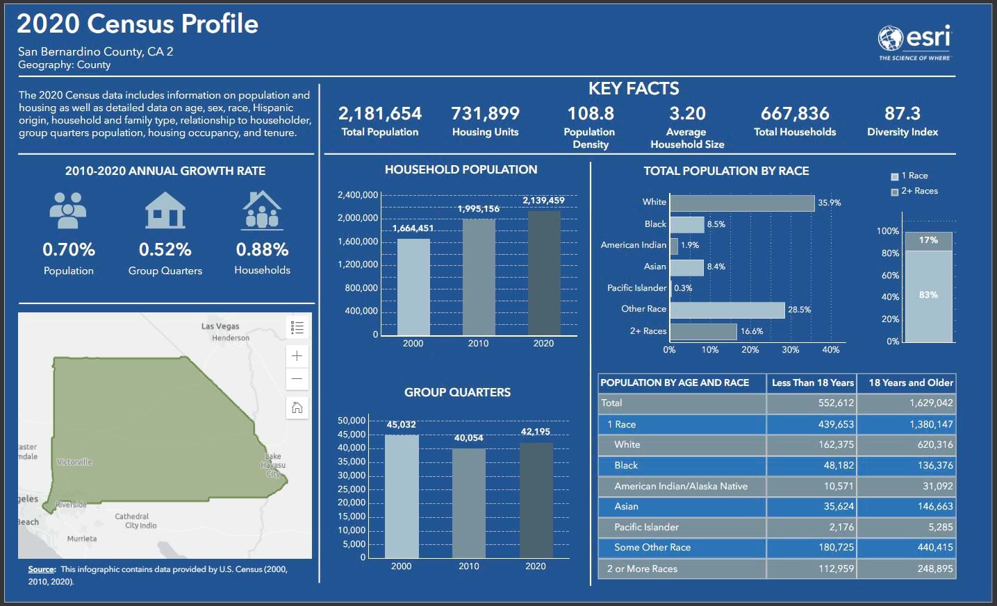

Users are also able to access DHC data through reports and infographics such as the 2020 Census Profile report and infographic:
