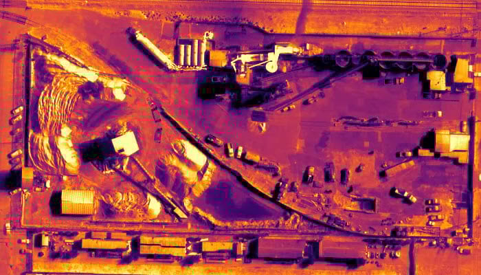

1. Thermal processing capabilities
Visualize temperature values on your map using Drone2map’s new thermal processing capabilities. For example, organizations in utilities or agriculture that use thermal infrared cameras now can create orthomosaics that depict temperature in either Celsius or Fahrenheit. Such variations in temperatures can reveal a great deal of information such as irrigation leaks in fields.

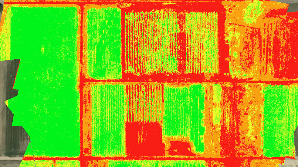

2. Redesigned multispectral camera support
Organizations working with multispectral datasets captured using cameras such as Micasense RedEdge or Altum now have tools to improve quantitative analysis of their data. Use radiometric calibration panels to create reliable imagery products across multiple dates and conditions and identify problem areas in your imagery data such as unhealthy vegetation. This feature is particularly helpful in the areas of agriculture and environmental monitoring.

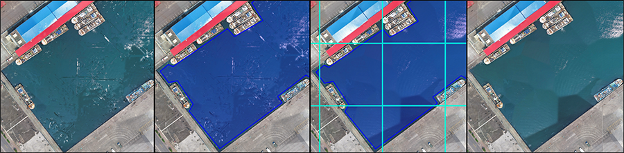

3. Pre-processing tools for quality control
For improving orthomosaic results, tools like Correction Feature and Waterbody Mask enable users to edit the DSM point clouds to improve the resulting orthomosaic tiles. Instead of recreating the entire orthomosaic, save time by just recreating the tile that falls within your area of interest.
Similarly, the Project Area tool helps constrain the processing results to the user specified area. The tool is particularly useful when working with oblique imagery or flights with low overlap where confidence in coverage at the flight boundaries may be questionable.

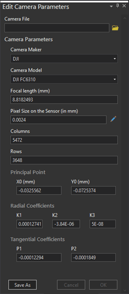

4. Redesigned Edit Camera pane
Re-use the existing parameters for a camera model that has previously been calibrated, or for a highly accurate metric camera via our redesigned Edit Camera pane. Quickly load your previously saved camera parameters without having to manually enter it for every project.

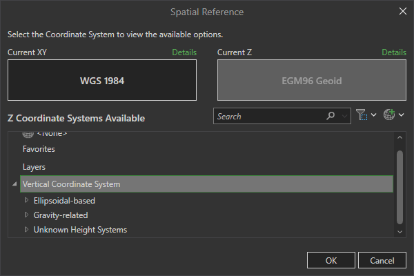

5. Improved vertical coordinate system support
The vertical coordinate system support in Drone2Map has been expanded dramatically. Users can now define accurate vertical coordinate systems, such as NAVD 88.

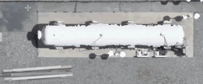

6. Create and share animations of your results
Drone2Map now has a built-in ability to quickly generate animated flythroughs or guided tours of your outputs, export the files in different formats and then post them on social platforms like YouTube, Instagram, and Twitter. This is a wonderful way to create and share intuitive and dynamic views of your project data with people outside your organization.
