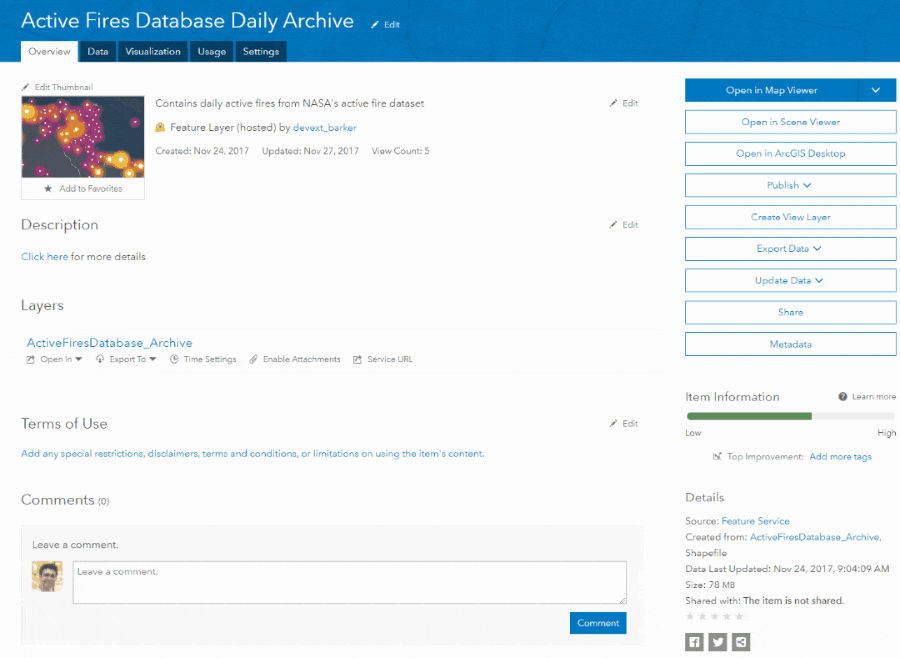

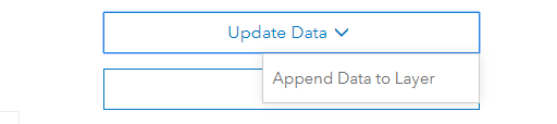

To get started, go to the item page for your hosted feature layer.  From the Overview tab, you’ll notice a new menu button on the right called Update Data. Click it and you’ll find.  Append is also accessible from the Data tab.
After clicking Append Data to Layer, you’ll be prompted to upload the file that contains the data you want to append.  Supported formats include:

To save time and to reduce errors, it is strongly recommended that the schema of the uploaded file matches the schema of the hosted feature service.  Let’s look at an example.  NASA publishes a daily active fires dataset, which can be crucial in mapping fire perimeters and visualizing the day-over-day change.   By using Append instead of publishing new layers, you can store all that information in one layer, with the bonus of being able to use the time slider to visualize daily changes.  You can just download the file and append the new data daily (in the case of the active fires dataset, make sure you take a few extra seconds to define the projection before uploading). By default, ArcGIS Online will attempt to match fields to your feature layer. If you want to change that, just click Show Field Mapping and change the defaults, or unmatch fields you don’t want used.  When you’re happy with the selected options, click Apply to append the data.
