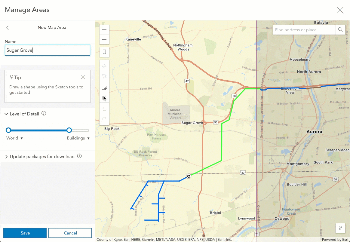

1. Create a new map area
Start by creating an offline map area for a web map that can be taken offline. Add the pertinent information, including a name.

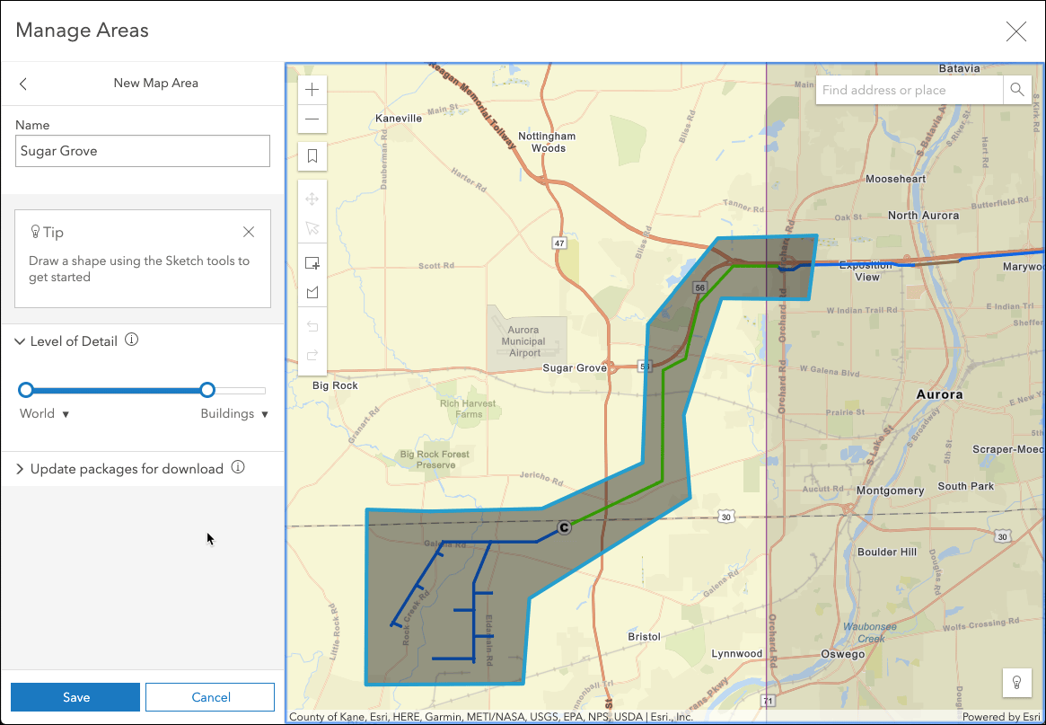

2. Sketch the polygon
Next, use the polygon tool to define the area.
![](https://www.esri.com/arcgis-blog/wp-content/uploads/2019/07/Polygon-PP-Define-Area.gif)
Double click to finish the polygon.
If the polygon shape doesn’t include the area you want to take offline, you can modify the polygon shape as needed. You can move or scale the area, or update a portion of the polygon include the desired area.
![Pre-planned map areas can now be irregularly shaped. Pre-planned map areas can now be irregularly shaped.](https://www.esri.com/arcgis-blog/wp-content/uploads/2019/07/Completed-Polygon-Preplanned-Area-2.png)
