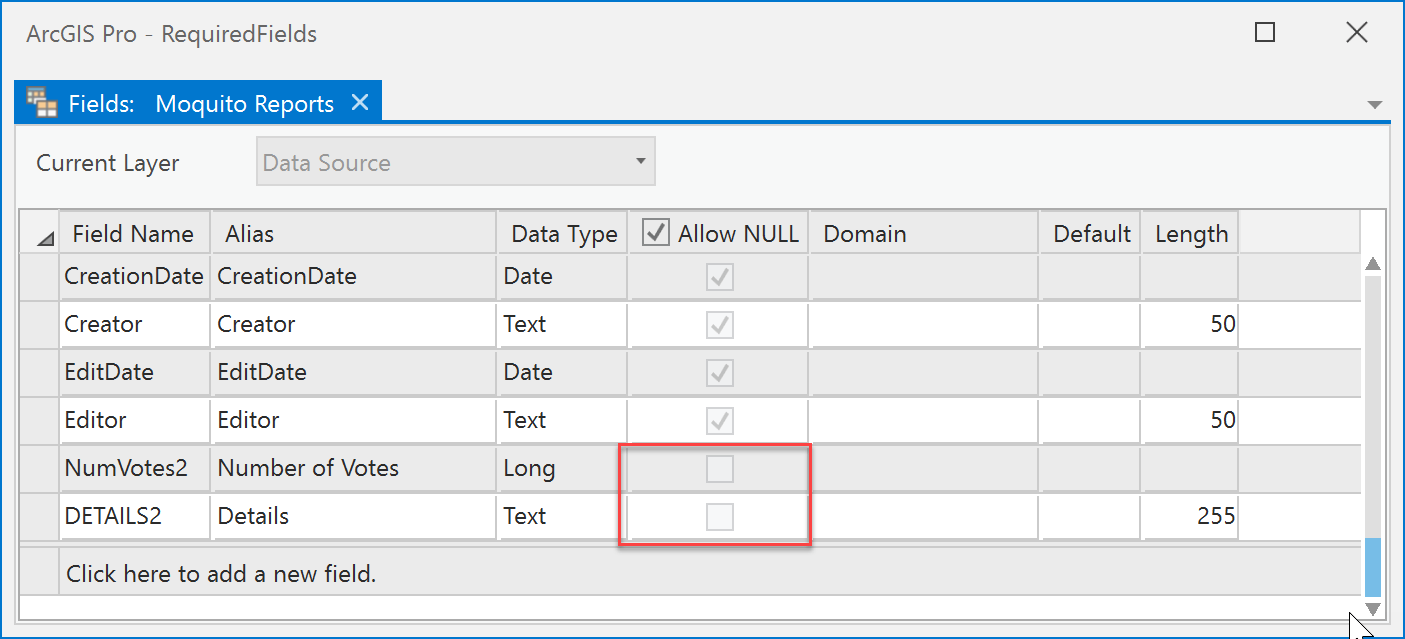

Within the geodatabase information model, you can define a field as non-nullable and a value must be supplied for that attribute before it can be submitted. This can be defined when adding fields, or when updating an existing field if the feature layer is empty.

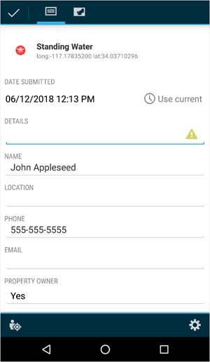

The easiest way to get the desired result is to share your feature layer from ArcGIS Pro 2.1 or later. This avoids the initial issue: null values are maintained in your feature templates during publishing, and default values aren’t brought in where you haven’t included them.
Since the required field isn’t populated when an feature is created, Collector requires the mobile worker to enter a value when capturing new features.

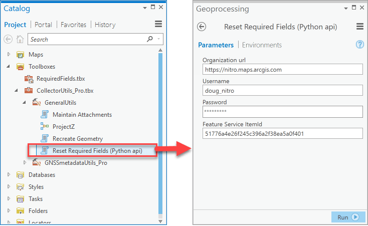

But what if you’ve already published feature layers, for example, from ArcMap? To get the desired behavior on these required fields, we need to update the feature layer’s templates using our script to remove these “placeholder” values.
To update your existing feature layers, download the Geoprocessing toolbox and associated Python script from our GitHub repository. You can use the Geoprocessing tool in ArcGIS Pro, or run the script independently using the ArcGIS API for Python.
The script takes a few parameters, and you’ll need to be the owner of the feature layer or an organization administrator.
Looking at the script code reveals that the feature layer is updating each of the feature templates and removing the default values inserted into the feature templates during publishing. This change is limited to non-nullable fields where the field value matches the respective placeholder value for text or numeric fields. Fields that have an associated coded value domain are excluded.

After running the script on your feature layer, any new features created will require your mobile worker to enter information for these fields.
