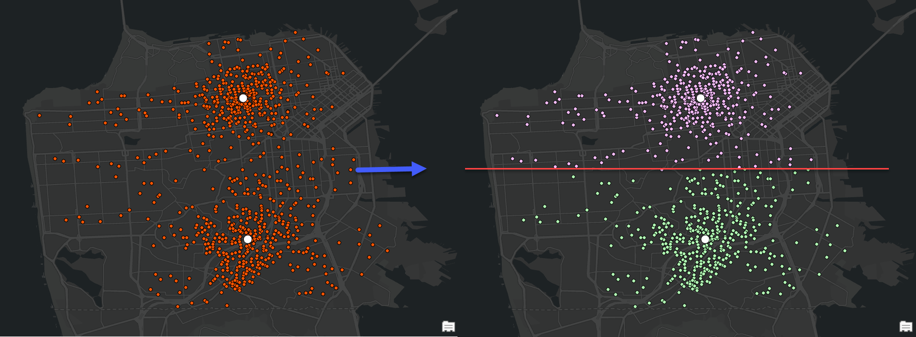

In the map below we have two store locations and hundreds of customers scattered everywhere (left side). We want to identify which ones are closest to each store (right side).
![All Customers vs Closest Customers All Customers vs Closest Customers](https://www.esri.com/arcgis-blog/wp-content/uploads/2019/04/ClosestStores.png)

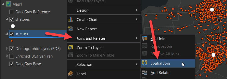

To accomplish this we’ll do a spatial join from your customer file to your store file. Right-click your customer layer to find Spatial Join.
![Spatial Join Spatial Join](https://www.esri.com/arcgis-blog/wp-content/uploads/2019/04/SpatialJoin.png)

Now you simply symbolize the layer. Use the following options:
- Primary Symbology method = Unique Values
- Field 1 to symbolize = Your new ID linking customers to stores (here I used: CLOSEST_STORE_ID)

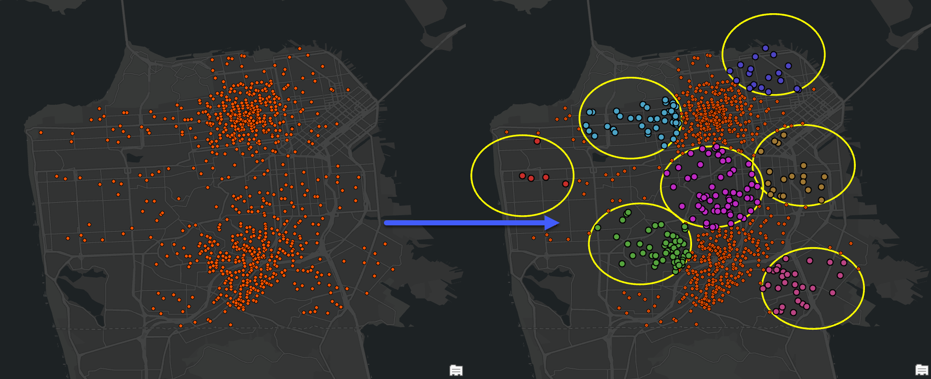

In the map below we have customers scattered everywhere (left side). We want to identify which ones fall within each 1-mile trade area (right side) for further analysis.
![Trade Areas with customer assignments Trade Areas with customer assignments](https://www.esri.com/arcgis-blog/wp-content/uploads/2019/04/TradeAreaStores.png)

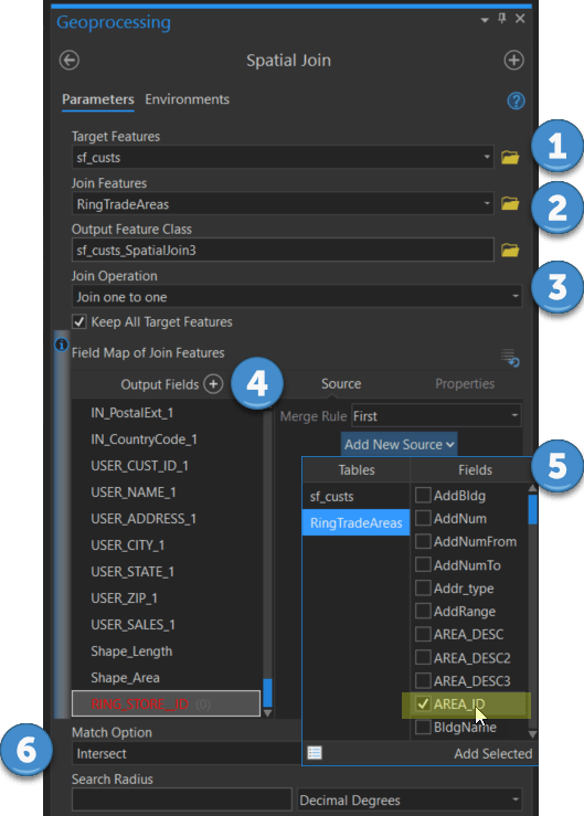

To accomplish this we’ll do another spatial join.
Once the Spatial Join geoprocessing tool opens, follow this workflow – this time linking the customer points to the trade areas.
(1) Target Features = your customer layer
(2) Join Features = your store layer
(3) Join Operation = Join one to one
(4) Add a new Output Field to your customer layer, call it something like RING_STORE_ID or TRACT_STORE_ID
(5) In Add New Source, select a unique ID from a field in your trade area layer (this will assign the store and customer points)
(6) Match Option = Intersect.
![Spatial Join by trade area Spatial Join by trade area](https://www.esri.com/arcgis-blog/wp-content/uploads/2019/04/SpatialJoinTradeArea.png)

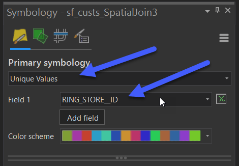

Then again you simply symbolize the layer with the following options:
- Field 1 to symbolize = Your new ID linking customers to stores (here I used: RING_STORE_ID)
