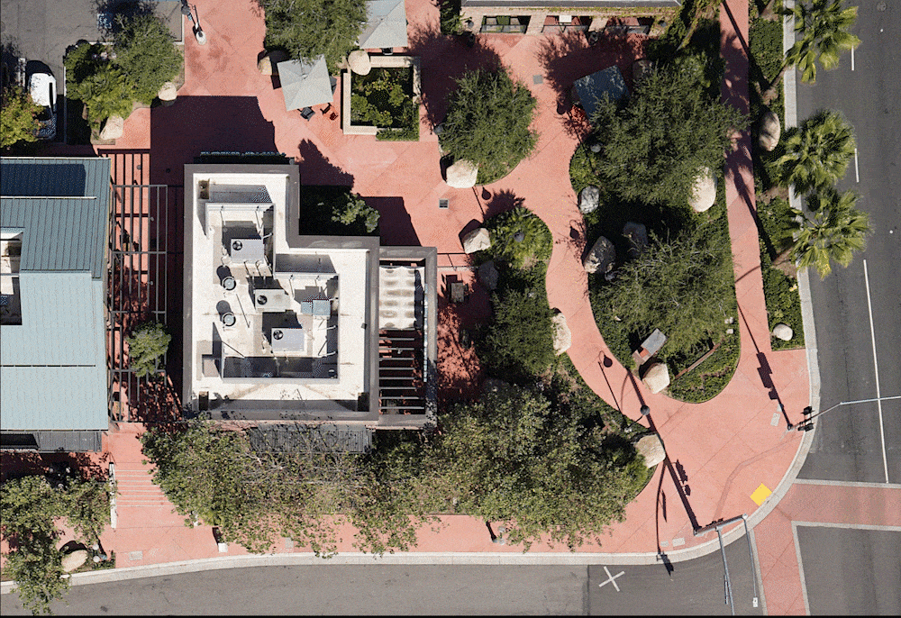

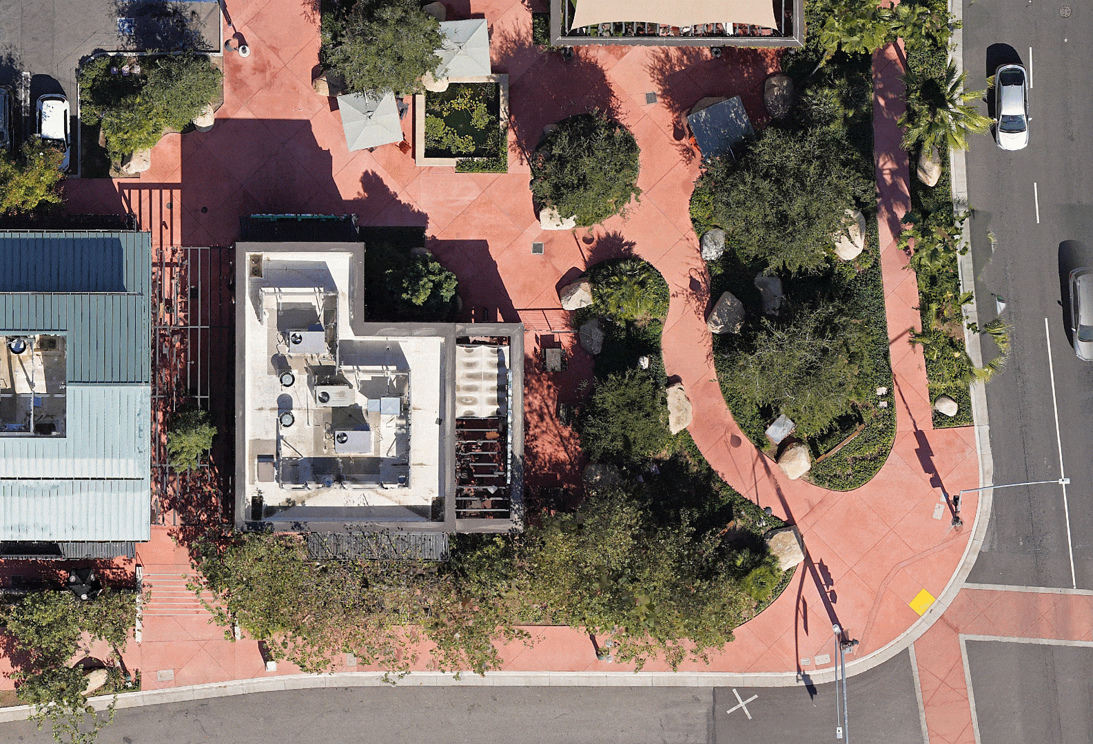

drone image of building in traditional orthomosaic
Drone image of building with true ortho

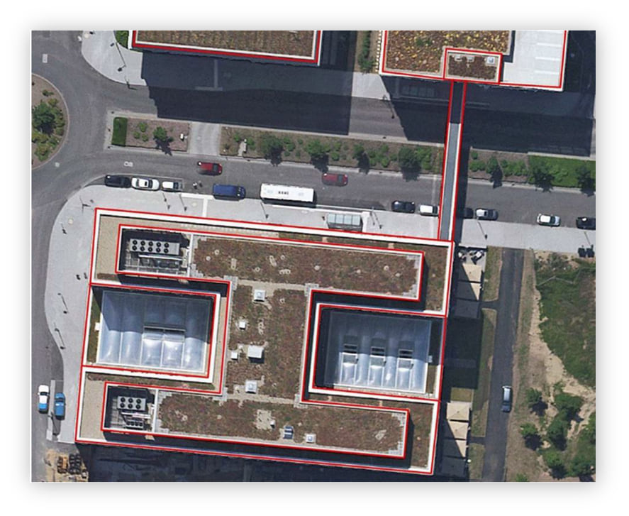

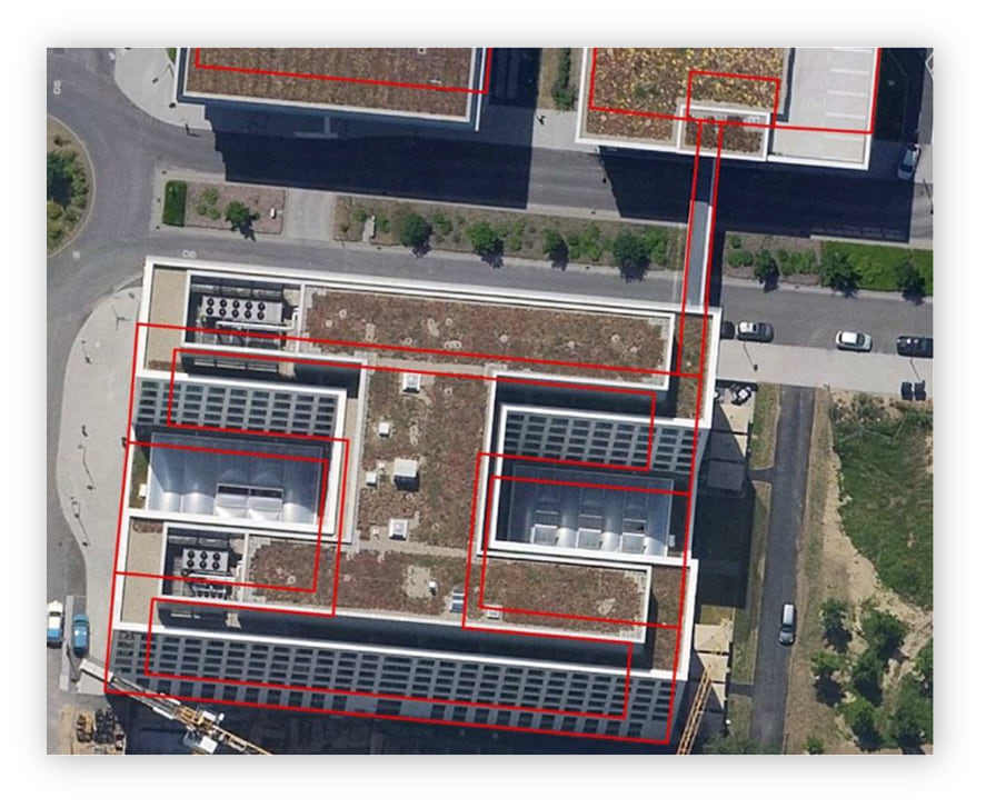

Screenshots showing an office building, as viewed in a traditional orthomosaic (FIRST) and in a True ortho (SECOND). The red overlay shows the correct horizontal placement for the building footprint. Note the cars on the north side of the building, visible in the True ortho, but occluded from view in the traditional ortho
For a “True ortho”, everything in the output image is viewed from directly above. The name indicates that the result is truly orthographic at every pixel.  Buildings no longer lean or obscure the ground, and the facades are no longer visible.  This is achieved by first creating a very detailed digital surface model (DSM) – for example from Dense Image matching on well overlapping imagery using pixel-wise stereo.  Subsequently, this very detailed surface is used to generate an output ortho image by blending source image pixels rectified in their position given their pixel-accurate elevation. As every pixel from every image can be correctly located, the redundancy can be used to remove inconsistent information – such as moving objects like cars or solar reflections. The multiple views also enable the resolution and radiometry to be improved.
The major benefit of a True ortho is that it is free of occlusions caused by building lean, and every pixel is correctly located. This makes it ready for measurements and consistent in location with other geospatial information or subsequent image captures. Furthermore, automation is higher since no breakline or seamline editing needs to be considered. Higher image overlap is recommended for optimal results – for nadir images, 80% forward overlap and at least 60% side overlap – in order to minimize gaps in the DSM and achieve a high-fidelity True ortho. The benefits of True orthos are the very consistent results and high geometric accuracy, enabling simplified change detection. The disadvantage is that it is computationally more expensive and input orientation needs to be very accurate, requiring aerial triangulation – so the True ortho takes longer to create and therefore is less suitable for applications demanding rapid turnaround such as emergency response.

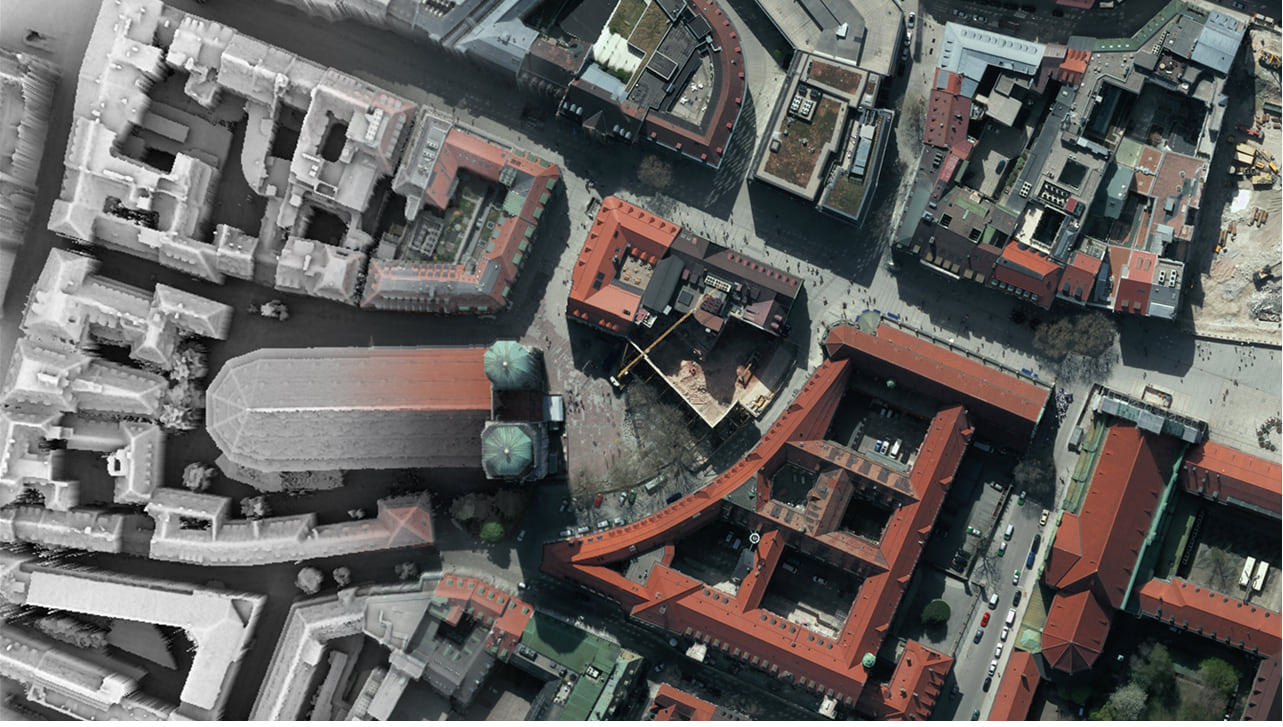

Screenshot showing a portion of the citywide True ortho of Munich, Germany on right, visually blended with the high resolution DSM on left (data courtesy of Aerowest).
