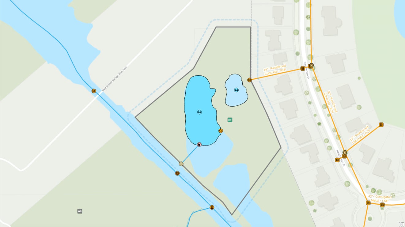

Model stormwater system behavior through gray infrastructure such as pipes and green infrastructure such as open channels and detention basins.

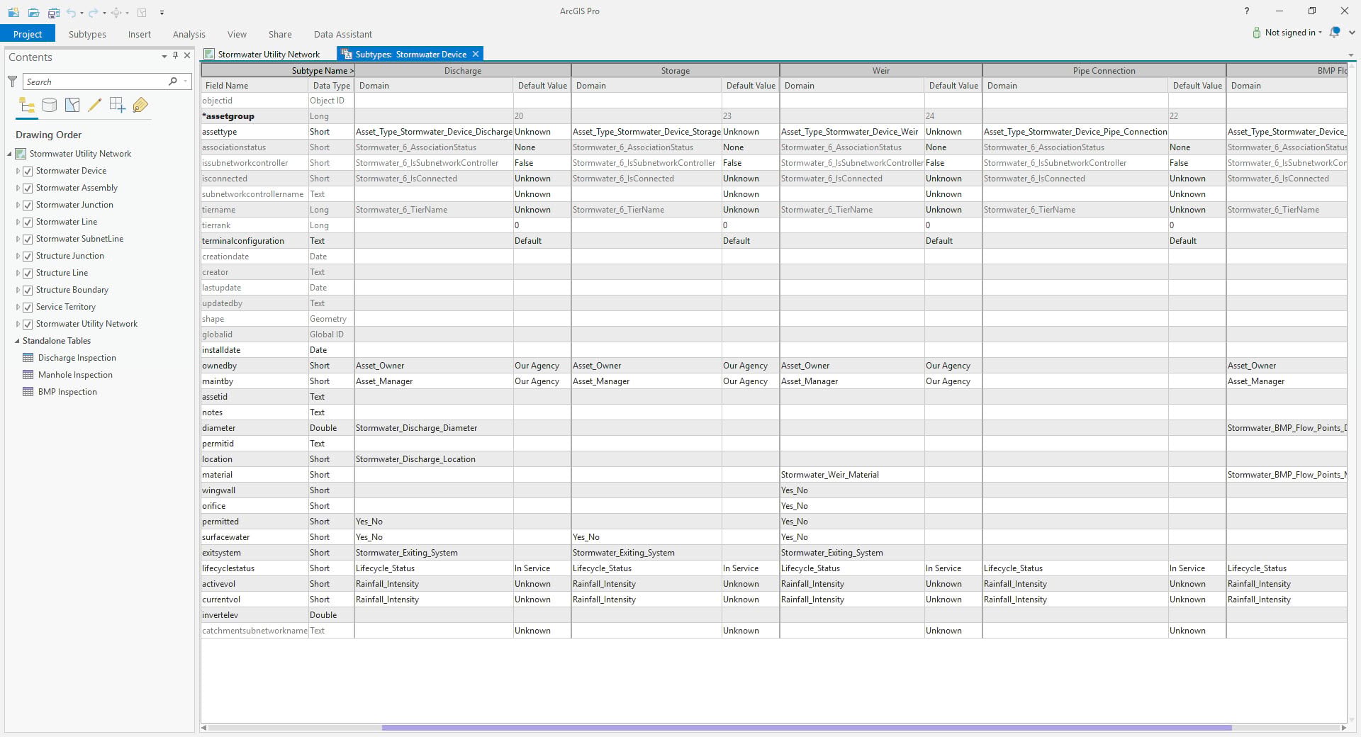

Examples of the stormwater specific schema included in the configuration

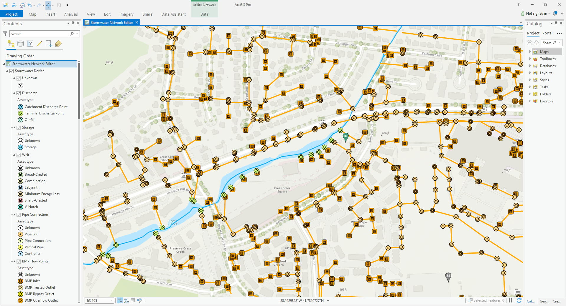

The included ArcGIS Pro projects will save you the work of having to build a Pro map to publish the network service and then having to build maps to work with the published network services. The included maps are preconfigured with symbols, labels, and popups to make it easy for users to interact with the network.
One of the included maps
