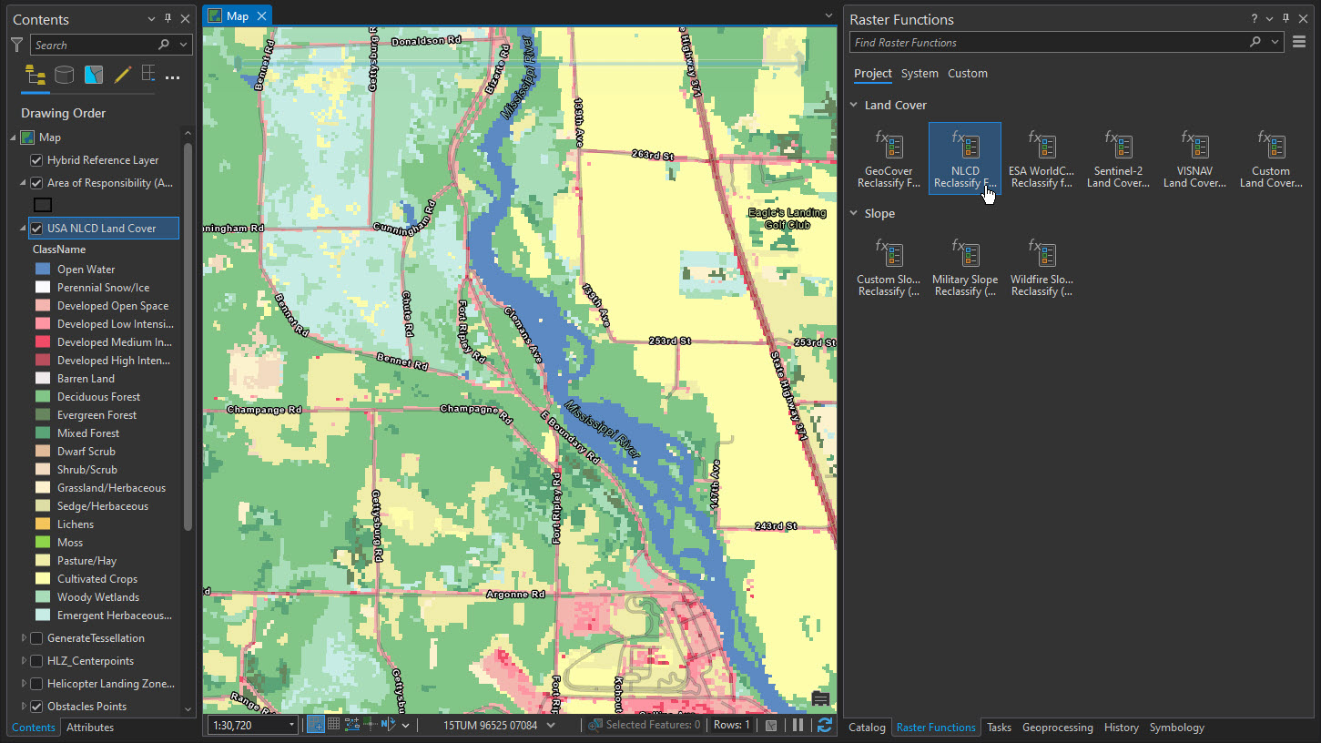

Not all land cover is suitable for an HLZ; forests, urban areas, and waterbodies are problematic at best and more likely prohibitive. Additionally, helicopters have ground slope limits, with the maximum degree varying slightly depending on the aircraft. Using preconfigured raster functions, you can reclassify land cover and elevation datasets to areas that are acceptable, acceptable with caution, or unacceptable. These raster functions account for a variety of different data sources and operational standards, such as military doctrine and wildfire response standards, but you can also use your own data schema or define your acceptability criteria.
Map with land cover data and raster function pane
The HLZ Suitability project provides raster functions specific to different land cover datasets and operational standards.

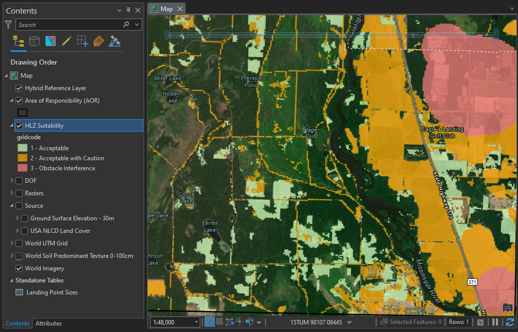

Although it’s possible for land cover and ground slope to be classified as acceptable with caution, obstacles such as cell towers, agricultural equipment, and energy infrastructure are more prohibitive. The solution’s ArcGIS Pro project allows you to identify these features using data from the U.S. Federal Aviation Administration, by loading other obstacle datasets, or by digitizing your own obstacle features. Then, you can create obstacle offset buffers at either the standard 10:1 offset ratio or your own custom offset ratio. These buffers will help clearly identify areas where obstacles pose a risk to helicopter operations and should therefore be avoided.
After you have assessed land cover and ground slope and generated obstacle buffers, you can create an overall HLZ suitability raster layer that depicts areas that are acceptable, acceptable with risk, or that include obstacle interference. This raster layer provides a great overview of these conditions, but the solution can take your review even further by allowing you to remove locations that do not meet the minimum military and wildfire aircraft area requirements from the overlay. Additionally, the solution can generate a reference tessellation grid to help you visually review and assess if areas meet your aircraft requirements. You can also upload imagery and soil data to help you visually inspect and review if locations are acceptable for HLZs.

The HLZ Suitability project allows analysts to process land cover, elevation, and obstacle data to create HLZ suitability overlays.

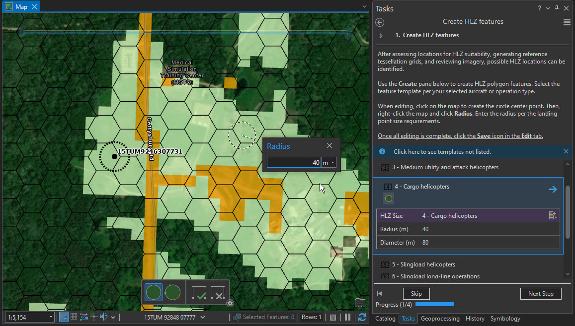

Rotary aircraft vary significantly in size, speed, and maneuverability, so a minimally viable HLZ is not one size fits all. For example, in military operations, a CH-47 Chinook helicopter requires a minimum landing zone diameter of 80 meters, but a Type 3 wildfire response helicopter only requires a 23-meter one. The solution’s ArcGIS Pro project accounts for these differences by including various aircraft types in its feature editing templates and reference tables. After assessing terrain suitability, you can create candidate HLZ locations specific to your organization’s aircraft and operational requirements.
A map with green honeycomb polygons overlaid in yellow and the ArcGIS Pro Tasks pane open on the right.
Feature templates enable analysts to create HLZ features specific to aircraft requirements.

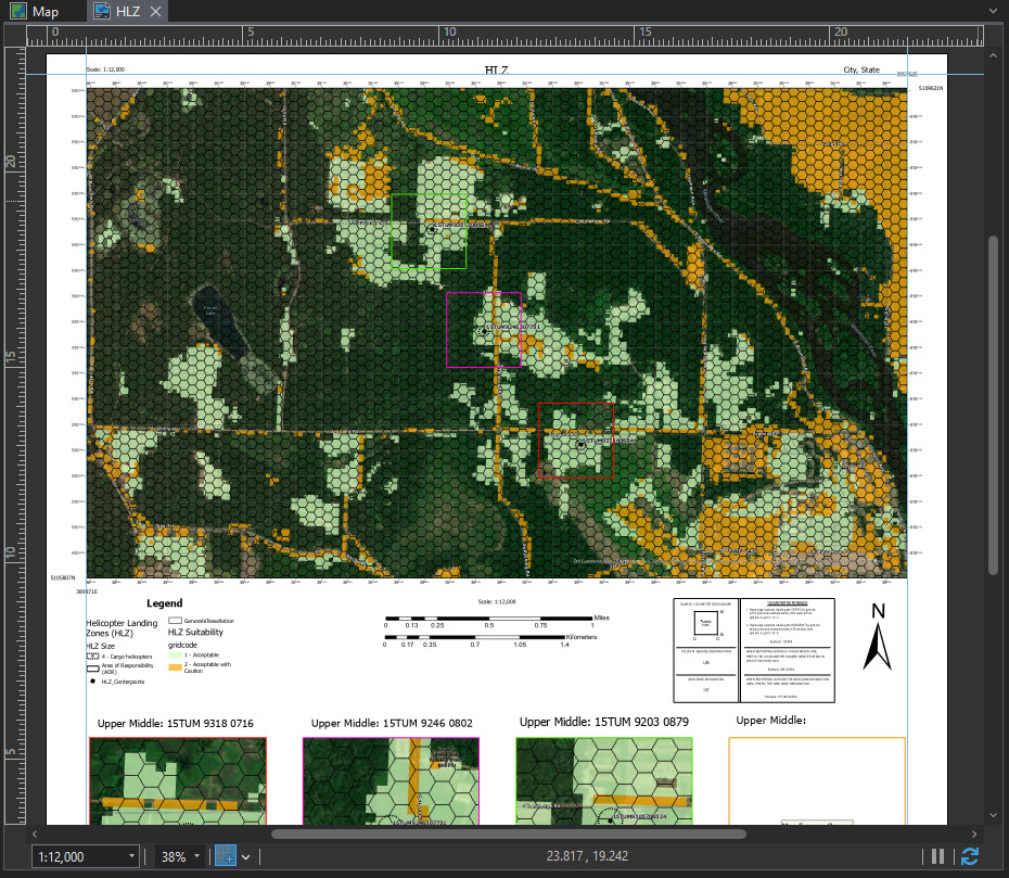

Once you’ve completed your analysis and have identified HLZs suitable for your organization’s aircraft, you have several options for sharing the information directly from ArcGIS Pro or ArcGIS AllSource with operations staff members or leadership. For example, you can publish and share services through your ArcGIS Online organization or ArcGIS Enterprise portal. These services can then be added to planning or operations applications that can be leveraged by the entire operations team. You can also create a map layout in ArcGIS Pro that can be shared as a PDF file or even printed and distributed to aircraft personnel or HLZ managers. With this shared information, you can effectively break down information silos and improve overall unit effectiveness.
A map layout in ArcGIS Pro showing areas of HLZ suitability rated acceptable or acceptable with caution.
The ArcGIS project includes a layout template for sharing HLZ analysis and data.
