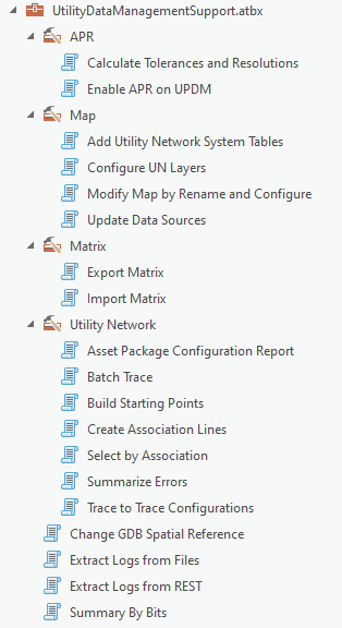

Toolbox: We have reorganized the toolbox and added a new toolset called Utility Network, that organizes the tools that are specific for the Utility Network. The Batch Trace, Building Starting Points, Create Association Lines, Select by Associations, Trace to Trace Configurations(renamed from Trace results to Trace configurations) have been moved to this folder.
In this toolset, you will find some new tools for the Utility Network.
Asset Package Configuration Report: This tool generates a collection of Excel Workbooks/Sheets to review the what properties are include/removed from the result by selecting 1 or more configurations. Multiple configurations can be selected to compare the results. Running this tool is much faster than running Apply Asset Package and reviewing the results in a GDB.
Summarize Errors: A dirty area in the Utility Network can contain 1 or more errors. Deciphering these errors and running reports on them to determine the types of errors in the system during data migration can be complicated. This tool generates a Mobile GDB with features for each error in the Utility Network and summary views. Making it easy to review errors, create a report of the types of errors and evaluate batch processes to resolve errors.

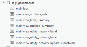

Extract Logs from Files/Rest: The log files created by ArcGIS Server and ArcGIS Pro are very useful in troubleshooting performance and configuration issues. These tools extract that information and stores it into a Mobile GDB, which is a SQLite database. A series of views are prebuilt to allow you to hone in on particular operations. If you are querying a lot of log information from ArcGIS Server, instead of using Extract Logs from Rest, it is faster to use Extract Logs from Files and browsing to the ArcGIS Servers log folder.
