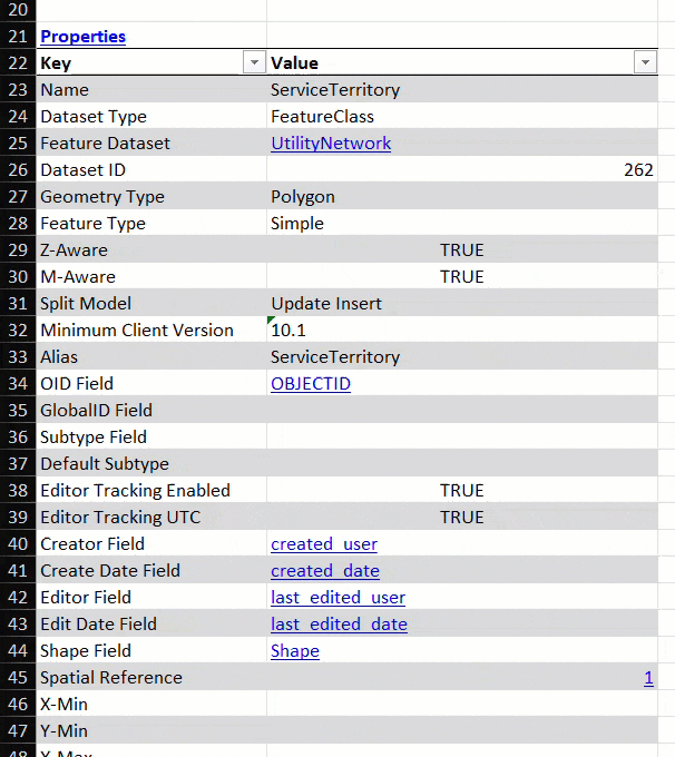

You can edit the properties of a feature class or table on each dataset’s individual worksheet. Open the report and navigate to the worksheet for the ServiceTerritory feature class. To do this, first make sure the table of contents worksheet is open. The ServiceTerritory feature class can be found in the datasets table in cell A79. Click the hyperlinked class name to navigate to the class’s worksheet.
This worksheet contains the schema information for the Service Territory class. Properties of the class can be edited in the properties table, which starts on row 22. Class properties like name, alias, and geometry type can be edited by typing a new value into the cell. The GIF below shows an edit the class alias, changing it from ServiceTerritory to Service Territories. You’ll also see the geometry type changed from polygon to point. Changing the fundamental properties of data must be done carefully. Changing the class geometry type from a polygon to point will save successfully, but may not produce a schema with valid associations or functionality when converted to a new geodatabase.

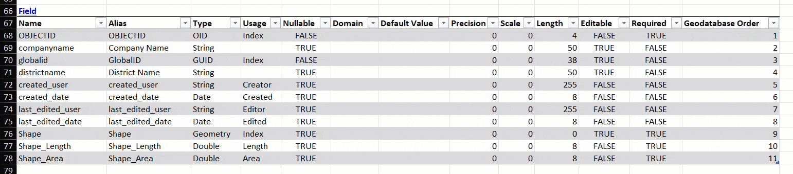

Continue scrolling down the ServiceTerritory worksheet to the Fields table.
Field properties are edited in the same manner as the class properties, by typing a new value. All field properties in this table are editable. When changing the names of fields, references to the field must also be updated to maintain the reference. For instance, if the field is used as a key field in a relationship class, the name of the key field in the relationship class also must be updated to reflect changes made to the field name. It is recommended that you use the Excel find all shortcut (Ctrl+F) to locate all references to the field in the workbook. In the GIF below, the field name, alias, and nullability of the field named companyname are changed.
It’s important to note that not all edits are implementable. For instance, changing the precision and scale of fields will have no effect on the final schema if your target workspace is a file geodatabase. Since the file geodatabase has predetermined precision and scale for all numeric fields, these edits are ignored. Edits made within the schema report do not circumvent the boundaries of the geodatabase or add functionality that is not present.

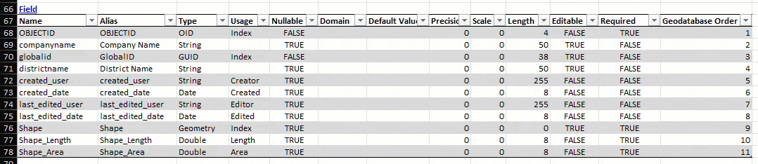

Rearranging fields in a table was a highly requested feature from many users. Editing the order of the rows in the fields table will alter the arrangement of the fields in the resulting XML. When reimporting the schema, fields are created in the visual order of the fields table, from the top down.
Rearranging fields can be achieved in two ways. You can cut and insert rows to reorder them, or you can sort the fields using the geodatabase order column. The geodatabase order field has no direct effect on the schema and only serves to sort the table. For instance, if you change the values in the geodatabase order field but do not sort the records in the table, the field order will be left unchanged in an XML output. Sorting is key to making this edit. Assigning numbers in the Geodatabase Order field will not result in a new field arrangement without it. This is true of tables throughout the report.
Adding new rows to the fields table allows new fields to be added to the schema. When adding a new row, make sure that all cells in the row are filled in to ensure successful conversion. Field attributes that are optional in ArcGIS Pro—such as alias, domain, and default value—are also optional in the table. All other fields are needed for successful field creation.

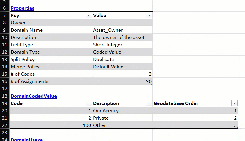

Additional geodatabase features like domains and spatial references also have individual worksheets you can edit. In the Subtype Field Info table in cell E154, click the hyperlink for the Asset_Owner domain to navigate to the domain’s worksheet.
In the domain worksheet pictured below, you can edit a domain’s properties, such as name, split policy, and the domain’s data type. You can also add domain values by inserting a row in the DomainCodedValue table.
Take extra care when editing the fundamental properties of data, such as its data type. Changing the data type of a domain requires updating the fields where the domain is assigned. For instance, when changing a text type domain to a short type, the fields assigned to this domain must also be updated to a short data type for the domain to successfully associate after converting to a geodatabase.

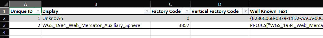

Clicking the hyperlink brings you to the Spatial Reference worksheet, pictured below. Here we can see all spatial references present in our schema.
This utility network dataset is created with an unknown coordinate system, which you can see is stored in row two, with a unique ID value of 1.
I have included an additional feature class in this sample data with the WGS 1984 spatial reference. You can see the additional spatial reference on row 3 of the Spatial Reference worksheet, it is assigned to Unique ID number 2. Return to the Utility Network worksheet using your preferred method. To define the Spatial Reference of the Utility Network as WGS 1984, edit the value to match the unique ID of the desired spatial reference. In this case, we will change the 1 to a 2 in the spatial reference row of the properties table.
To add an additional coordinate system, add a new row, provide a new unique ID for the row, and copy the Esri well-known text of your preferred coordinate reference system into the well-know text column. The coordinate reference sheet uses the well-known text to define the coordinate reference system. Rows for new coordinate systems must contain a valid value for this cell. Values in the factory code column are for display only and will not affect the resulting spatial reference during conversion.
