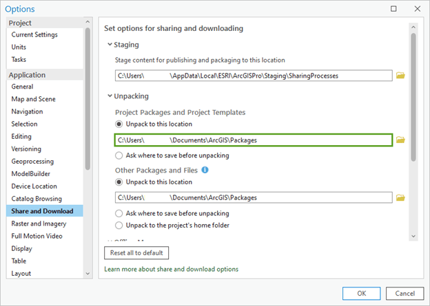

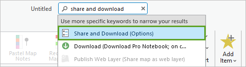

1. In ArcGIS Pro, above the ribbon, click the Command Search bar and type share and download. From the search results, click Share and Download (Options).
![Share and Download (Options) in the Command Search menu Share and Download (Options) in the Command Search menu](https://www.esri.com/arcgis-blog/wp-content/uploads/2023/10/Picture1.png)
The Options window appears. The location of all projects unpacked from .ppkx files is listed under Project Packages and Project Templates.
![Unpack location in the Options window Unpack location in the Options window](https://www.esri.com/arcgis-blog/wp-content/uploads/2023/10/Picture2.png)
By default, this location is set to Documents\ArcGIS\Packages.

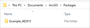

3. Open Windows Explorer and browse to the Packages folder listed above.
Inside, there will be a folder with the name of your project, followed by a set of random characters.
![Project package folder Project package folder](https://www.esri.com/arcgis-blog/wp-content/uploads/2023/10/Picture3.png)
This is where your project is saved. You may have saved Example.ppkx in your Downloads folder or on your Desktop, but the first time you opened it, a new folder was created here, in your ArcGIS Packages folder. Every time you opened Example.ppkx since, it was actually accessing the files inside the Example_482615 folder.
4. Delete (or rename) the Example_482615 folder.
This will not delete Example.ppkx.
5. Re-open Example.ppkx.
ArcGIS Pro will open, showing the Example.ppkx project in its original state. A new folder will be created in the ArcGIS Packages folder.

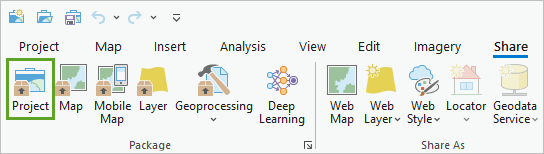

1. On the ribbon, click the Share tab. In the Package group, click Project.
![Project button on the Share tab of the ribbon Project button on the Share tab of the ribbon](https://www.esri.com/arcgis-blog/wp-content/uploads/2023/10/Picture4.png)

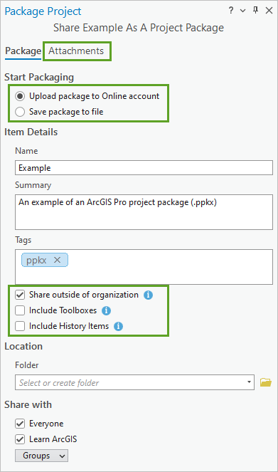

The Package Project pane appears. Some of its parameters are common to any sharing pane in ArcGIS Pro. But there are some others that you should take special note of:
![Package Project parameters Package Project parameters](https://www.esri.com/arcgis-blog/wp-content/uploads/2023/10/Picture5.png)
- Start Packaging—When I need to share a package with many people (for example, to accompany a tutorial) I choose Upload package to Online account. When I need to store a package on my computer for my own reference, or when I only want to send it to one person, I choose Save package to file.
- Share outside of organization—I always check this box to ensure that all of the data is copied into the project package.
- Include Toolboxes—Check this box if you want to include any toolboxes aside from the default toolbox (the default toolbox is always included).
- Include History Items—Check this box if you want the project to include a record of tool parameters from the Geoprocessing History. You’ll need to remove any failed history items first.
- Attachments—Use this tab to attach extra files that cannot otherwise be stored in a project, for example a .pdf file. Later, the attached files can be found at C:\Users\<username>\Documents\ArcGIS\Packages\<project package name>\commondata\userdata.

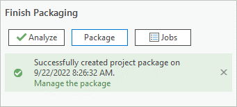

2. When you have filled all of the parameters, click the Package button at the bottom of the pane.
3. When the process completes, click Manage the package to open either the folder containing the .ppkx file or the item page if you saved it as an ArcGIS Online or portal item.

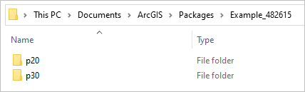

When you create a .ppkx file using the steps above, it will create two copies of your project: one for the current version of ArcGIS Pro and one for the last major release. For example, Example.ppkx was created with ArcGIS Pro 3.0. It contains a p30 folder with a 3.0 version of the project and a p20 folder with a 2.9 version of the project.
![p20 and p30 folders p20 and p30 folders](https://www.esri.com/arcgis-blog/wp-content/uploads/2023/10/Picture8.png)
The 2.9 version allows users people who haven’t upgraded to ArcGIS Pro 3.0 to use the project. After the next major release, the folder names will change to p30 and p40.

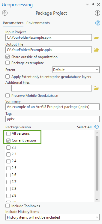

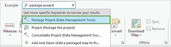

To reduce file size, you can save a .ppkx file without this backward compatibility.
1. In ArcGIS Pro, above the ribbon, click the Command Search bar and type package project. From the search results, click Package Project (Data Management Tools).
![Package Project in the Command Search menu Package Project in the Command Search menu](https://www.esri.com/arcgis-blog/wp-content/uploads/2023/10/Picture9.png)
The Geoprocessing pane appears.
2. Fill out the tool’s parameters. For Package version, uncheck All versions and check Current version.
![Package Project tool parameters Package Project tool parameters](https://www.esri.com/arcgis-blog/wp-content/uploads/2023/10/Picture10.png)
You can learn more above the Package Project tool’s parameters on its help page.

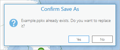

1. If the project package that you want to replace is on your computer, share a new .ppkx file that overwrites the original one.

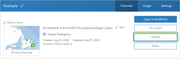

2. If the project package that you want to replace is stored on ArcGIS Online, share a new .ppkx file on your computer. Ensure that it has exactly the same name as the original project package.
3. Open the item details page for the project package. Click the Update button.
![Update button on item page Update button on item page](https://www.esri.com/arcgis-blog/wp-content/uploads/2023/10/Picture12.png)
4. Upload the new version of the .ppkx file.
