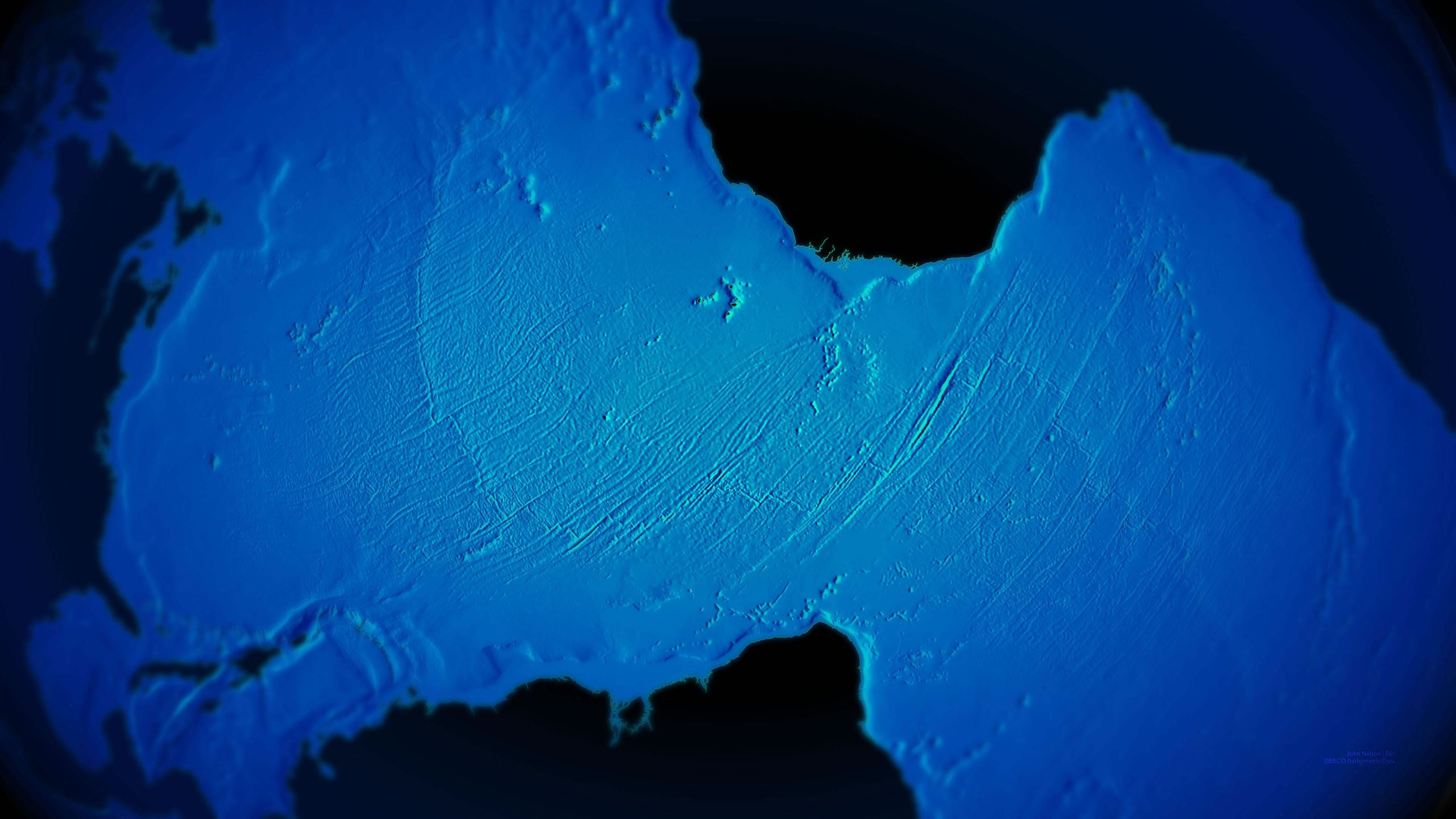

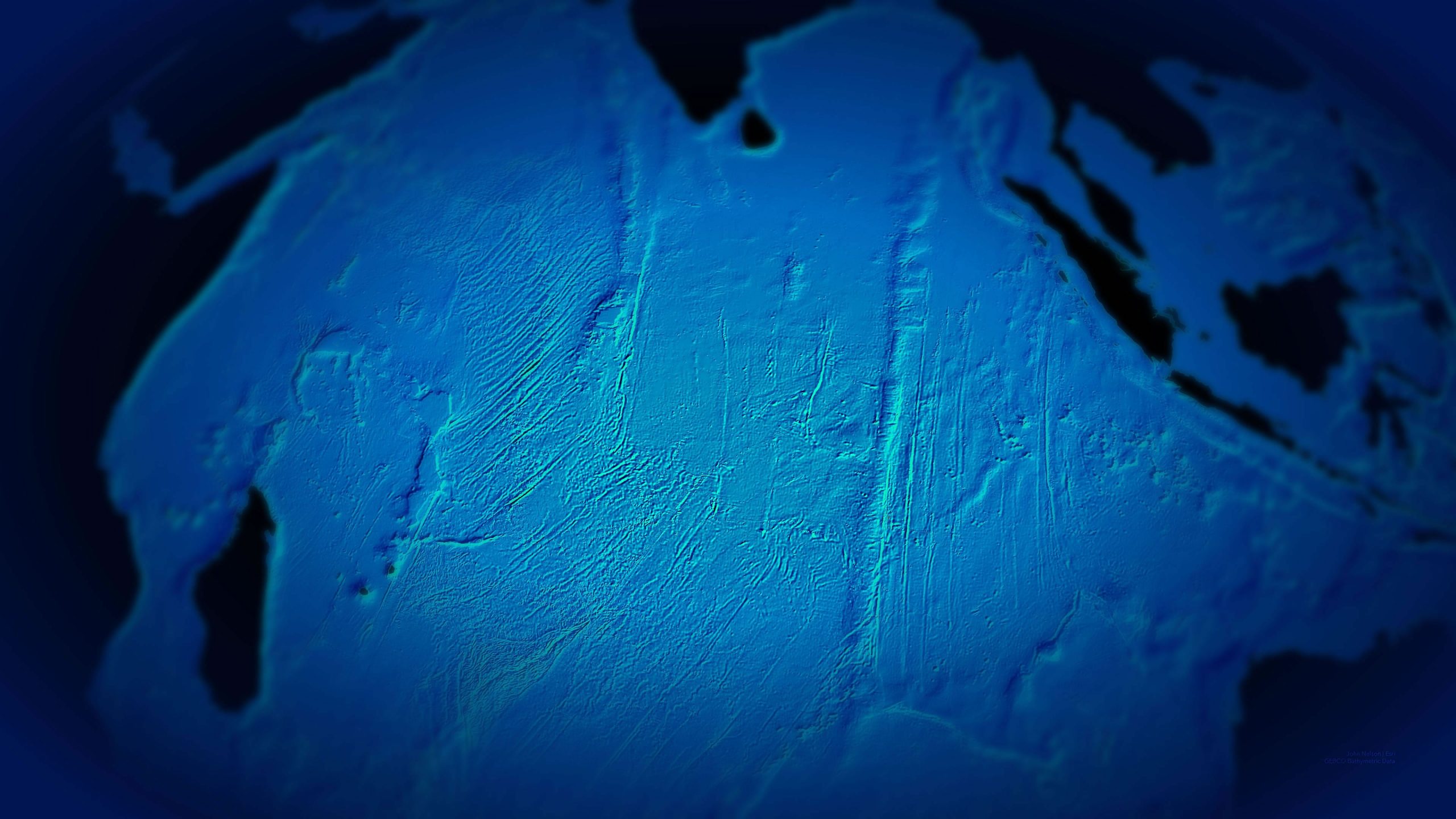

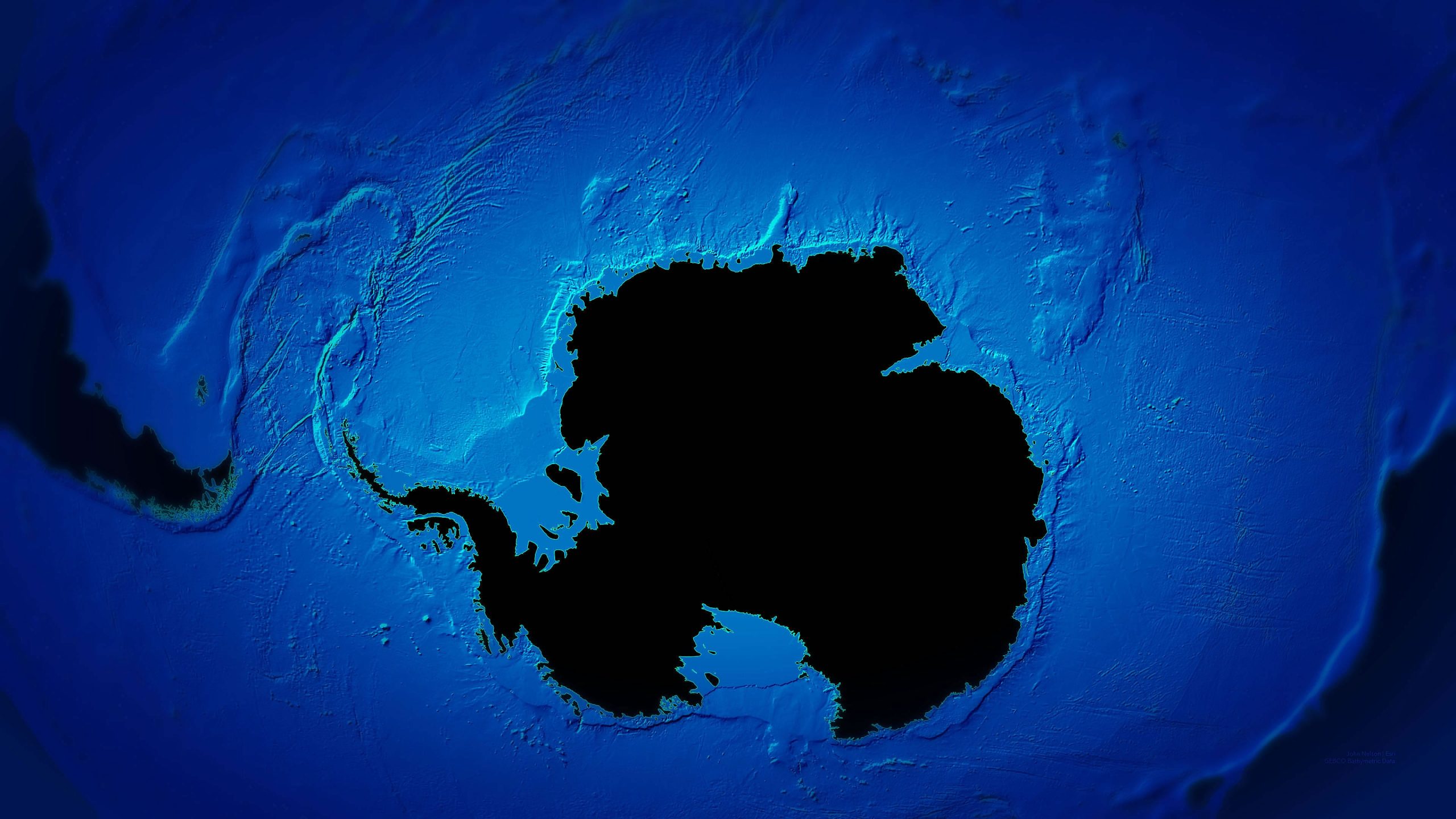

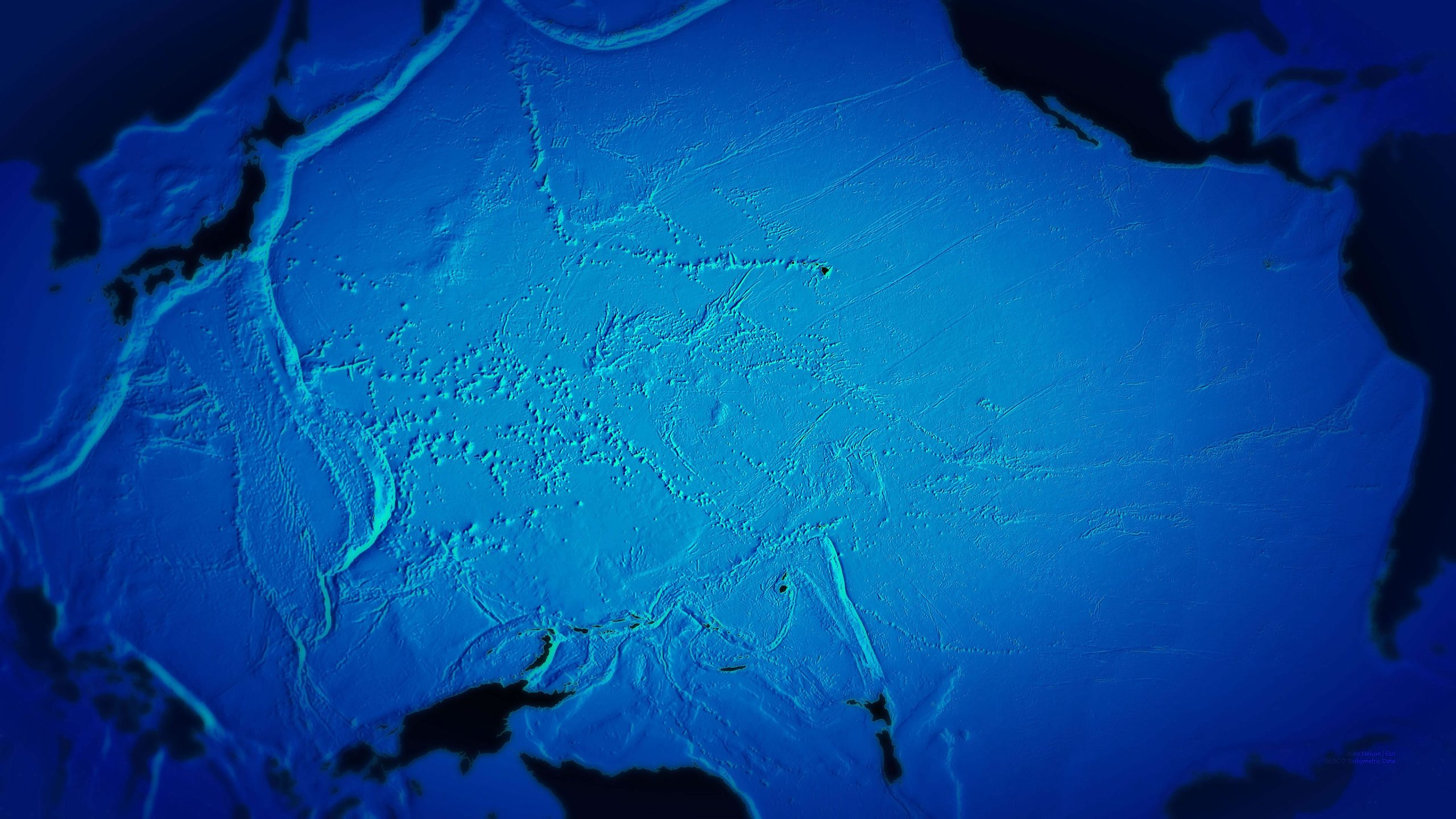

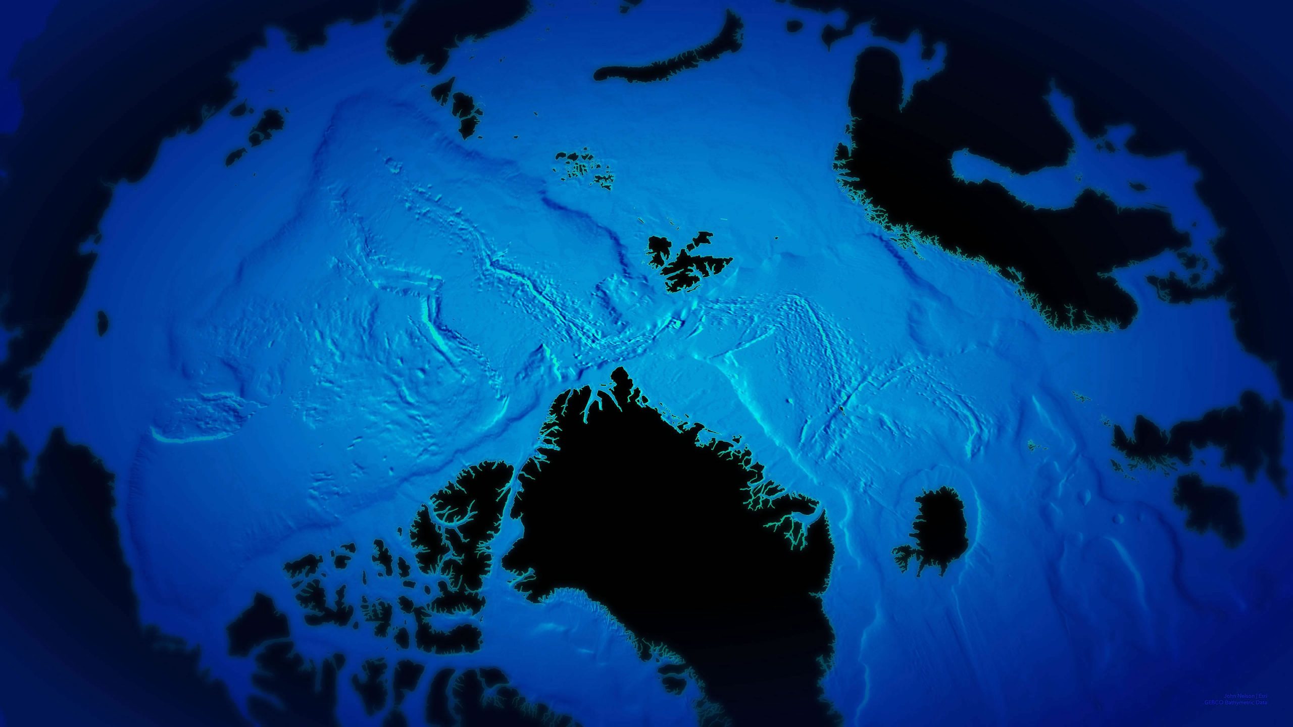

That’s it! Sometimes we wear GIS hats and sometimes we wear graphic designer hats. Sometimes we wear them both at the same time. Glorious hats. Here are some more images from that set that I made. Five backgrounds, one for each ocean. If you’d like to use these as a background for some ocean themed thing you are doing, then certainly have at them. Or, now that you’ve seen how, make your own! It’s unreasonably fun.
![](https://www.esri.com/arcgis-blog/wp-content/uploads/2020/06/OceanGraphicSouthern-scaled.jpg)
![](https://www.esri.com/arcgis-blog/wp-content/uploads/2020/06/OceanGraphicArctic-scaled.jpg)
![](https://www.esri.com/arcgis-blog/wp-content/uploads/2020/06/OceanGraphicPacific-scaled.jpg)
![](https://www.esri.com/arcgis-blog/wp-content/uploads/2020/06/OceanGraphicIndian-scaled.jpg)
![](https://www.esri.com/arcgis-blog/wp-content/uploads/2020/06/OceanGraphicAtlantic-scaled.jpg)
