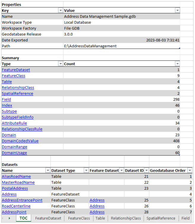

Schema Report
We’re happy to announce that one of the most highly sought-after ideas on the ArcGIS Pro community pages has been implemented in Pro 3.2. We’ve added a new geoprocessing tool that allows you to export the schema of your geodatabase as a report. The tool generates a schema report in multiple formats: JSON, HTML, PDF, and XLSX.
The report contains everything in your data model. Every table, feature class, all the fields, domains, subtypes, controller datasets, attribute rules… everything. You can easily navigate around and see the properties of your data and how things are related using nested links on the pages. Want a holistic overview of the contents of your geodatabase? Generate a schema report.
Here’s a short video overview of the Generate Schema Report tool:
As you can imagine, this has a zillion applicable use cases. From forming the basis of your data dictionary to helping visualize and refine your data models, getting stakeholder buy-in on projects, or being used as project documentation.
Try it out and let us know how you like it. Is there something else you’d like to see in the report? Post it on the community pages and we’ll consider adding it in a future release (I noticed there are some already. That’s good to see).

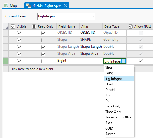

Big Integer fields can be added as expected through geoprocessing tools like Add Field, from the create feature class or table wizard, and from the Data Type dropdown on a new field in Fields view.

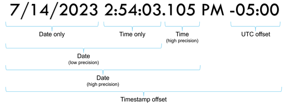

New Date and Time Field Data Types
We’ve also added support for three other new date and time field data types:
- Timestamp offset—Stores date and time values and can include a time zone offset, such as 5/30/2024 11:00:00 AM -06:00.
- Date only—Stores a date value only, such as 1984-03-28.
- Time only—Stores a time value only, such as 11:00 AM.
More accurately keep record of and work with important dates and time with these new field types. I won’t belabor them further as there are already some good blogs about them out there.
High-precision Time
In addition to the new date/time field types, we’ve also added support for high-precision time that can store fractional second values up to the millisecond. You can use the Migrate date field to high precision geoprocessing tool to take advantage of this.

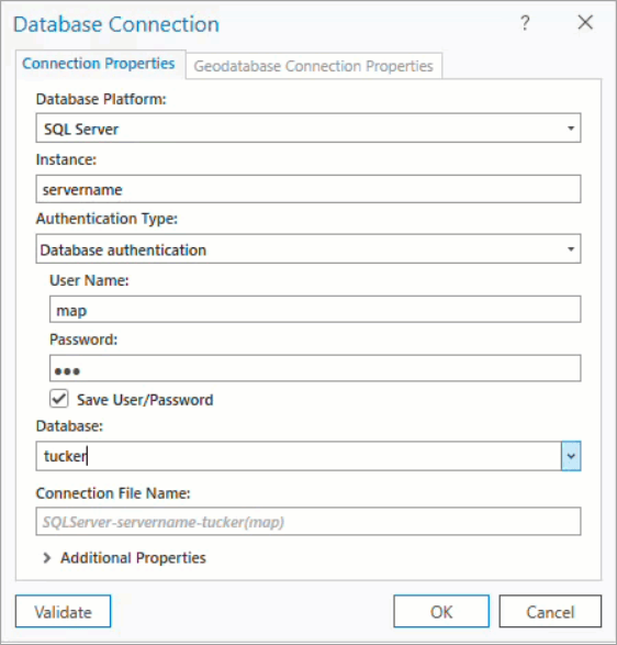

New database connection UI
While we were in there mucking around with cloud data warehouse support, we thought we’d take the time to revamp and improve the Database Connection dialog. We’ve streamlined things a bit and I think you’ll notice two main differences with the new dialog:
- The interface changes depending on which Database Platform you pick from the dropdown. It only shows properties pertinent to the type of RDBMS or cloud data warehouse you are connecting to.
- We’ve added a tab for the Geodatabase Connection Properties too. This should be a nice productivity improvement for people, especially if you want to connect to a specific version or moment in time.
Melissa has put together a blog with more details on the new connection dialog.
