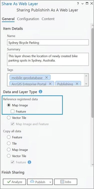

Sharing a web layer that references registered data to ArcGIS Enterprise portal
When choosing this option, the web layer will reference the data from the mobile geodatabase stored in a folder that you registered with your federated server. This sharing option allows any edits made to the mobile geodatabase data to be dynamically displayed in the resulting web layer.
Requirements to share content from ArcGIS Pro:
- Set an active connection to an ArcGIS Enterprise portal and log in to an account that is part of that organization.
- Ensure the account you are connected to has privileges to create, update, and delete content and publish server-based layers.
- Register your data source with ArcGIS Server, by placing the source mobile geodatabase in a folder and then registering that folder with the ArcGIS Server.
Types of layers that can be shared by refencing registered data:
- Map image layer—share your data from ArcGIS Pro as a map image layer to support map visualization and feature querying.
- Vector tile layer— share your data from ArcGIS Pro as a vector tile layer to support fast map visualization using a collection of pre drawn vector tiles.
Output:
- The resultant web layer will reference the data in the registered user managed data store. This means that any edits made to the mobile geodatabase will be reflected in the web layer as well.
- The resultant web layer has read-only access. This means that no edits can be made to the web layer.
Why would you share data by reference from a mobile geodatabase?
If you are working on an ongoing project where the data stored in a mobile geodatabase is dynamically changing and you want to have the most current state of the data available at the ArcGIS Enterprise organization level, you will find the option to share data by reference advantageous. Let’s look at the example below.
The city of Sydney is promoting a go green lifestyle for its residents. The DOT department is actively building new bike parking areas across the city and their sole GIS Specialist is tasked to map the newly created parking areas. Because of that, there is no need for a multiuser editing environment, so having the Bike Parking feature class stored in a mobile geodatabase fits right in. However, the GIS Specialist needs to make the data accessible to the entire DOT department for review.
In this scenario, the best option is to share data by reference. As edits are continuously made by the GIS Specialist directly to the mobile geodatabase, this sharing option will ensure the edits will immediately become available to the web layer. Because the DOT department representatives will only be reviewing and not editing the data, the resulting read-only web layer ensures that no edits can be made.
![Sharing the Sydney Bicycle Parking feature class by reference as a map image layer. Sharing the Sydney Bicycle Parking feature class by reference as a map image layer.](https://www.esri.com/arcgis-blog/wp-content/uploads/2022/07/share-by-reference.jpg)

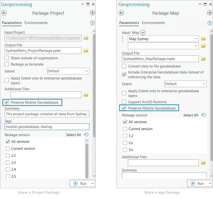

Sharing as package
A package is a compressed file containing GIS data. You share a package in the same way as any other file – via email, FTP (File Transfer Protocol), the cloud, thumb drives, and so on. You can share it between colleagues in a workgroup, between departments in an organization, or with other users via ArcGIS Enterprise or ArcGIS Online.
Prior to this release, when sharing data stored in a mobile geodatabase as a project package or map package, the resultant package converts the mobile geodatabase to a file geodatabase format.
With the ArcGIS Pro 3.0 release, we’ve added the capability to preserve the mobile geodatabase format when sharing as a project package or map package from ArcGIS Pro.
Note: Currently, the option to Preserve mobile geodatabase is available only to the Package Project and Package Map geoprocessing tools.
Output:
- A project package (.ppkx) that saves and shares the project along with its maps, data stored in a mobile geodatabase, styles, toolboxes, tasks, attachments, geoprocessing history, and connections.
- A map package (.mpkx) that contains a map document (.mapx) and all the data referenced by the layers in it. Essentially, the resultant map package is a collection of layer packages along with the map document.
Why would you share data as a package from a mobile geodatabase?
The GIS Specialist working for the DOT department has received an inquiry via email from a contractor working for the City of Sydney. The contractor is interested in finding out what bike parking areas are located within 2 blocks of the stadium, pubs, and other recreation areas. They have requested access to the original data together with the results of the geospatial analysis.
After adding the recreational locations and performing a select by location analysis, the GIS Specialist stored the results in a different map within the same Pro project and shared it as a project package with the save to file option checked. Then added it as an attachment in his email to the contractor.
By choosing to share the bike data and the analysis as a project package, the GIS Specialist was able to include the complete project along with the maps, the reference data, and the folder connections. Because the contractor is not a member of the DOT department, the GIS Specialist was able to share the resultant file as an attachment file via email.
![Sharing the Sydney Metro data stored in a mobile geodatabase as a project package and map package, with the option to preserve the mobile geodatabase enabled. Sharing the Sydney Metro data stored in a mobile geodatabase as a project package and map package, with the option to preserve the mobile geodatabase enabled.](https://www.esri.com/arcgis-blog/wp-content/uploads/2022/07/package-sharing-3.jpg)
