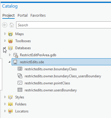

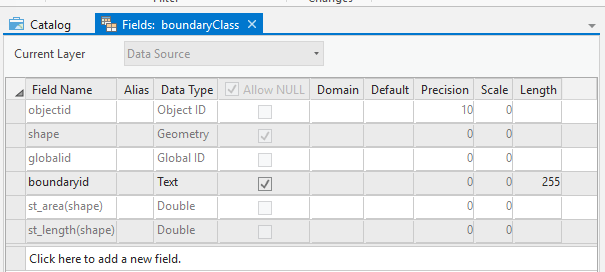

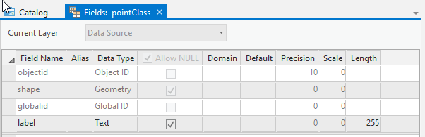

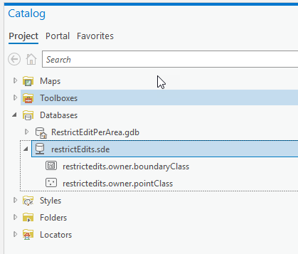

In an Enterprise geodatabase, create the following two feature classes with fields as illustrated.

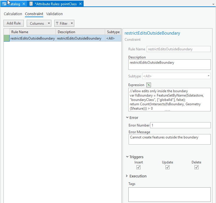

Add a constraint Attribute Rule to the pointClass, make it execute on Insert, Update and Delete then click on save. Use the following script
//allow edits only inside the boundary
var fsBoundary = FeatureSetByName($datastore, "boundaryClass", ["globalId"], false);
return Count(Intersects(fsBoundary, Geometry($feature))) > 0

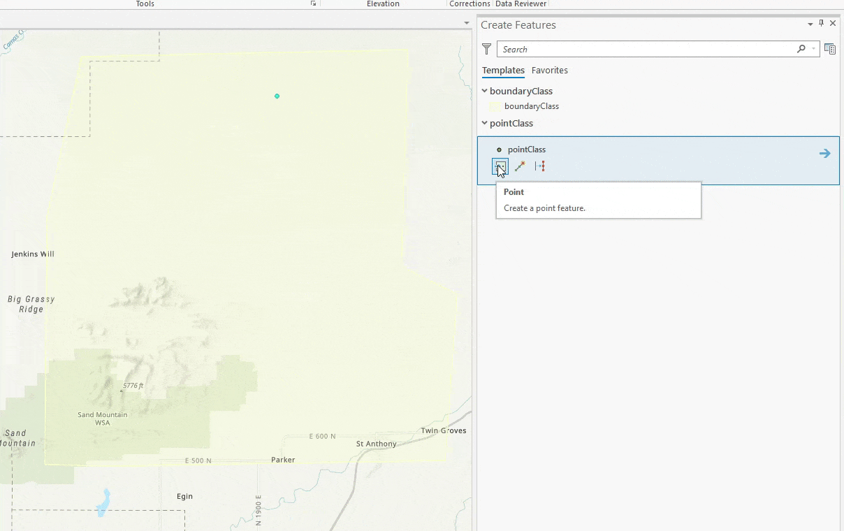

Let us test this out, create a polygon in the boundaryClass and try creating point features outside and inside the boundary.

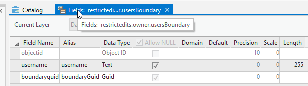

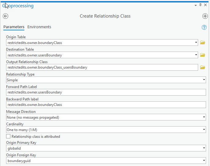

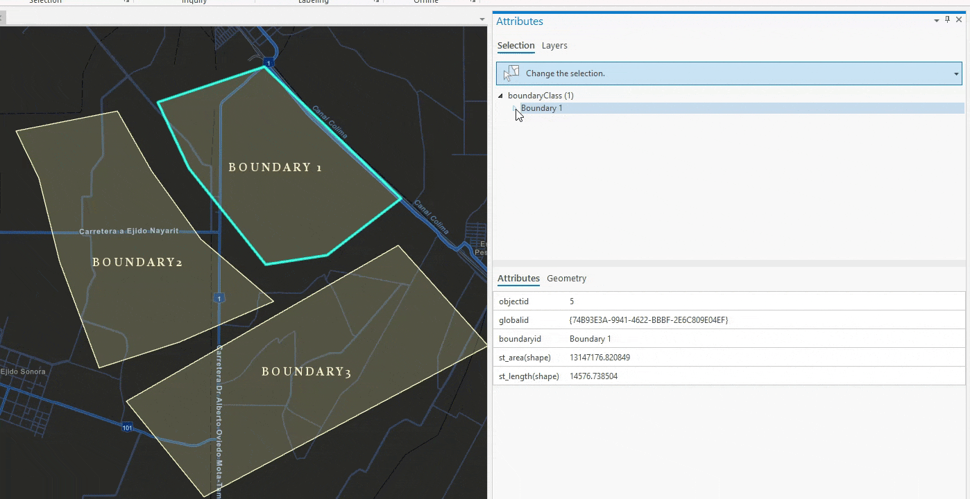

First we will need an extra table that have the users assigned boundaries. Create a usersBoundary table, with a username text field and a boundaryGuid field foreign key to the globalId of the boundaryClass. We will also create a relationship class between the boundaryClass and the usersBoundary table. You don’t have to create the relationship, but it will allow us to assign multiple users to a boundary and will simplify editing the table in Pro.

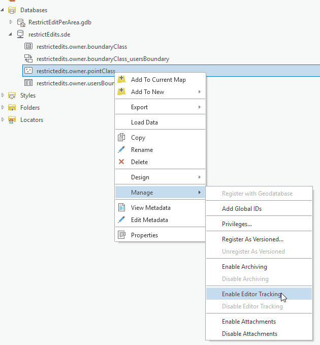

Final thing we need on our pointClass is to enable editor tracking. This is how we can tell what user is actually making the edit on attribute rule by looking at $feature.last_edited_user.

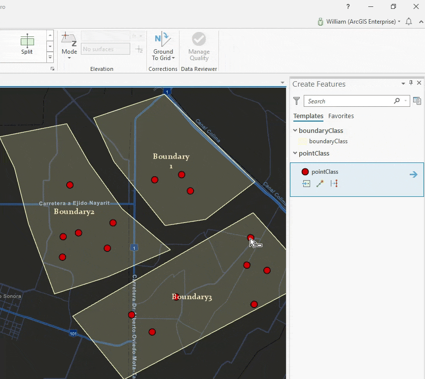

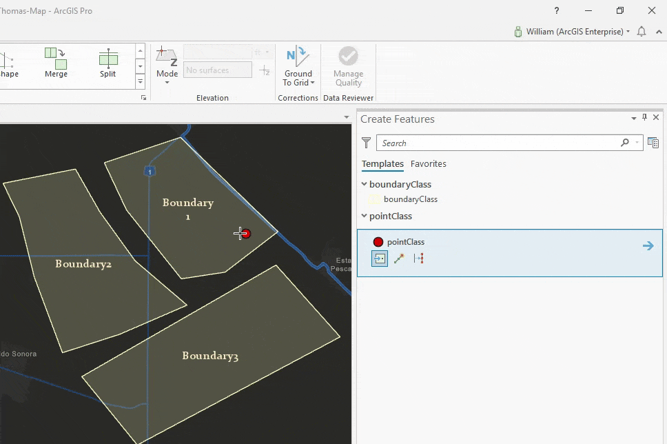

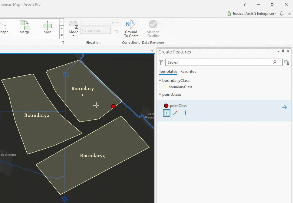

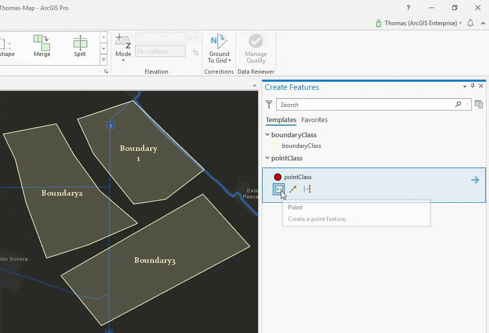

Let us put our attribute rule to the test. If we log in as Jessica, we will only be able to create features on Boundary 1. Attempts to create features on Boundary 2 or 3 will fail.
Similarly, Thomas can only edit features in Boundary 2
Finally, William can only edit features in Boundary 3.
This also applies for deleting features.
