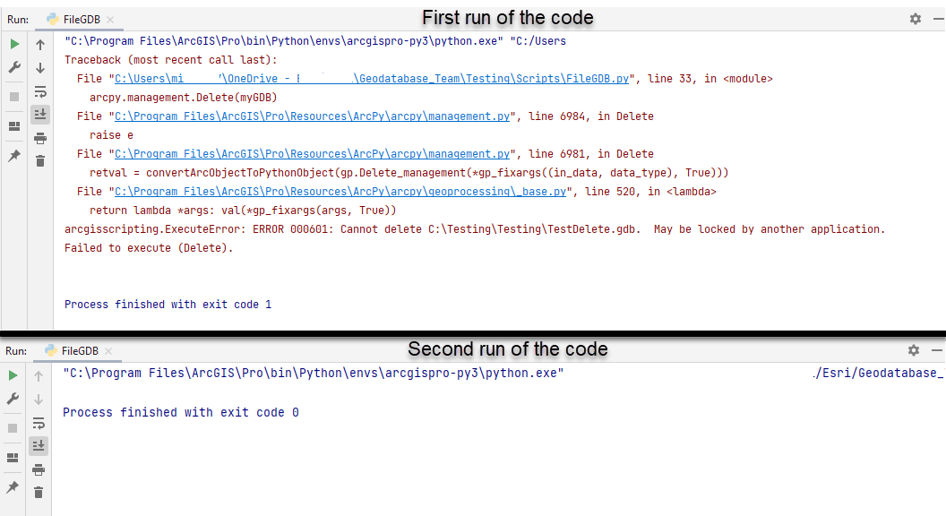

In this example, the code creates a temporary geodatabase, adds schema and data, and then deletes the geodatabase. All appears well until your code attempts to delete the geodatabase, and instead returns the following error: Error 000601: Cannot delete temp.gdb. May be locked by another application.
In addition, we wrote the code so that a second run will only attempt to delete the temporary geodatabase. You run the code again, and this time it deletes the geodatabase without error?
Illustration of code shows the error of locked by another application on first run and no error on second execution.
Unlike similar workflows that generate this error (such as, other users accessing the data), this scenario is using a temporary geodatabase. No other users are connected to it. Why did the error happen in the first place? How do we write the code to prevent this peculiar locking error from occurring when deleting the geodatabase?

This code will generate the above locking error the first time it runs.
Run it again, and it now properly deletes the geodatabase.
