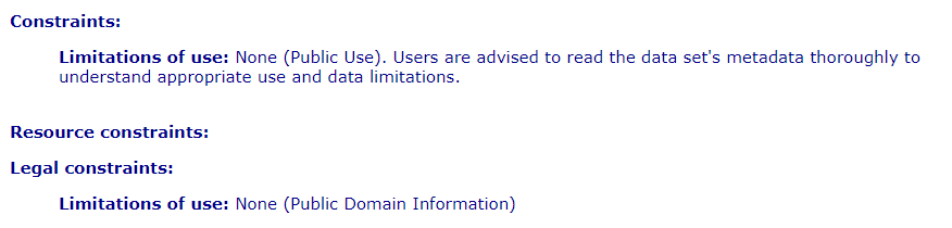

Click on View Metadata and look for information on terms of use. Under Constraints, you are able to confirm that the dataset is in the public domain, and it would be permissible to use it in your analysis.

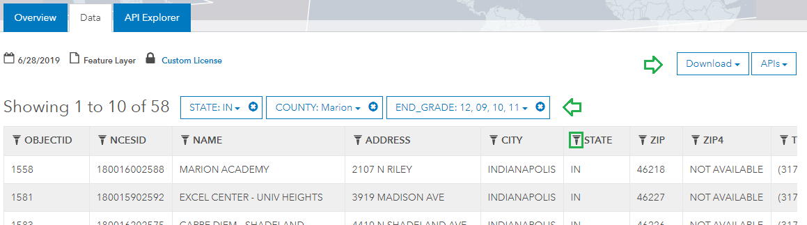

Next, on the Data tab, use the filter buttons in the column headers to filter the dataset to only include schools in Marion County, IN that teach students Grades 9 through 12. This will be the preliminary list of high schools your promotion needs to cover. Download the filtered dataset as a shapefile.

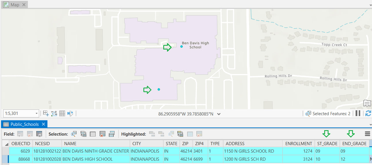

Next, you will examine the data. In ArcGIS Pro, add the shapefile to a map, and open its attribute table. Sort the schools in descending order of address. Of the total 58 high schools, notice that some of the schools are located extremely close to others. Use the select tool to select one such cluster on the map. You can tell that it has 3 schools, as 3 records get selected in the attribute table.
![](https://www.esri.com/arcgis-blog/wp-content/uploads/2020/02/Image5.png)
One of those schools is named “Area 31 Career & Tech Center” and has an enrollment of 0. Clearly, it is not a high school, and apparently a case of the facility being used as a career and tech center (presumably after school hours). Delete this location from the list.
The other two are “Ben Davis High School” and “Ben Davis Ninth Grade Center”. From the Start Grade and End Grade columns, it is evident that the Ninth Grade Center serves only Ninth Grade students and the High School serves Grades 10 through 12. From the map, it appears that they are part of the same facility or school building.

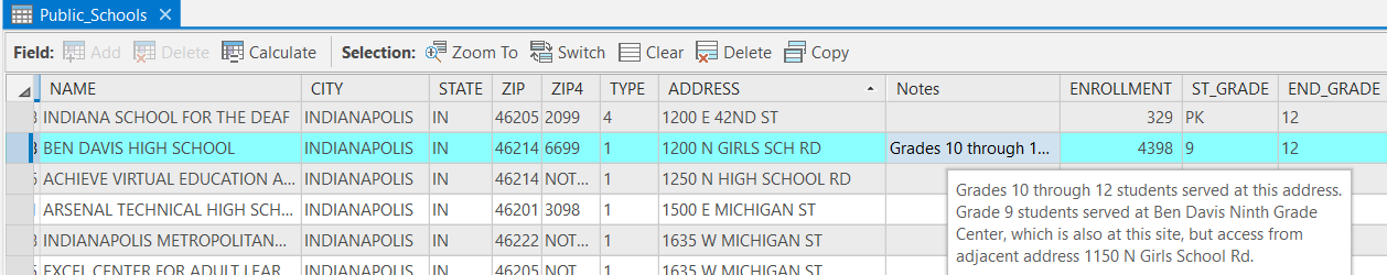

Since you need school locations to plan direct outreach and marketing, it makes sense to treat this as one single location high school that needs to be covered, rather than two. Merge the Ninth grade center with the high school using these steps:
- Add the Ninth Grade Center enrollment to the High School enrollment figure.
- Add an attribute to the table for “Notes” and add a Note to ensure the Ninth Grade Center is not overlooked.
- Delete the Ninth Grade Center record.

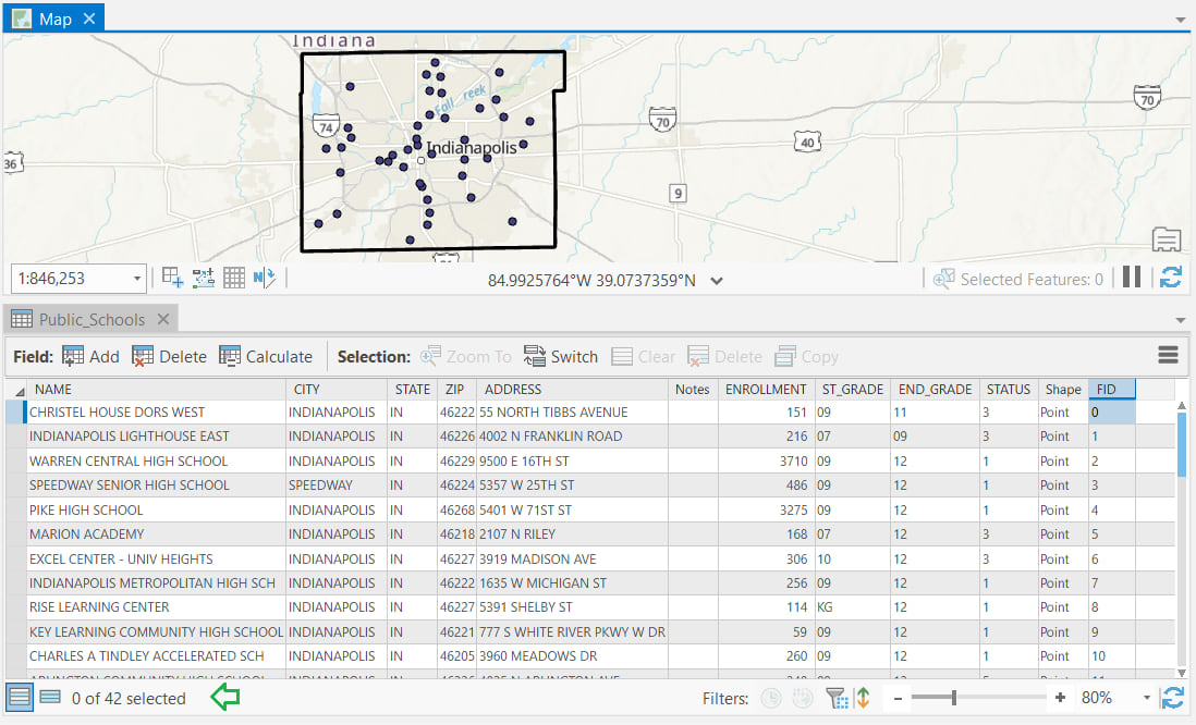

After these data cleanup steps are complete, the dataset has 42 high school sites.
![](https://www.esri.com/arcgis-blog/wp-content/uploads/2020/02/Image8.png)
