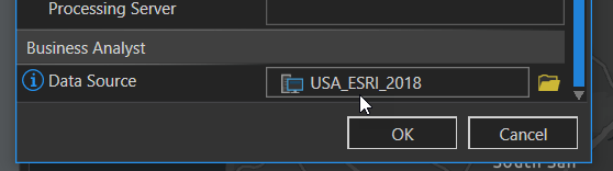

(1) Set the Data Source – point to your locally installed Business Analyst Data Source. In ArcGIS Pro, navigate to Analysis > Environments > Data Source > then find your most currently installed dataset. Here I show the 2018 Dataset selected, I could also point to ArcGIS Online or my Organization’s Portal.

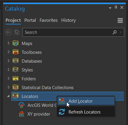

(2) Add the Locator – Add the locator to ArcGIS Pro via the Catalog pane. Once you do this, the locator will be readily available in any Input Locator menu.

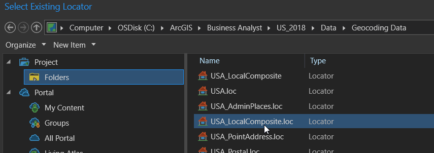

(3) Navigate to C:\ArcGIS\Business Analyst\US_2018\Data\Geocoding Data – and add the file called: USA_LocalComposite.loc
