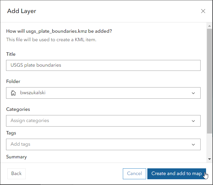

Step 2 — In the Add Layer pane, click Your device and browse for the KML file, or drag and drop the KML onto the pane.
Step 3 — A KML item will be created and added to your map. Specify the title, summary, tags, and other information for the layer.
When finished, click Create and add to map.

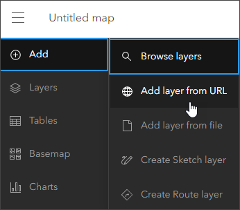

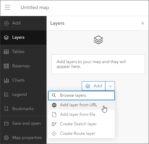

Step 1 — Sign in to your ArcGIS account and open Map Viewer. There are two ways to add URL-based files as layers from the Contents (dark) toolbar.
(1) Click Add, then Add layer from URL.
(2) From the Layers pane, choose Add layer from URL from the Add drop-down list.

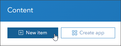

Add a KML item using New item
The steps above outline how to add a KML directly in Map Viewer. Another way to add KML is via New item in My Content.

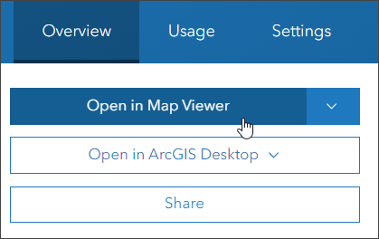

The steps are the same as described above. After adding the KML using New item, a new KML item is created for both file and URL-based KML. The KML can be opened in Map Viewer by choosing Open in Map Viewer from the Overview tab in the KML item pages.
