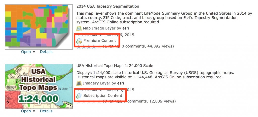

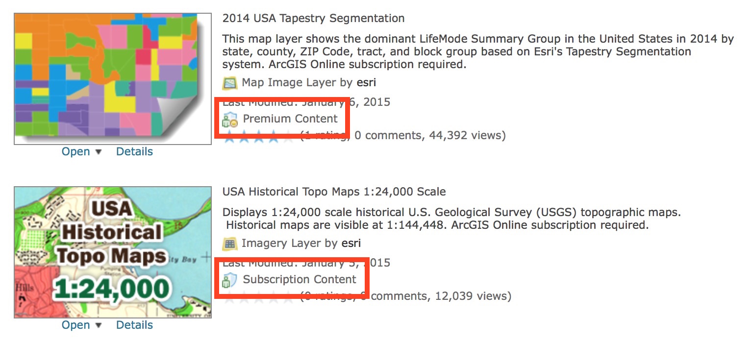

Esri’s Living Atlas of the World provides an amazing source of information for you to create maps and mashups, publish apps, and perform geographic analysis. Most of the layers in the Atlas are free to use, but some high-quality layers published by Esri’s Content Team are designated as subscriber content. Some subscriber content layers are also considered premium content.
The ArcGIS Online FAQ has detailed explanations of these two terms, but essentially both types of content require an organizational subscription, while premium content also consumes credits when it’s accessed.
The item listings are marked as shown below if they fall into one of these categories.

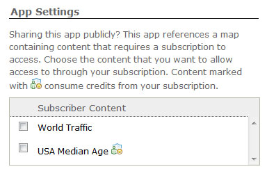

Enabling subscriber content in a configurable web app
When you publish a web map with subscriber content to one of ArcGIS Online’s configurable web applications you’ll see a new section in the app’s configuration panel that lets you enable public viewers to access that content via your subscription. Premium layers accessed by public viewers will consume credits from your organization’s subscription.

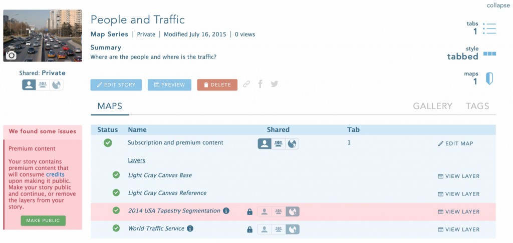

If you need to provide public access to subscriber content in a Story Map go to the My Stories section of the Story Maps website, log into your ArcGIS Online organizational account, and click the app to run the story inspector. My Stories will detect both types of subscriber content and alert you if you need to authorize it’s use by public viewers of your app. Simply click the green button that says “Make Public” and the layers will be made available. (If you haven’t heard of My Stories yet learn more about this new Story Map management tool here.)
If your Story Map is already public you’ll be alerted to the presence of both subscription and premium content and can confirm your intention to allow public viewers to see both types of layers.
If your Story Map is still private you can use the tools in My Stories to make it public. In this case the subscription content will be automatically made public (since it does not use credits), but you’ll still need to confirm the availability of the premium content.

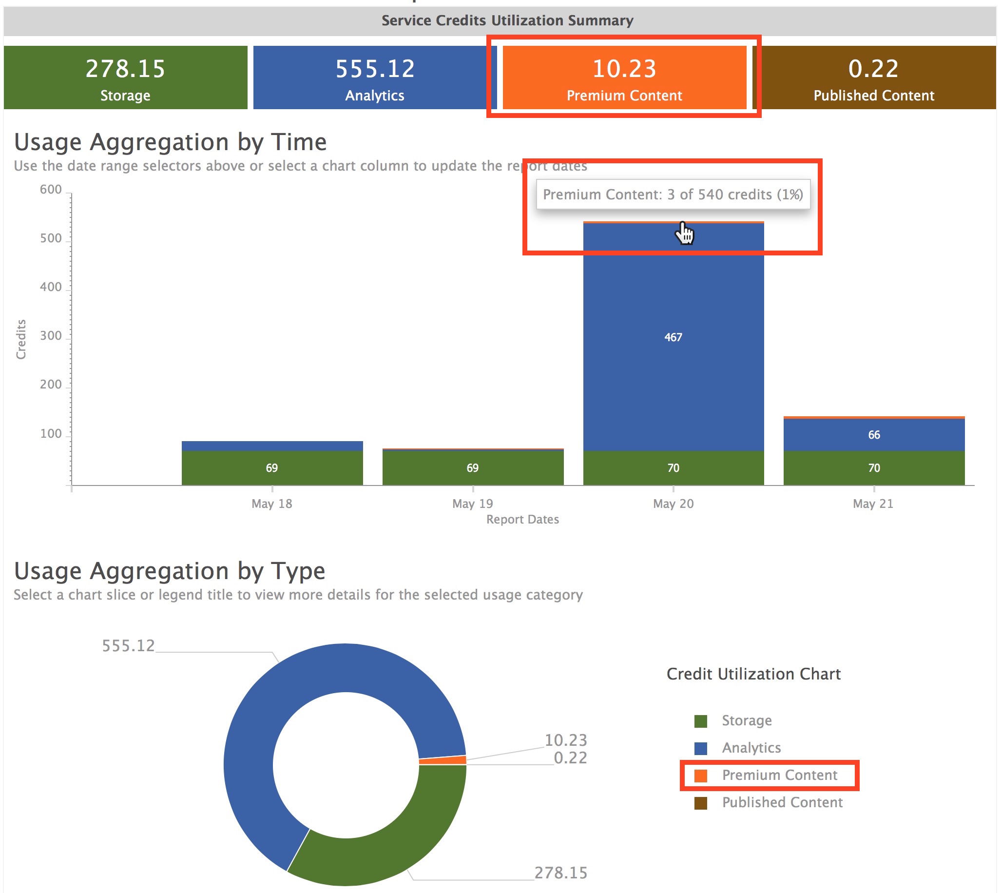

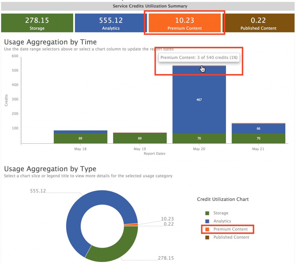

Credit usage for proxied premium layers is reported at the organizational level along with usage by your organization’s members in My Organization > View Status > Credits.
