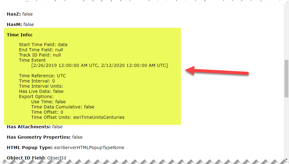

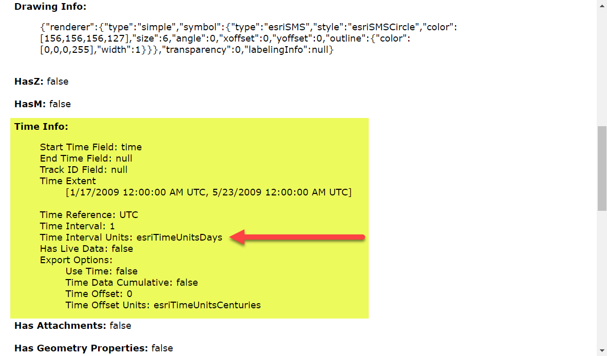

If you take a look at a layers REST you can learn more about the associated settings.
Here is an example layer with time enabled: Elephant Seal Track Points
Service Description Time Settings
REST Time Properties
While examining the layer’s REST, notice that the time is enabled and the “Time Interval Units” are defined. When this layer is added to a map a time slider with the associated interval of a single day is made available by default.

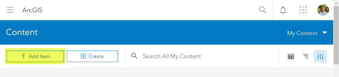

1. From your content page in ArcGIS Online. Click on the “Add Item”
AGOL Add Item
Add Item in ArcGIS Online

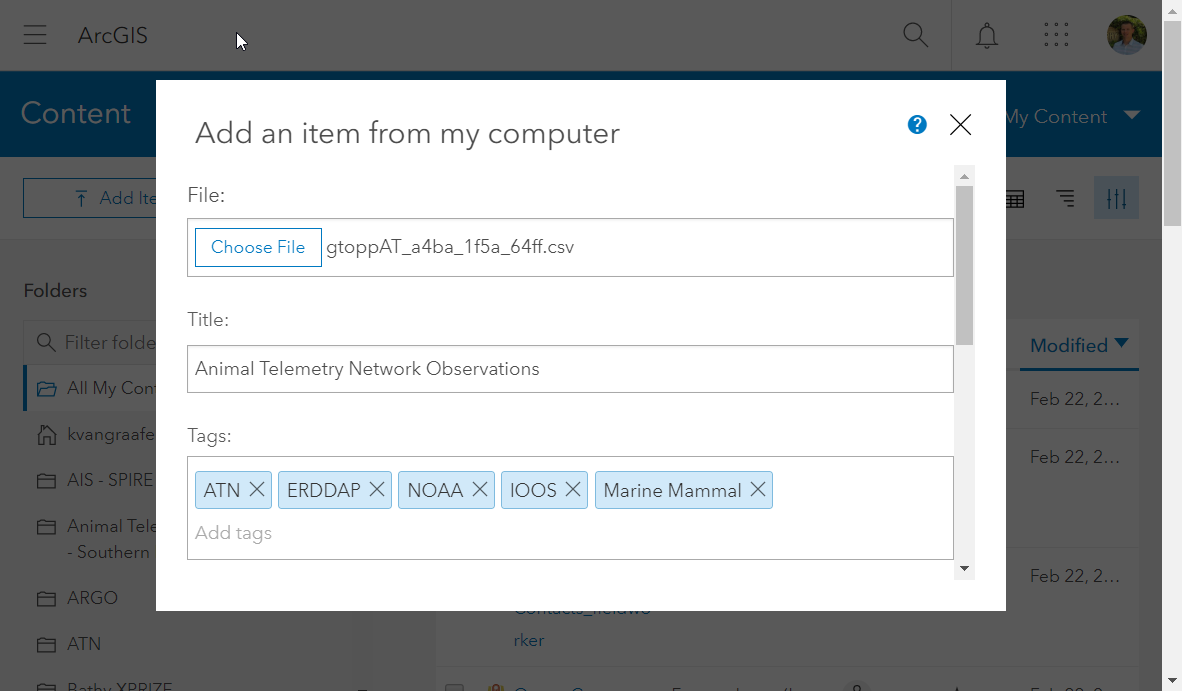

2. Upload the file from “my computer”. Use the following recommended name and tags.
Item Info
Item Info

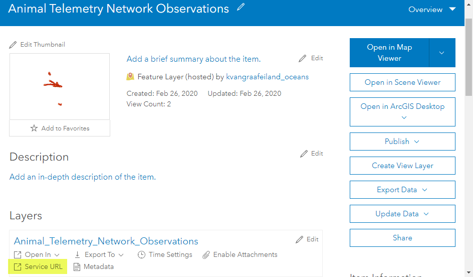

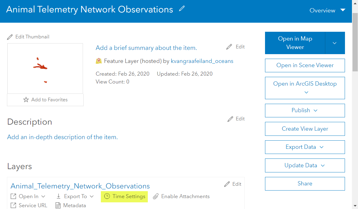

5. When publishing is complete you should be brought to the content item page of the newly published layer (below).
Service URL
Content Item Service URL

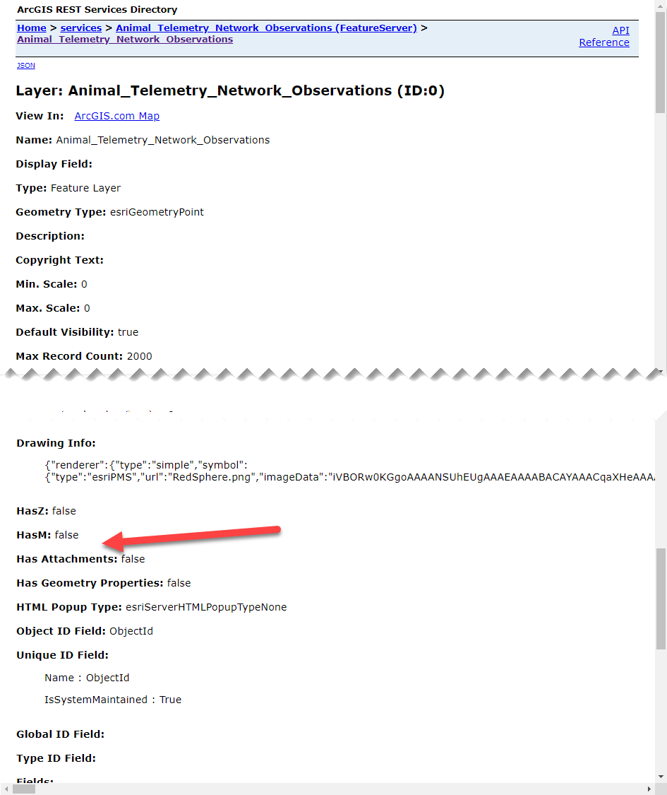

6. Navigate to the Service URL and click on it. This will launch the REST in a new window.
REST Time Properties disabled
7. Scroll down and notice there are no time properties listed. Note: these properties would normally show up after “HasM:“.

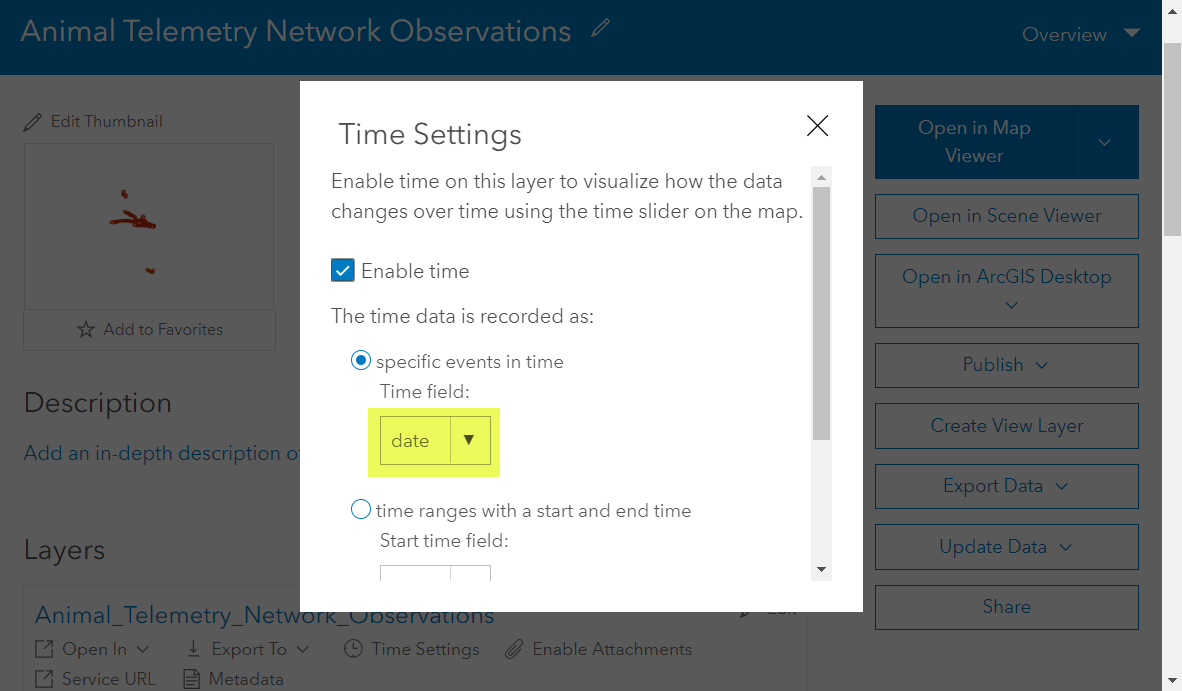

8. Now let’s enable time by navigating to the time settings of the layer and modifying the time settings by clicking on “Time Settings”.
9. Check the box that says “Enable Time” and select the “date” field as the Time Field.
Time settings on your layer

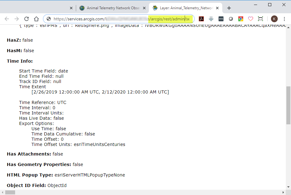

10. Now time is enabled on the layer and we can verify by inspecting the service URL.
Time enabled
Time enabled
11. Notice the time properties are now enabled but the interval and units are not set. When this layer is added to a Map it tries to automatically select the time slider range; and it is often incorrect. To avoid these you can configure the interval and units through the ArcGIS Online Admin console.
12. Since you are already at the service URL – you can modify the URL by adding “admin/” between “rest/” and “services”
Admin console
Admin console

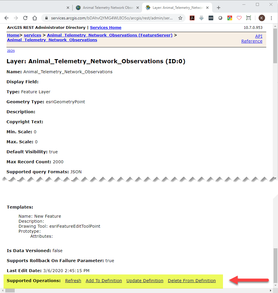

13. This will bring you to the “admin console” for your layer. Here you can modify the time settings. The admin console presents the data in the same fashion as the Service URL but has some key features located at the bottom of the page that let you refresh, add, update, or delete from the definition. As long as you are the owner of the item you should be able to make use of these settings.
Admin console operations

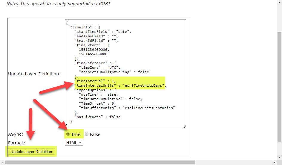

14. Use “Update Definition” to modify the time interval and units.
15. This brings up the Update Layer Definition interface where the service properties are listed. It’s important to note that since we are only modifying/updating the time properties, those are the only properties that should be referenced in the definition (remove everything else not associated with time from the definition).
Time Definition
Time Definition
16. The Service Definition timeInfo settings (above) modified to “timeInterval”: 1 and “timeIntervalUnits”: “esriTimeUnitsDays”.
17. Now when the layer is added to the map the time slider settings represent the proper range for the data.
