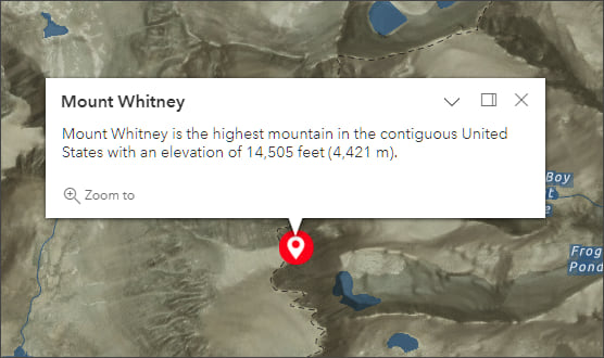

Add a marker with a pop-up
&Marker uses the following properties. To skip a property use double semicolons (;;). The marker properties must be in this order: &marker=<x>,<y>,<WKID>,<title>,<symbol URL>,<text>. Click the marker to view the pop-up.
- <x coordinate>,<y coordinate>—The location for the marker.
- <WKID>—Spatial reference of the x,y coordinates to be added to the map. If you do not include a WKID, GCS coordinates are used.
- <title>—Pop-up title. If you do not include a title, the pop-up will be empty.
- <symbol URL>—Symbol for the point. If you do not include a symbol, a black circle marker symbol is used.
- <text>—Text to include in the pop-up.
Add a marker with pop-up and specify a zoom level
Add &level to the URL above. Click the marker to view the pop-up.

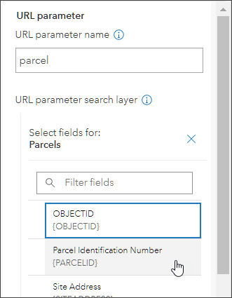

Step 2 – Configure the custom URL parameter.
2a – Enter the parameter name. In this case the parameter will be used to locate a specific parcel using its parcel identification number. The parameter name will be parcel.
2b – Select the layer to use in the parameter (Parcels is the only layer in the map).
2c – Select Field to display all fields in the layer.
![Custom URL parameter Custom URL parameter](https://www.esri.com/arcgis-blog/wp-content/uploads/2015/08/urlpa-6.png)
2d – From the fields drop-down, select Parcel Identification Number.
![Custom URL parameter Custom URL parameter](https://www.esri.com/arcgis-blog/wp-content/uploads/2015/08/urlpa-7.png)

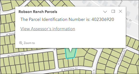

The above settings support a new URL parameter (parcel) that takes the unique parcel identification number as the value. Examples of its use follow.
Find a parcel using the parcel identification number and view the pop-up:
Find a parcel using the parcel identification number and view the pop-up, also adjust the zoom level:
![Locate parcel using custom URL parameter Locate parcel using custom URL parameter](https://www.esri.com/arcgis-blog/wp-content/uploads/2015/08/urlpa-8.png)
