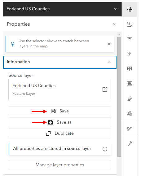

If you own (or have the necessary privileges to manage) a layer item, you can save changes to it. Additionally, you have the option to save a feature layer as a new layer. This will create a new layer item that references the same source layer as the original layer. The layer’s property configuration, including any modifications you’ve made, are saved with the new layer. The current map will now use the newly created layer as the source for the layer in your map.
Both Save and Save as are available from the Properties pane on the light toolbar for feature layers, tables, and route layers.

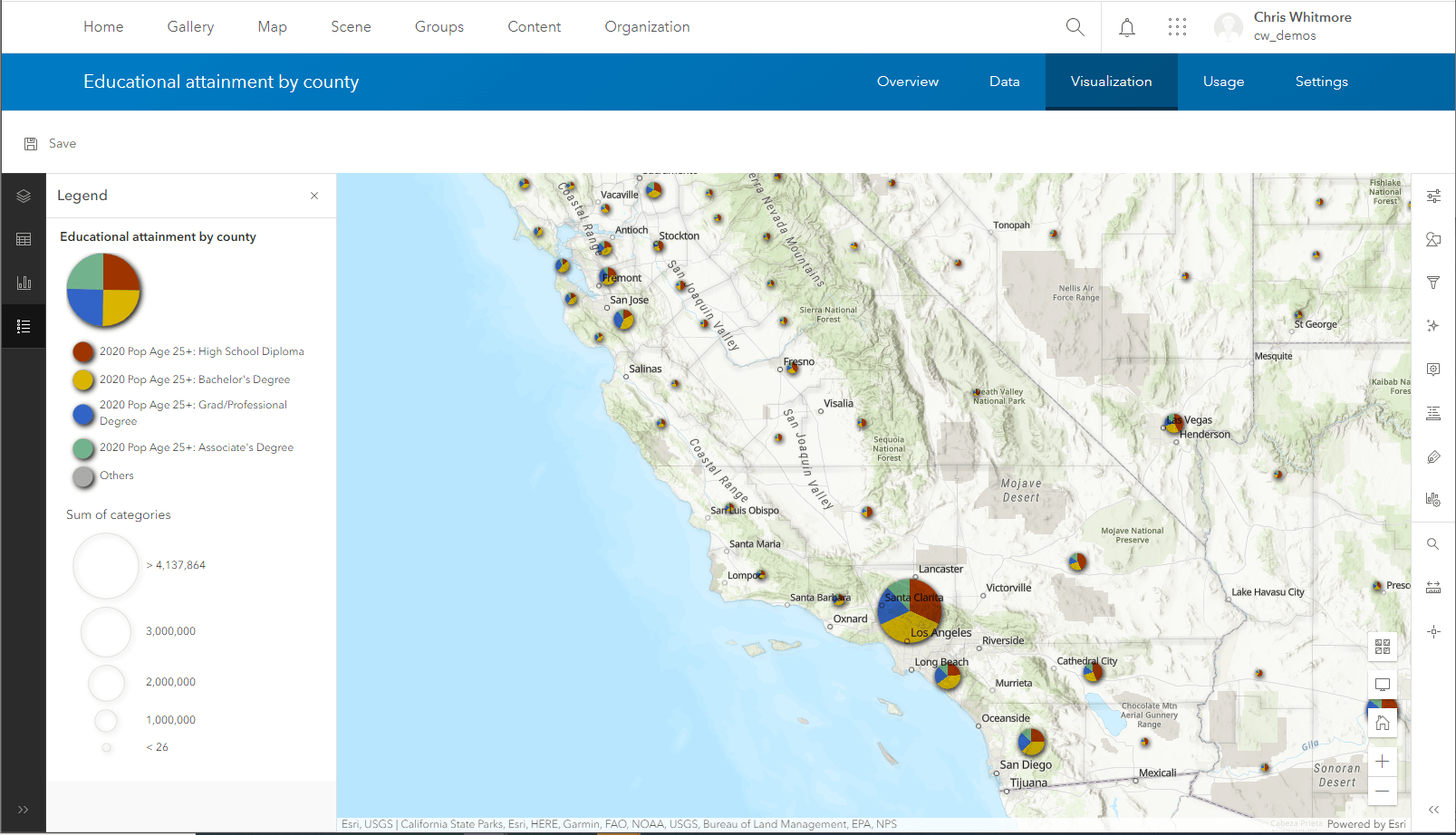

Enhanced Visualization
The item page for feature layers now offers an upgraded visualization experience. The Visualization tab provides a focused viewing and configuration environment for feature layers. Similar to saving feature layers in Map Viewer, you can configure and save pop-ups, effects, charts, multi-class labels and more from the Visualization tab.

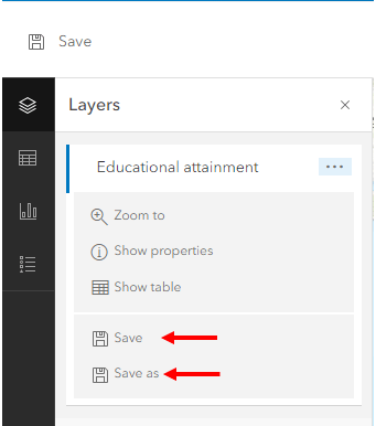

In addition to the overall Save option found above the map on the Visualization tab, each layer includes the ability to save changes to the existing layer. The ability to save layers individually is useful when the feature layer contains multiple layers; each layer can be saved individually or use the overall Save option to save everything at once. Additionally, you can use the Save as option to create multiple visualizations of the same source layer.
Don’t see the updated Visualization tab? Update your primary map viewer settings to use Map Viewer instead of Map Viewer Classic.
