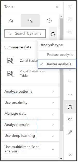

In this blog, you’ll learn tips to use raster analysis tools in ArcGIS Online effectively to create the desired output and use credits wisely. Raster analysis in ArcGIS Online has been available through Map Viewer Classic for a while. However, you can access those same raster analysis tools in Map Viewer with more capabilities and enhanced user experience? A previous blog article announced that raster analysis tools have been added to Map Viewer and can now be used to take advantage of the processing power in ArcGIS Online. Through raster functions, you can also access more functionality to create a visualization or process imagery layers with raster function templates. Raster analysis in ArcGIS Online requires imagery layers to power the analysis in ArcGIS Online. As in many of the geoprocessing tools in ArcGIS, tips and techniques can help you are generate the desired output.

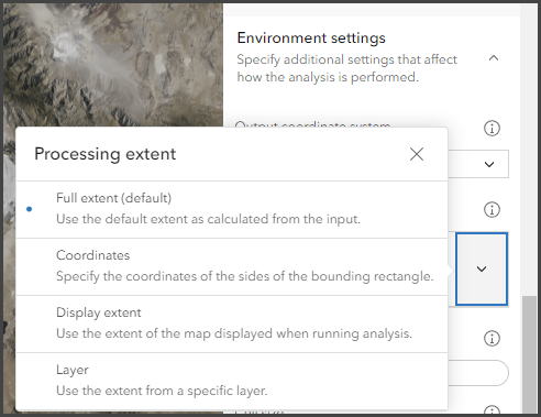

Limit the extent of your analysis
When using any tool in ArcGIS, to generate the output you want in the most efficient and economical way, processing only the area that you are interested in analyzing is essential. In Map Viewer, this also means limiting the number of credits that will be used for each tool run in addition to performance speed by controlling the area analyzed. The Processing extent of any tool can be changed in the Analysis settings or Environment settings of the tool.
By default, the Full extent is chosen for all tools for the Processing extent. It is recommended that you change it to Display extent in the Analysis settings. By changing this setting, you are limiting the analysis extent to what is visible in the webmap. Analysis tools in Map Viewer Classic used the display extent by default, so this setting returns Map Viewer tools to the processing experience of Map Viewer Classic and prevents analyzing the full extent of the input layer. This setting is vital when you are using input layers from ArcGIS Living Atlas of the World. By default in Map Viewer, the tools will use the spatial extent of the entire input layer not just the visible area in the map when the raster analysis tool or function is opened. If the display extent is not what you are interested in, you can also choose another layer or manually input coordinates. If you ignore every other environment setting, pay attention to this one before running your analysis.

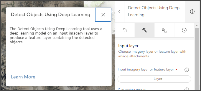

Learn more
There are many raster analysis tools available in Map Viewer, so you may not be aware of all the capabilities of each tool. Click the Learn more link available in tool description to read about a tool’s capabilities. The link will take you to the web help for that raster tool or function, where you can learn more about the input data, the parameters, output data, and any environment settings available for that tool.
