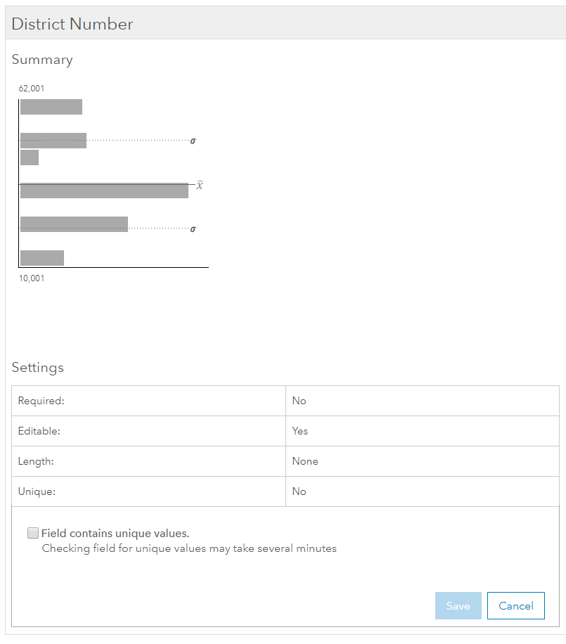

Many of you have your own ID fields that are unique and reflect the naming standards within your organization—for example, an Electoral District, Parcel ID, Asset ID, or anything that uniquely identifies the feature . Now you can use that field as the match field when updating existing data. To take advantage of this feature, you first need to enable the setting on the field to verify that the existing data for that field in the layer is unique.
To enable this start from the layer’s item page, go to the Data tab, click on the field you want to use as a unique ID, and choose Show Field Details View. Under Settings, you’ll see an option to set the field as unique. Depending on the size of your data, it may take some time to validate that the existing data is unique. If the validation fails, take a moment to review the field to make sure there are no duplicate values.
![](https://www.esri.com/arcgis-blog/wp-content/uploads/2018/04/2018-04-16-08_13_51-federalresults.png)
Once the field passes validation, it will be available to use as the match field anytime you choose to update existing features. This option should make it easier to integrate data updates coming from external databases where it can be difficult to maintain ObjectID or GlobalID fields from your GIS.

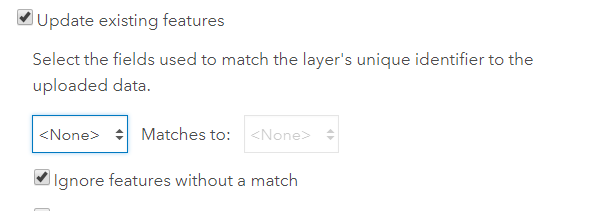

With this release, it’s also easier to only update the attributes for your existing features. If the data you upload contains more features than what matches to your feature layer, you can choose Skip features without a match so that any data in the uploaded file that doesn’t match to a feature in the layer is ignored. If you happen to upload data that has a different geometry type than the feature layer, rather than preventing you from going further, the Append workflow will now let you do an attribute-only update to existing features.
