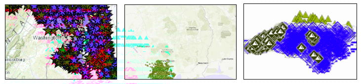

First impressions are important—whether it’s during a job interview, a first meeting with a prospective client, or when you visit a company website. While you shouldn’t necessarily judge a book by its cover, people are visually oriented and what we see affects our perception of not only what interests us, but also forms an impression of what’s beyond the visual. Which leads to the question: Why have thumbnails like these as the first impression of your map?
The thumbnails above are examples from publicly shared maps, and while the maps behind them might be finely crafted examples of online mapping excellence, the first impression sets a lower expectation.

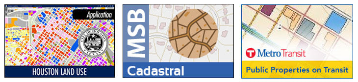

In contrast, the thumbnails below show professionalism, and indicate that the maps they represent are authoritative, curated, and of high quality.

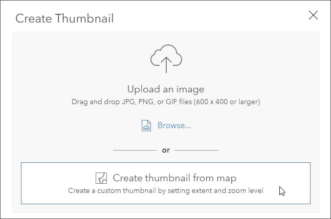

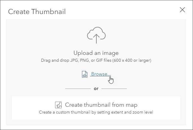

There are two ways to create a better thumbnail; create a thumbnail from the map, or create your own custom thumbnail image and upload it. Both options are available when you click Edit Thumbnail on the item overview.
Create a thumbnail from a map
To create a better thumbnail using a map, follow these steps.
Step 1 – Click Edit thumbnail on the item Overview.
Step 2 – Choose Create thumbnail from map.

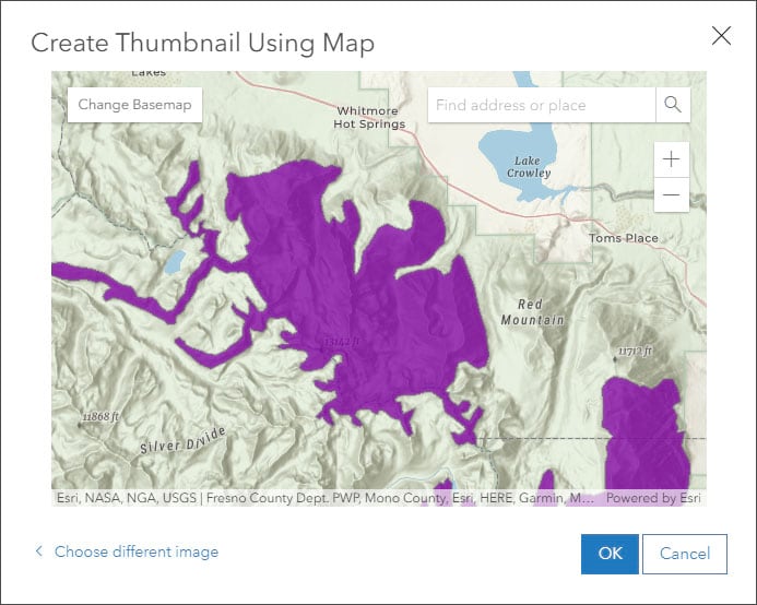

Step 3 – Zoom and pan to adjust the map to create a better thumbnail. The basemap can also be changed. Click OK when finished.
Our new, and improved, thumbnail now looks like this:
Create a thumbnail by uploading an image
Another way to create a better thumbnail is to upload an image. You can use a photo, or any graphic, to create a more interesting and informative thumbnail. The image must be a minimum of 600 x 400 px.
Tip: For best results, your image should be a PNG file.
To use an image, follow these steps.
Step 1 – Create a graphic, capture a photo, or otherwise obtain the image. It could be a photo from your camera, from the web, or anything you create in Photoshop, Paint, or other image editing programs.
Step 2 – Click Edit thumbnail on the item Overview.
Step 3 – Click Browse… to upload an image.
Step 4 – Browse for the image, and open it.

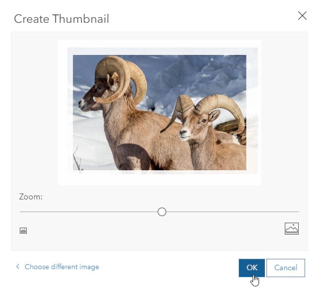

Step 5 – Adjust the zoom and positioning of the image in the Create Thumbnail panel. Click OK when finished.
Here’s our updated thumbnail, an improvement over the default.

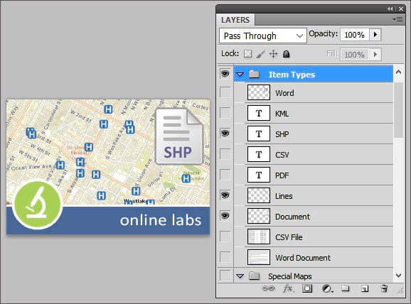

You can create and use a template using your choice of graphic programs to make it easier to create custom thumbnails. These templates can contain your key graphic elements.
When you create a new thumbnail, you can toggle the visibility of your elements as desired. Below is an example of a Photoshop template (PSD file) for creating thumbnails. The organization banner and logo are at the bottom, and the file type is positioned in the top right. Once the background for the thumbnail has been added, these can be toggled on to be saved in the thumbnail. A wide variety of programs, including free software and web utilities, provide alternatives to Photoshop.
When creating a thumbnail, saving it as a PNG file generally delivers the best results in terms of crispness of your image at a variety of sizes. The standard thumbnail size is 600 x 400 px (technically, and to be exact – 600 x 399 px), however anything larger can be fit as desired.
