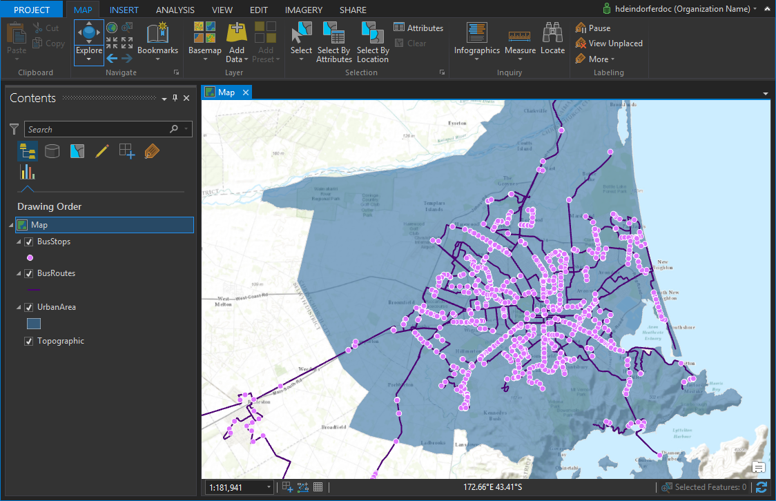

Map in ArcGIS Pro
This is my map of Christchurch bus stops and routes in ArcGIS Pro.

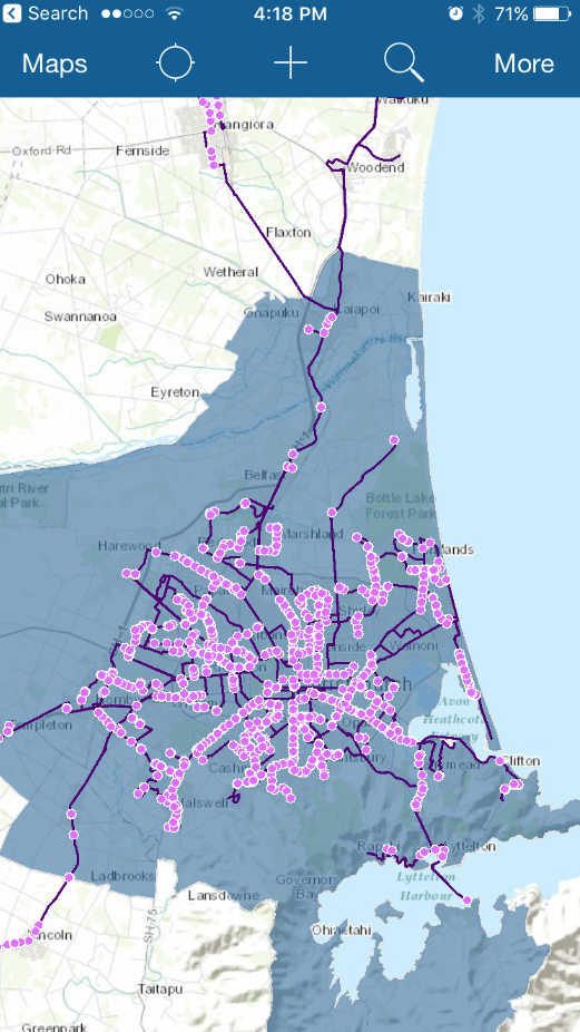

Map in Collector for ArcGIS
This is the same map in the mobile app, Collector for ArcGIS.

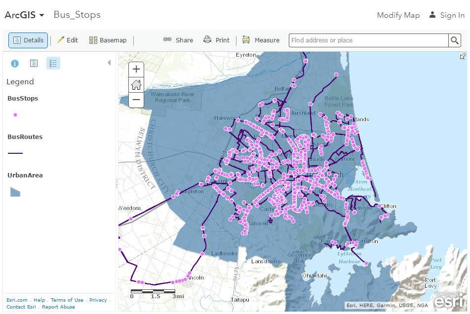

Map in the ArcGIS Online map viewer.
This is the same map in the ArcGIS Online map viewer.

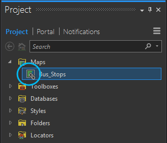

In the Project pane, the icon shows that your map is linked to the original web map or scene in your portal.
Linked web map in ArcGIS Pro
On the Project tab of the Project pane, you can find items that you add to your project. This is where I can see my linked web map.

For example, suppose I’m an engineer who coordinates public transportation in New Zealand. Here, I have a map of the bus stops and routes in Christchurch in ArcGIS Pro.
Map of bus routes and stops in ArcGIS Pro
My map of bus stops and routes in ArcGIS Pro.
One of my colleagues is planning the addition of a new bus route in Diamond Harbour, on the other end of the ferry line, and uses the ArcGIS Online map viewer to add this route to the web map.
Edited map in ArcGIS Online map viewer
The new bus route is added to the map in ArcGIS Online.

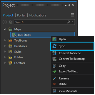

So, I right-click my linked map and click Sync.
Right-click the map and click Sync.
On the Project tab of the Project pane, right-click the map and click Sync.

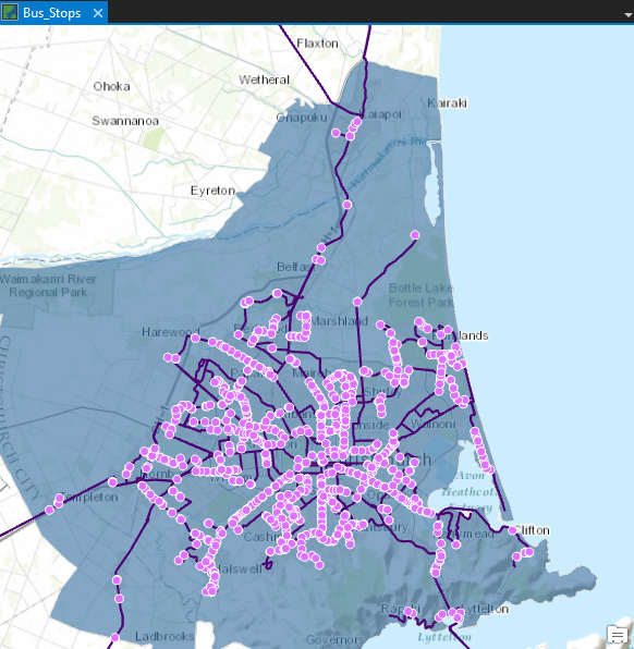

My map updates with the most recent saved web version, and now shows my colleague’s edits.
Before and after Sync
The left image shows my map before Sync and the right image shows the map after Sync, updated with my colleague’s new bus route.

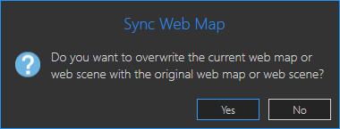

I have to be careful, though, because any changes I made to the version of the map in my ArcGIS Pro project will be overwritten when I sync with my colleague’s version of the map.
Sync Web Map warning
ArcGIS Pro warns you that your map will be overwritten with the latest version of the web map when you Sync.
