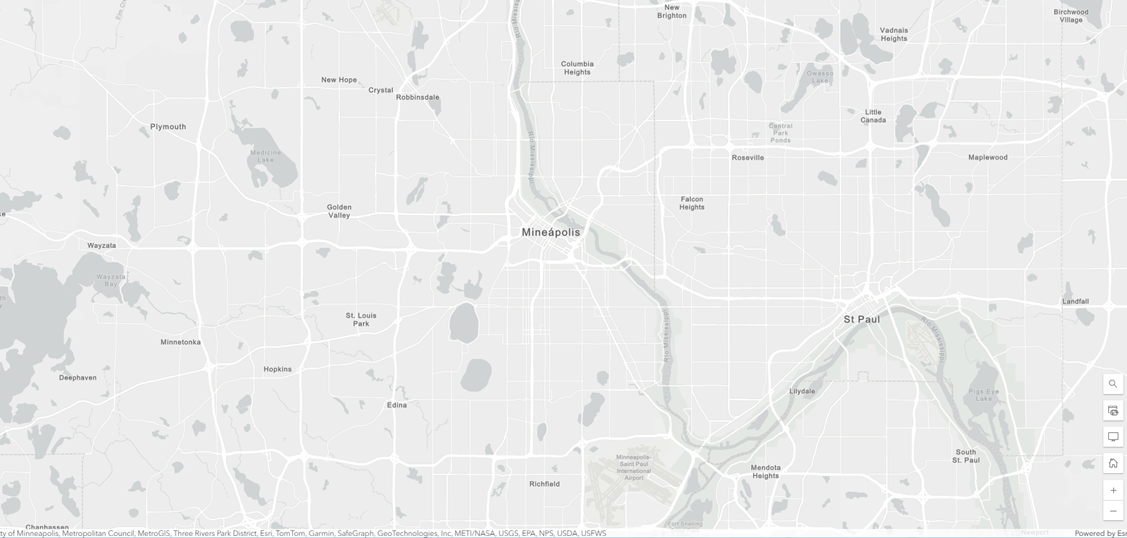

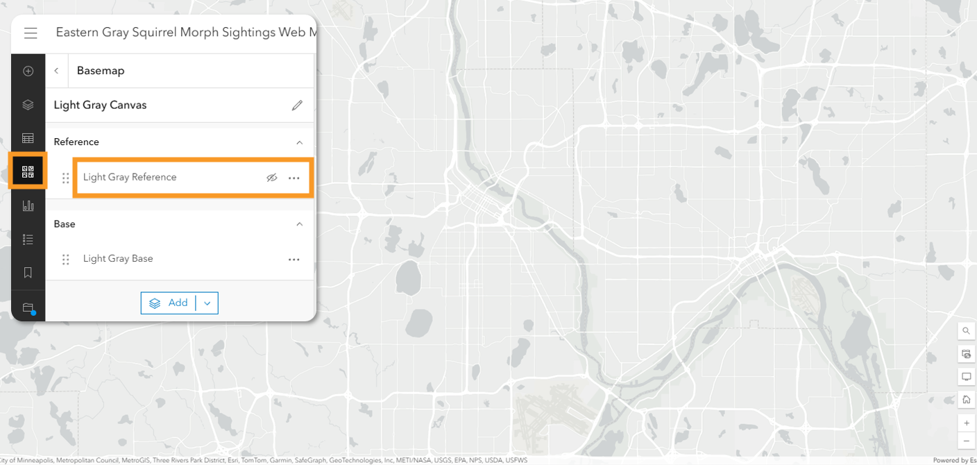

Basemap without reference
Alternatively, depending on the data and map purpose, the basemap’s reference layer can be visually hidden. This provides a more focused perspective on the data, while still providing visual context from the basemap. For the squirrel morph data context, which was zoomed to the neighborhood scale, disabling the basemap’s reference provides the best approach to highlight the squirrels on the map and thereby encourage more exploration and interaction with popups.

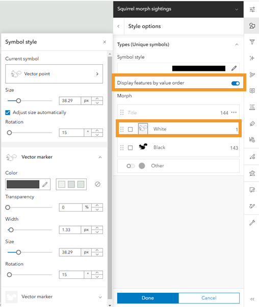

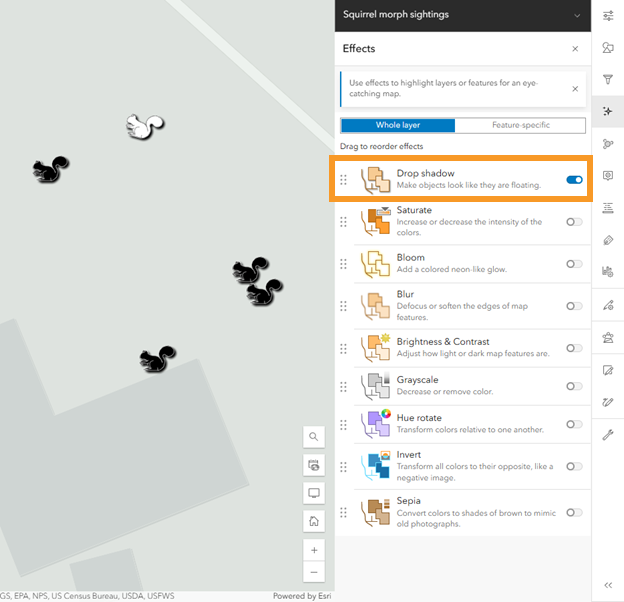

Squirrel symbology
Using a unique squirrel symbol applied to the point data helped further distinguish the squirrel morph data. Each morph type was assigned a color: black or white. By using the “Display features by value order” switch toggle found under Layer effects, prominence can be assigned to the more rare white morph squirrels on the map.
Additional data visualizations can be applied within the “Style options” panel, including point symbol rotation on white morphs and a drop shadow layer effect across all squirrel morph colors. This boosts contrast between the basemap and the squirrel morph data.

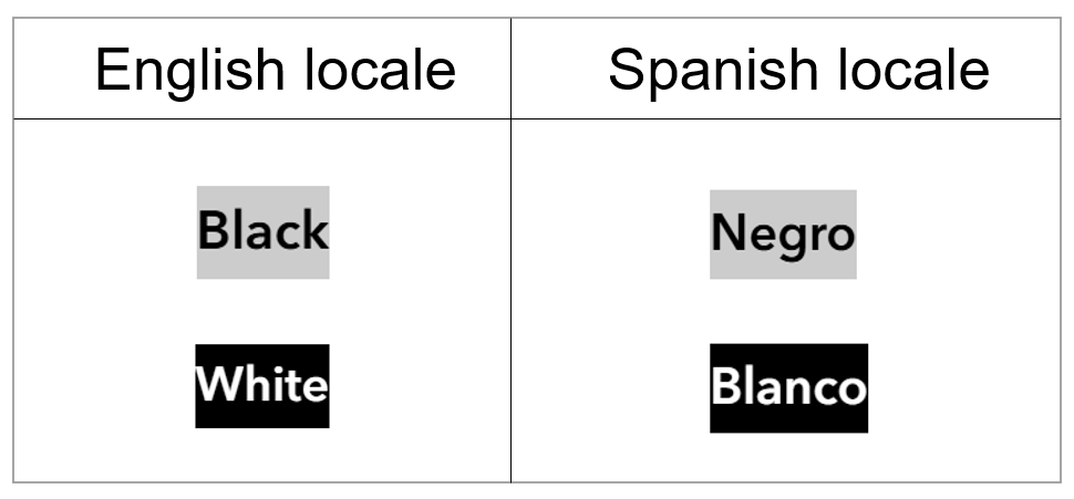

Arcade can help to dynamically generate the squirrel morph color in the popups to provide more context and contrast. This is done through a squirrelColor
variable, which stores the $feature.Morph_type
. Also, depending on the squirrelColor
value, another variable, backgroundColor
, may also be stored.
// Dynamically generate squirrel color
var squirrelColor = $feature.Morph_type;
var backgroundColor = IIF(squirrelColor == "Black", "#ccc", "#000");
In the popup’s markup, a span
element can return the styles dynamically from the backgroundColor
and squirrelColor
variables. The morphColor
variable will contain a string value, which will be dynamically updated based on the locale. For example, if the locale is set to Spanish, then the string value will represent the color in Spanish, which will be defined in a later step.
<span style="background-color:${backgroundColor};
color:${squirrelColor}">
<b>${morphColor}</b>
</span>

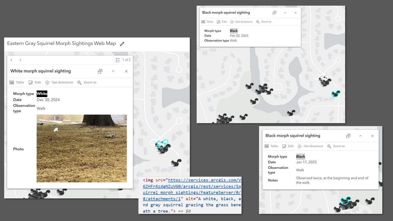

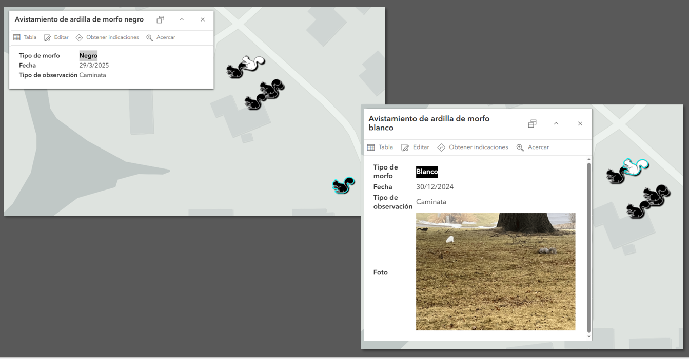

Squirrel popups by locale
White and black squirrel morph popups are now displayed dynamically depending on the locale and their attributes. When a photo is present, content is displayed in the popup with an alt attribute, and when no notes are provided, no notes are displayed in the popup.
Meanwhile, when a user has the Spanish or “es” locale set on their browser, the popup will display different content that coincides with the “es” locale, while also still displaying content dynamically when photos are provided.
