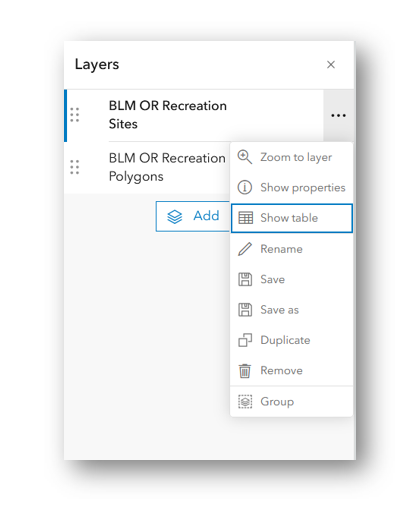

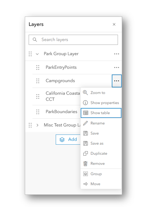

To open a table, click on a feature layer in the Layers pane, then select Show table on the layer action drop down. Table layers will automatically open as a tab when added to a web map. You can open multiple tables and freely switch between them. This makes comparing data between layers more effortless.

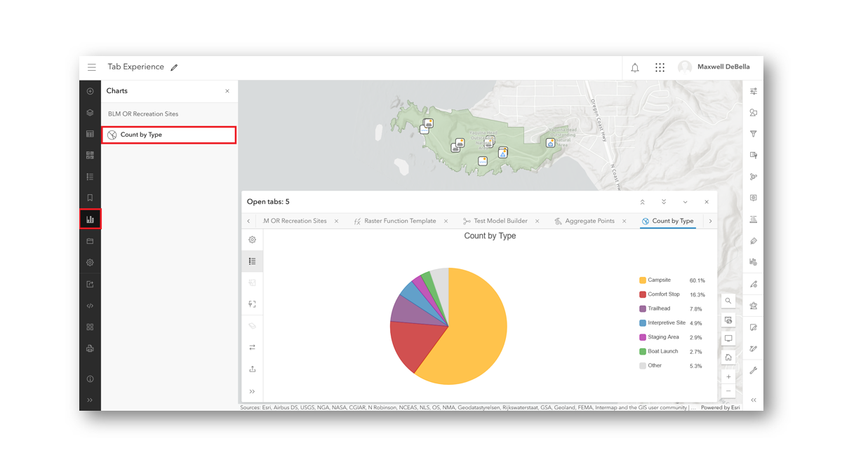

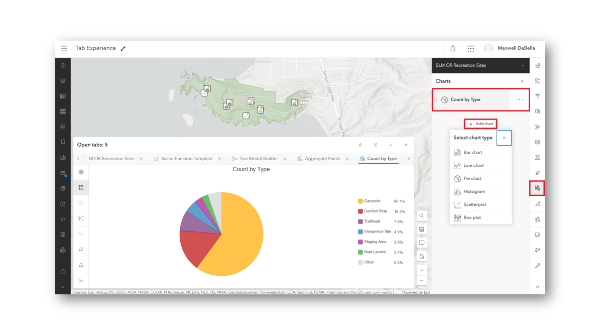

For charts, simply select a layer, then click the Charts button on the right toolbar to create a new chart. The new chart will be added as a tab. To open an existing chart, select Charts on the left toolbar and click the chart to add it as a tab. Charts can only occupy a single tab at a time. Having multiple charts open simultaneously will be available Spring 2025. Using the new tabbed experience, you are free to move between designing a chart and preforming other actions in your map.

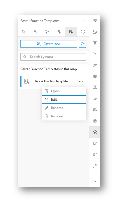

To open the Raster Function Templates, click Raster Function Templates on the Analysis pane. This will open a list of templates; click the options icon next to the desired template and then select Edit. To create a new template, click Create new. The new template will be automatically opened as a new tab. Similar to working with models, you can open multiple raster function templates as tabs. Templates can be processed in the background, allowing you to work on other tasks in your map.

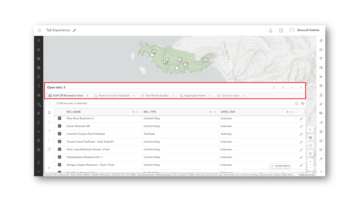

The panel that sits in the center of the map has undergone adjustments to handle the tabbed experience. There is now a header which contains a count of all the tabs opened.
To the right of the header, there are double chevrons and a single chevron. The double chevron pointing up can be used to increase the height of the panel, whereas the double chevron facing down decreases the height. There are three height options: small, medium, and large. You can completely minimize the tab interface with the single chevron facing down and restore it to its previous height with the single chevron facing up. This experience is great for alternating between viewing the map alongside your tabs, expanding your tabs to the fullest extent, and/or fully minimizing your tabs to get a bigger picture of your map.
Each tab has a unique icon denoting its type. If the number of tabs open exceeds the length of the tab header, you can cycle through tabs with the left and right chevrons. You can close individual tabs by clicking the X on the tab. To close all tabs, click the X on the center-panel’s main header. If there are any unsaved changes to a Raster Function Template and or a model you will be prompted to save, discard, or go back. Relying on a tab’s icon is useful for locating a particular tab. Closing individual tabs that are no longer needed will help to de-clutter your workspace.
