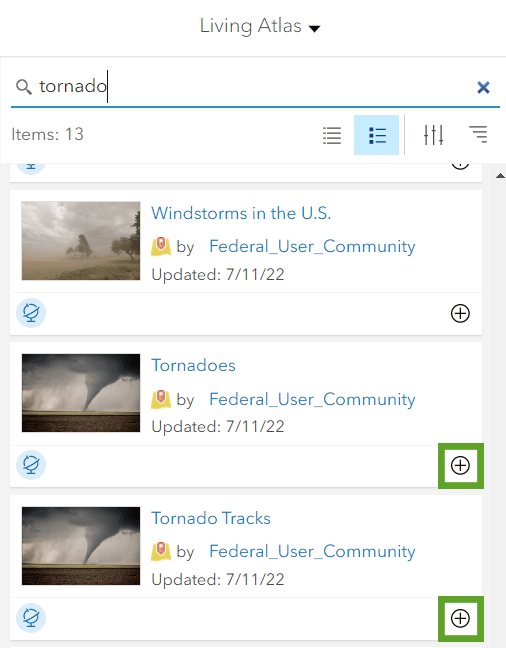

Step 3 — Enter “tornado” in search to locate matching layers from Living Atlas. Scroll down to locate the Tornadoes layer and click (+) to add it to the map. Repeat for the Tornado Tracks layer.
add layers

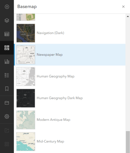

Step 4 — Change the basemap. I went with the Newspaper Map theme. Depending on how your ArcGIS Online Organization is setup, you may have different basemap options. You can still add Newspaper Map to your map from Living Atlas, as in Step 3, and select “Use as basemap” in the layer settings.
change the basemap

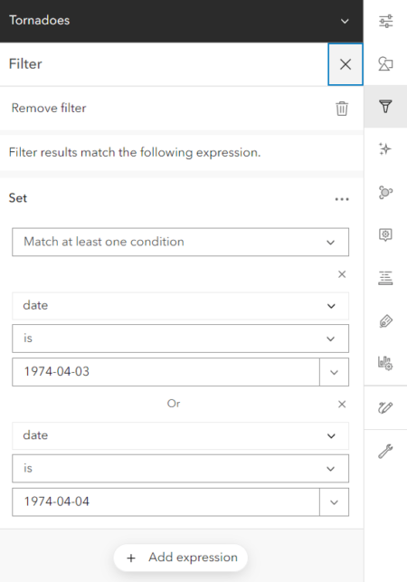

Step 5 — Click Filter in the Settings (light) toolbar on the right. Click Add expression. In the image below you’ll see that I choose the Date field an specified the two days of the outbreak, April 3rd and 4th. Click Save. Be sure to select “Match at least one condition” so the filter uses an “or” function rather than an “and”. Apply this filter to both the Tornadoes and Tornado Tracks layers.

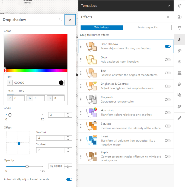

Step 6 — Click Effects in Settings toolbar (below Filter) and choose a Drop Shadow. Adjust the settings on the drop shadow (click the six dots to the left of the description). Click Save and your map is ready to share!
add a drop shadow

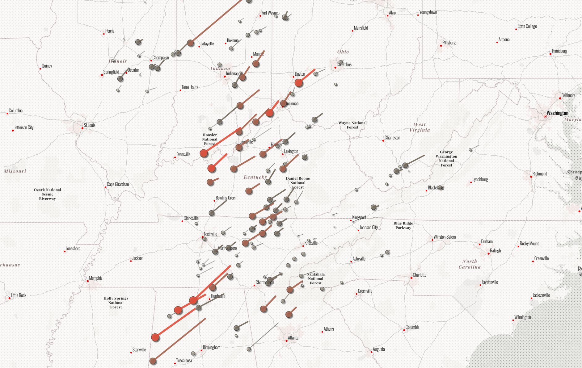

The final map.
