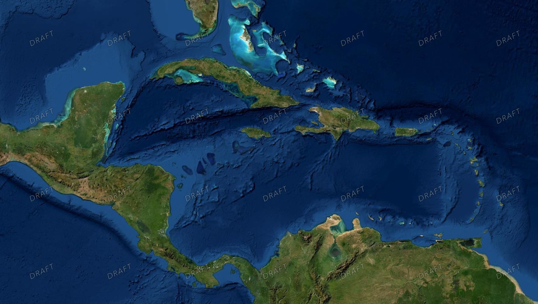

Here are some snapshots of a handful of watermark layers atop an assortment of basemaps in ArcGIS Online, to give you a sense of their appearance and utility. Like this World Imagery map that has been watermarked with draft.

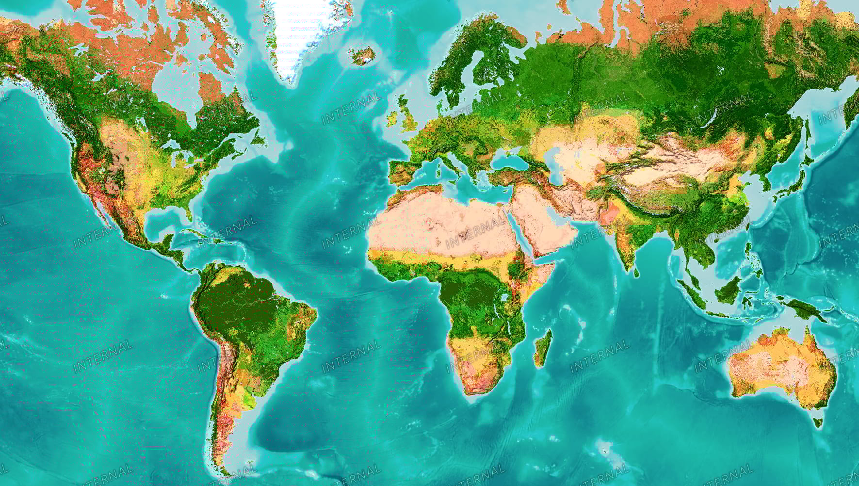

Ooooh, this vibrant map is deemed for internal eyes only.

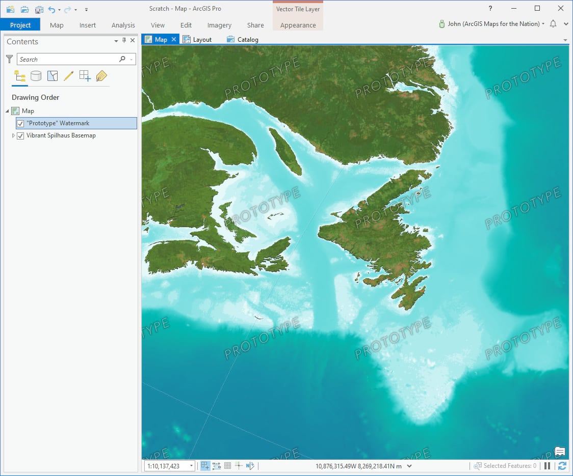

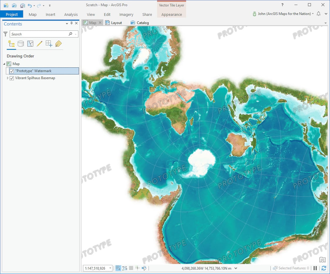

Will they work with various projections? ArcGIS Pro will happily render these watermark layers in any projection, at all scales. ArcGIS Online requires the basemap to match the watermark projection, which is Web Mercator. Here’s a look at the watermark used with an ArcGIS Pro Spilhaus map at different scales…

If you are working in ArcGIS Pro, you can just copy the URL of any of the above item details pages (the same link used for the hyperlinks, so you could just right-click and copy the link directly here), and use the Add Data > Add Data from Path option.
If you are working in ArcGIS Online, you can use the Add Layer option, then search for watermark.

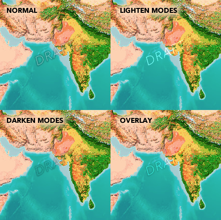

In Pro or Online, you can optionally apply a blend mode to tweak the appearance of the watermark text. They are designed to work with no blend mode (“normal”) but here are some examples of the lightening, darkening, and combination (overlay) blend modes…
